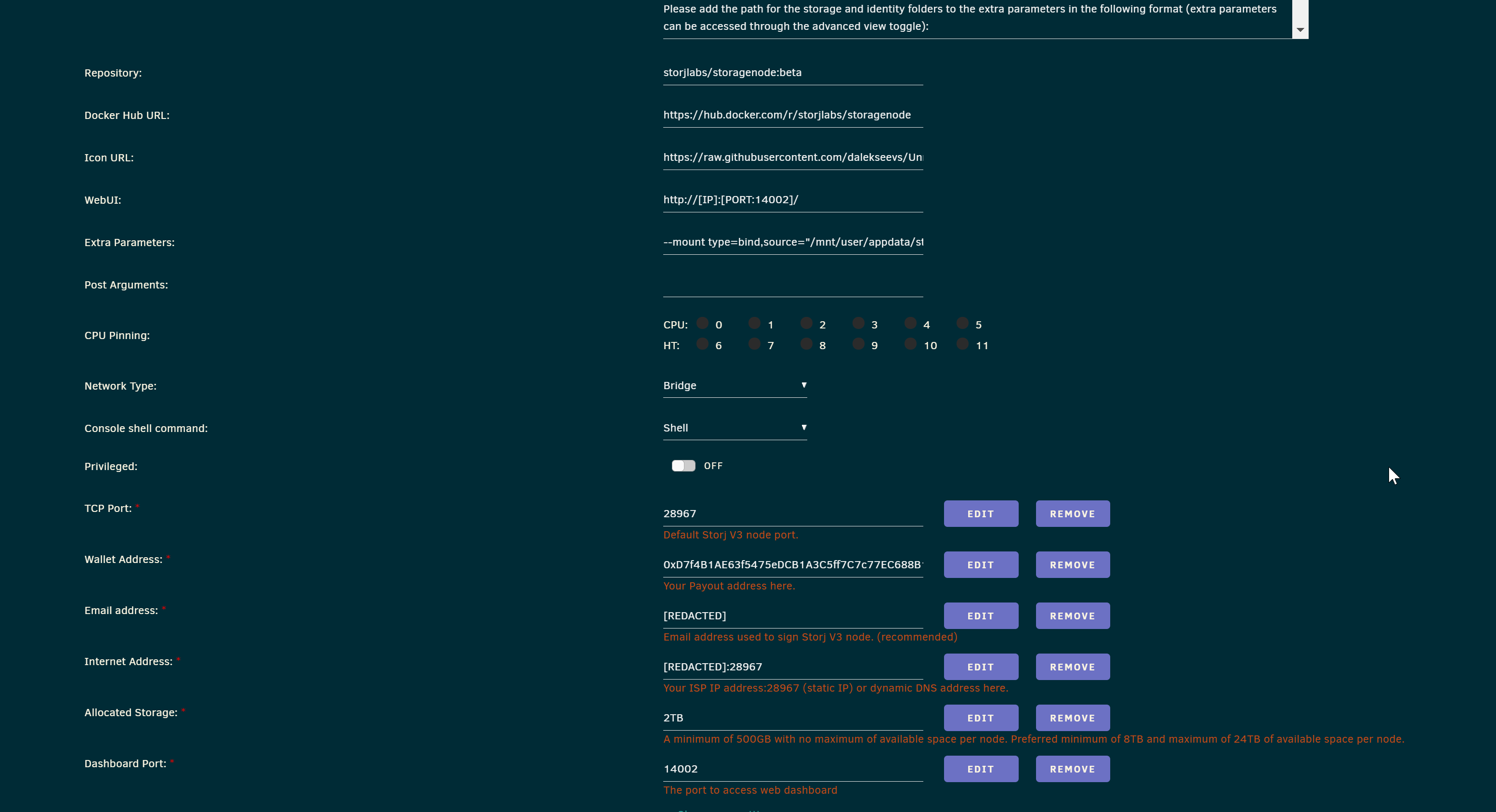

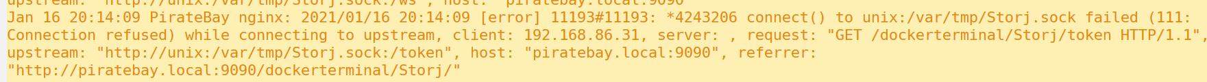

  5. Ok, I've updated my parameters as such --mount type=bind,source="/mnt/user/storj/identity",destination=/app/identity --mount type=bind,source="/mnt/user/storj/storage",destination=/app/config I confirmed I've port forwarded correctly. I'm still unable to start the container. It just immediately turns off. Is there some storj logs I should check?
  6. Hey guys! Thank you for putting this together! I'm trying to get a brand new node running. I'm having issues just getting this docker container to start though. I've created my identity and signed it via a windows machine then I moved all my identity files to /mnt/user/appdata/storj/identity/storagenode/ I updated the 'extra parameters' accordingly My data is to live in /mnt/user/storj/ I also updated the 'extra parameters' accordingly Here is the "extra parameters" I have & an image of my docker template Extra Parameters: --mount type=bind,source="/mnt/user/appdata/storj/identity/storagenode/",destination=/app/identity --mount type=bind,source="/mnt/user/storj/",destination=/app/config I'm unable to start the docker, it immediately turns off. My system logs are showing this error Is there something else I need to configure I'm missing here? Or am doing something wrong? Thank you guys for any support you can provide!

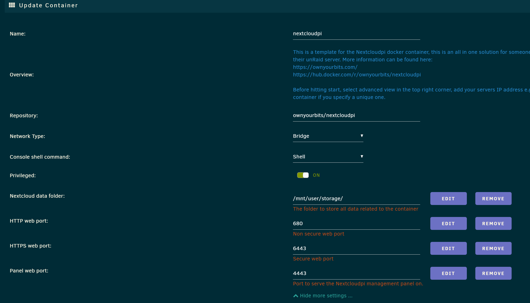

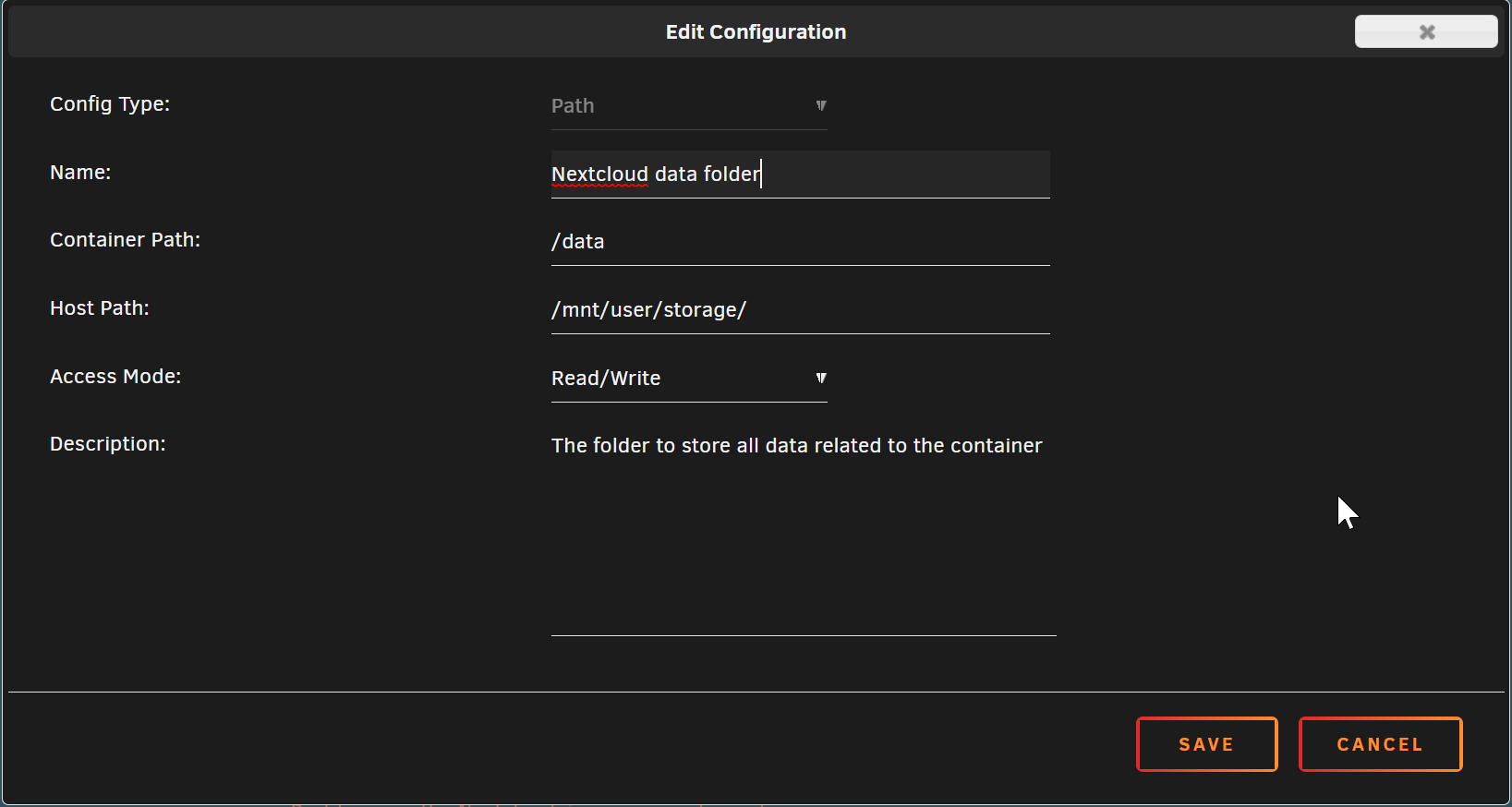

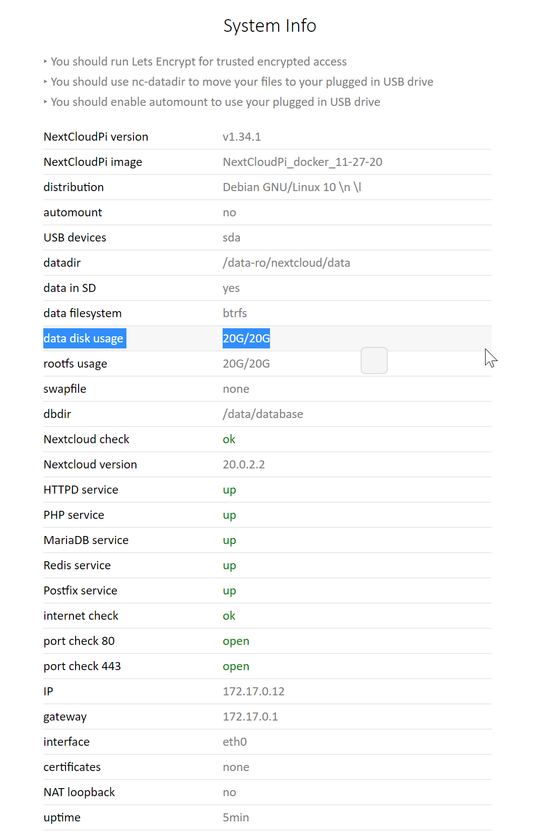

  7. I finally had time to try this, I'm a new nextcloud user so luckily I don't care about wiping everything and starting from scratch I deleted everything & reinstalled from scratch, opened the app once just to activate nextcloud stopped the docker instance & modified the config as you mentioned I know have my entire array showing up under data disk usage! Thank you!!!
  8. hmm do you have any info you could point me to for getting ncp configured correctly? I've been trying to investigate this issue but not finding much.

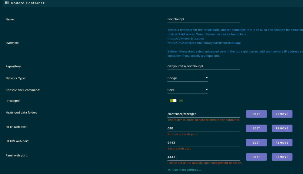

  9. I'm using Unraid version 6.8.3
  10. Here's what I have from the instance

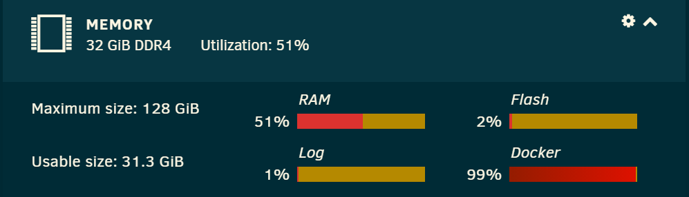

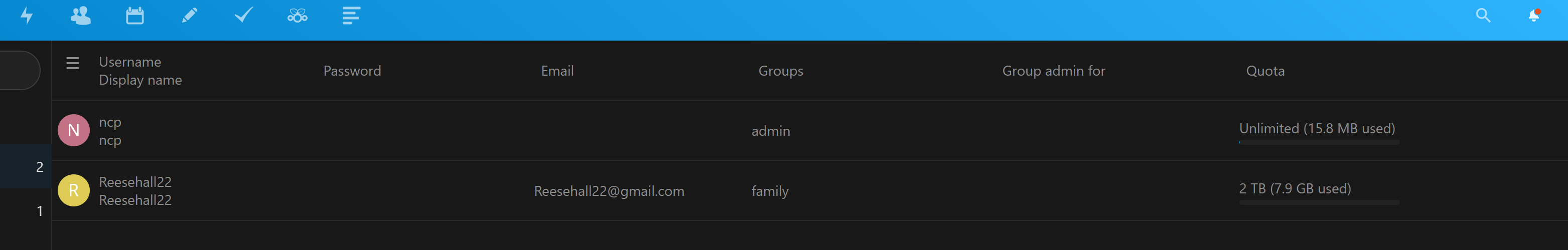

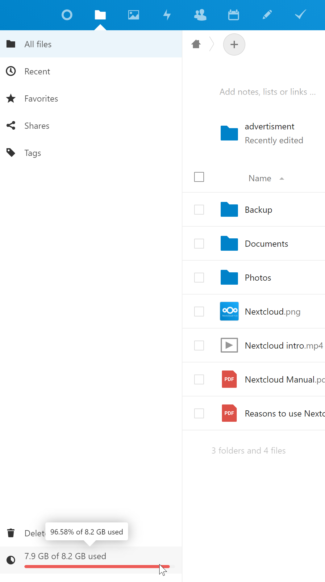

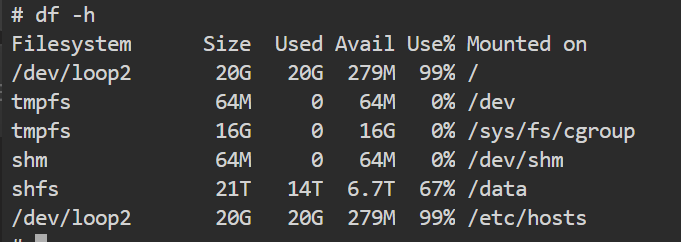

  11. Hey Dimtar, Here's what I have configured under the Nextcloud data folder
