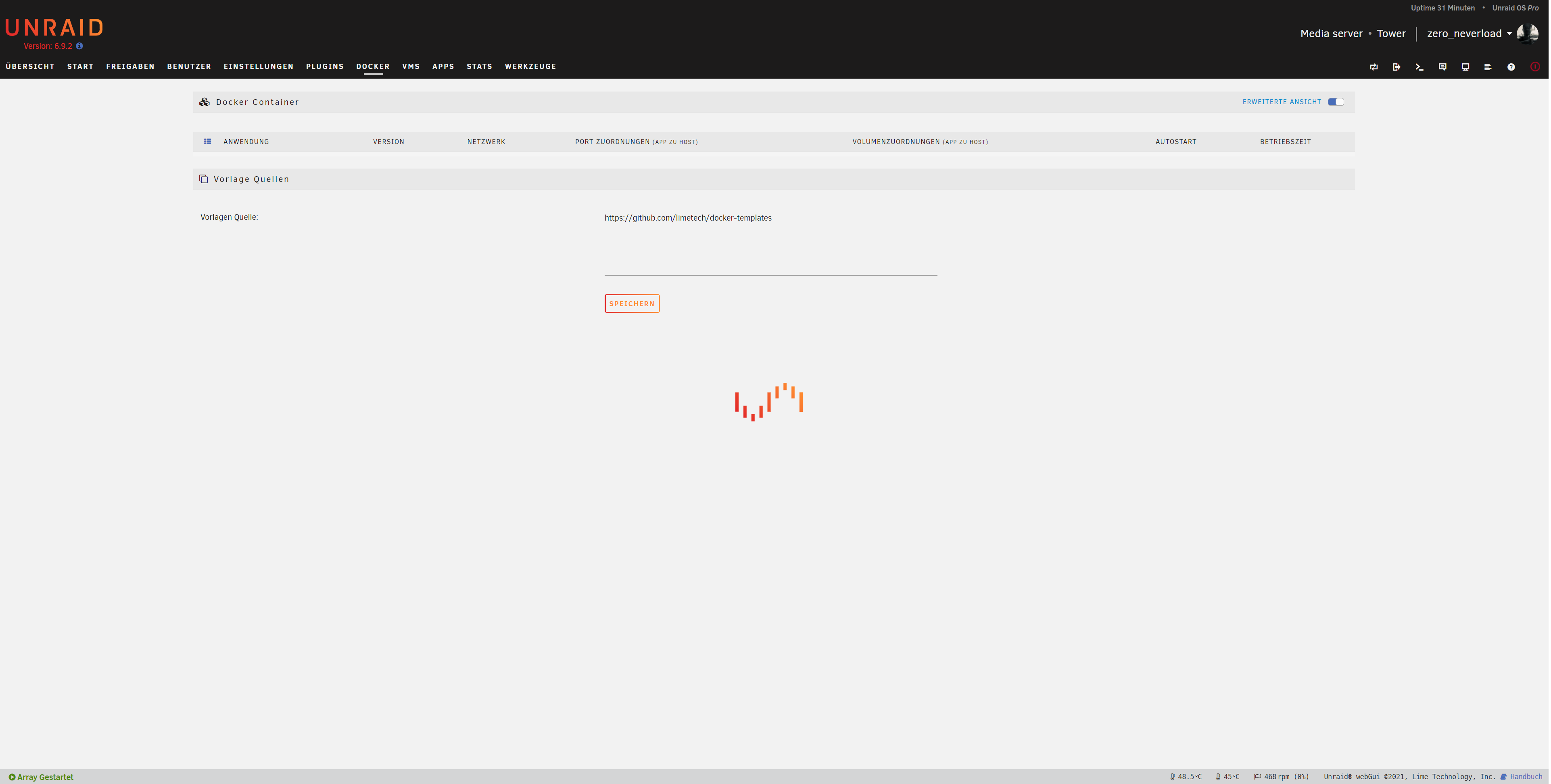

Habe jetzt alle Docker gestopt, jedoch bekomme ich im normalen modus noch immer nicht die Oberfläche aufgerufen. Nov 7 16:09:58 Tower rc.docker: Error response from daemon: Pool overlaps with other one on this address space- Kein Zugriff auf Docker Oberfläche

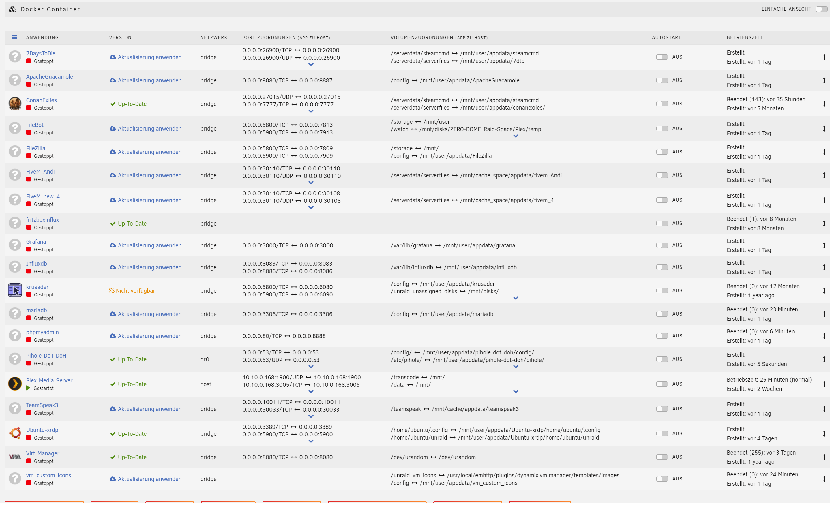

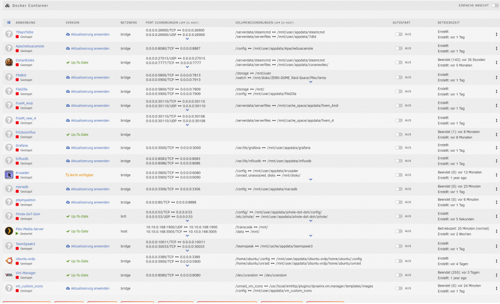

Anmerkung! root@Tower:~# docker ps CONTAINER ID IMAGE COMMAND CREATED STATUS PORTS NAMES 93ce7b2b8a09 plexinc/pms-docker "/init" 2 weeks ago Up 59 minutes (healthy) Plex-Media-Server root@Tower:~# docker ps -a CONTAINER ID IMAGE COMMAND CREATED STATUS PORTS NAMES 625007e56a1f jlesage/filebot "/init" 17 minutes ago Created FileBot 8b6fb3580e79 testdasi/pihole-dot-doh:latest "/s6-init" 35 minutes ago Created Pihole-DoT-DoH 6a0838d131f8 spaceinvaderone/vm_custom_icons "/bin/sh -c 'bash ./…" 27 hours ago Exited (0) About an hour ago vm_custom_icons 71651a98a432 ich777/teamspeak "/opt/scripts/start.…" 27 hours ago Created TeamSpeak3 5e08525870ee phpmyadmin/phpmyadmin "/docker-entrypoint.…" 27 hours ago Exited (0) 41 minutes ago phpmyadmin 974d6fd7a5f0 linuxserver/mariadb "/init" 27 hours ago Exited (0) 58 minutes ago mariadb ef418fc9506b influxdb:latest "/entrypoint.sh infl…" 27 hours ago Created Influxdb abd538557b47 grafana/grafana "/run.sh" 27 hours ago Created Grafana 7723f7e6348a ich777/fivemserver "/opt/scripts/start.…" 27 hours ago Created FiveM_new_4 27cae86f3445 ich777/fivemserver "/opt/scripts/start.…" 27 hours ago Created FiveM_Andi 86fb21283bc5 jlesage/filezilla "/init" 27 hours ago Created FileZilla 4330657a81ae jasonbean/guacamole "/etc/firstrun/first…" 27 hours ago Created ApacheGuacamole 799a53c9d121 ich777/steamcmd:7dtd "/opt/scripts/start.…" 27 hours ago Created 7DaysToDie c0e67d10fb90 snoopy86/desktop-dockers "/sbin/my_init" 4 days ago Created Ubuntu-xrdp 93ce7b2b8a09 plexinc/pms-docker "/init" 2 weeks ago Up About an hour (healthy) Plex-Media-Server 055d0d175ad8 ich777/steamcmd:conanexiles "/opt/scripts/start.…" 5 months ago Exited (143) 35 hours ago ConanExiles a85fa36b4915 giantmolecularcloud/fritzboxinflux "python3 FritzBox_in…" 8 months ago Exited (1) 8 months ago fritzboxinflux b5dbaabe49c3 fanningert/docker-virtmanager "/usr/bin/supervisor…" 12 months ago Exited (255) 3 days ago 0.0.0.0:8080->8080/tcp Virt-Manager e0c52ba0250d djaydev/krusader "/init" 13 months ago Exited (0) 12 months ago krusader root@Tower:~#- Kein Zugriff auf Docker Oberfläche

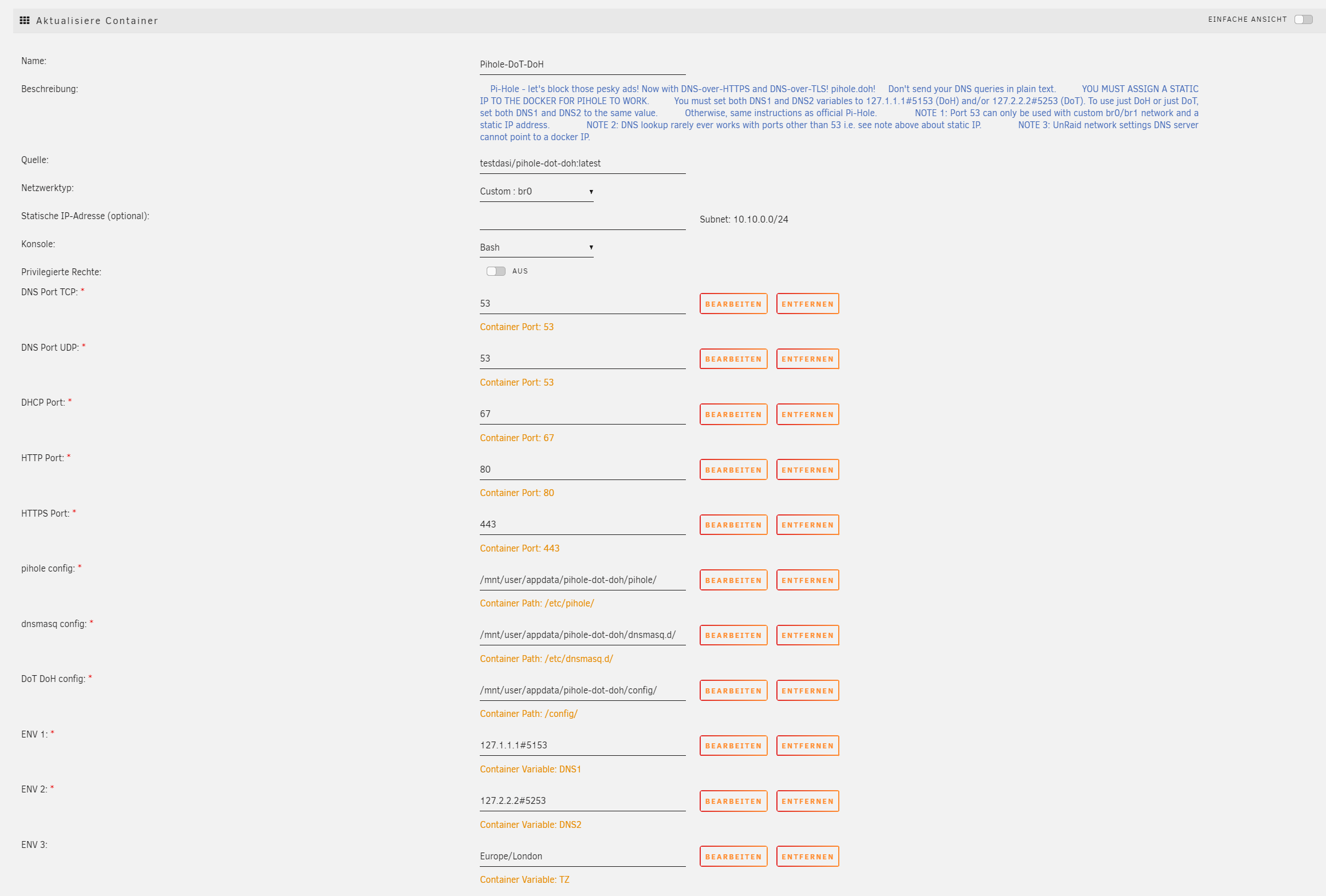

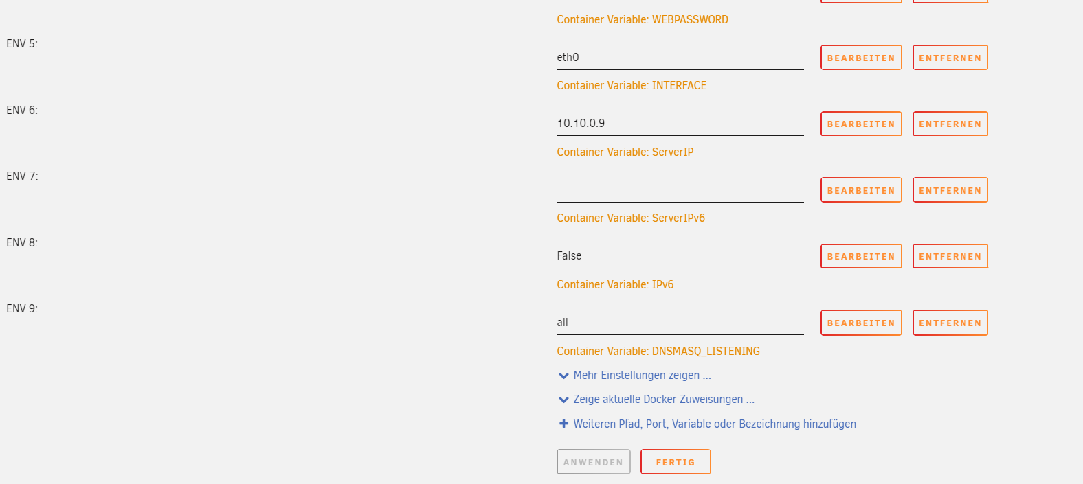

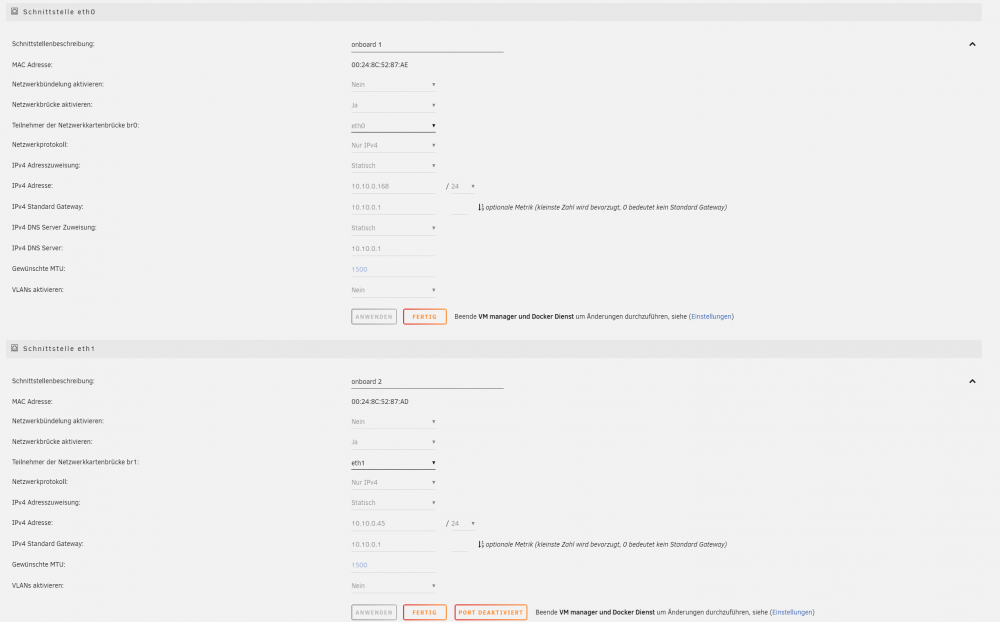

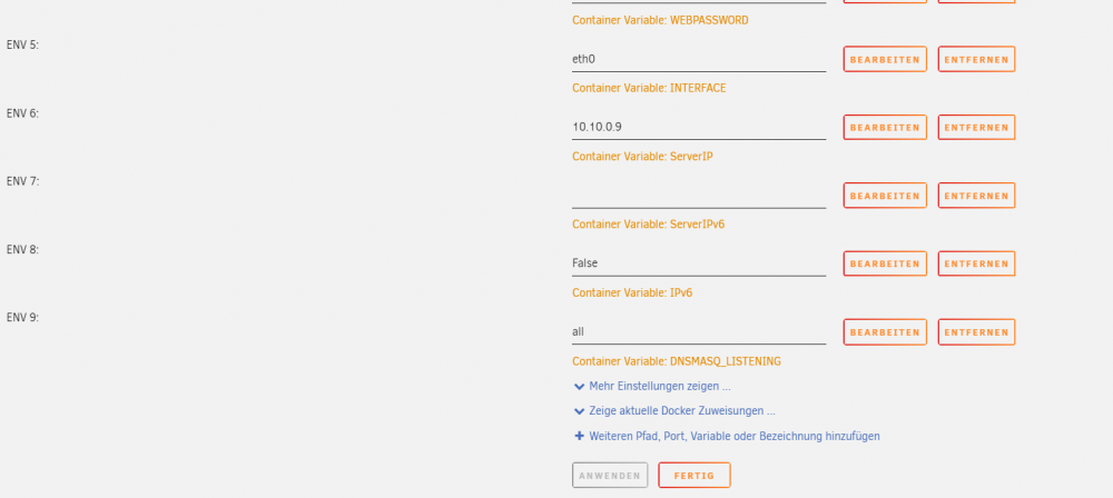

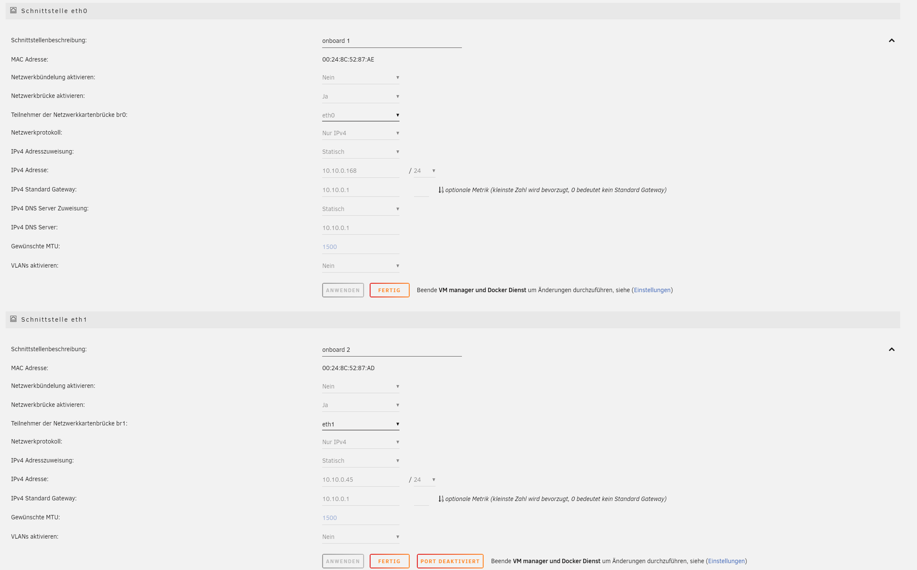

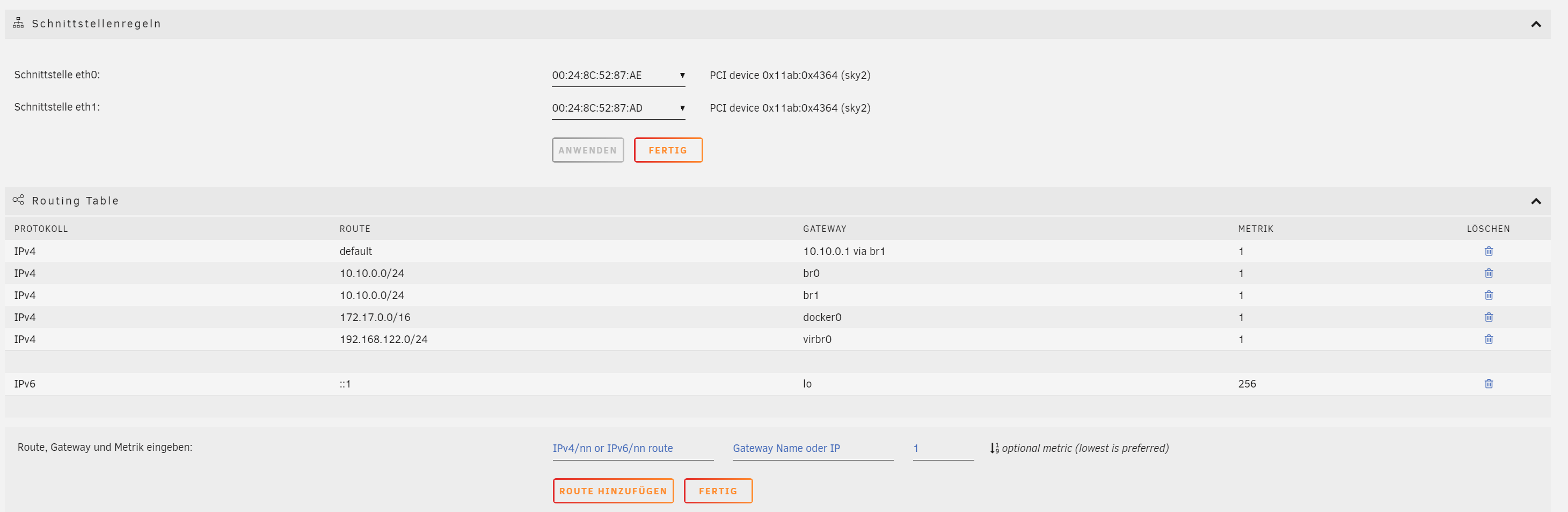

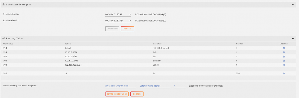

Also irgenwie verstehe ich das ganze nicht.. Ich habe deinem Tipp gefolgt und ich konnte dann nach langem warten die Dockeroberfläche erreichen. Die einzige Docker welche mit dem br0 eingestellt ist, ist meine Pi-Hole welche jedoch mit der IP Adresse 10.10.0.9 eingestellt ist. diese wird auch zu 100 Prozent nur einmal im netz verwendet. Ich habe sichergestellt das meine VMs nicht diese IP verwenden. Auch im standalone modus (Server und mein PC hängen an einem gesondertem Switch) braucht die Dockeroberfläche ewig, bis sich die seite vollständig aufbaut. Das alles kommt mir komisch vor. Hänge ich den Server wieder normal ans netz, wird die Oberfläche nicht mehr aufgebaut. Die IP Adressen meines Server 10.10.0.45 und 10.10.0.168 sind definitv nicht doppelt vergeben. Aktuell sind alle Container ausser Plex aus. bin noch ratloser als vorher..... Nov 7 15:04:45 Tower rc.docker: Error response from daemon: Pool overlaps with other one on this address space Nov 7 15:16:34 Tower nginx: 2021/11/07 15:16:34 [error] 11744#11744: *3054 upstream timed out (110: Connection timed out) while reading response header from upstream, client: 10.10.0.13, server: , request: "GET /plugins/dynamix.docker.manager/include/DockerContainers.php HTTP/1.1", upstream: "fastcgi://unix:/var/run/php5-fpm.sock", host: "10.10.0.45", referrer: "http://10.10.0.45/Docker" Nov 7 15:22:05 Tower kernel: CIFS: VFS: \\10.10.0.46 Error -32 sending data on socket to server Nov 7 15:22:05 Tower kernel: traps: lsof[20923] general protection fault ip:1480d51bda9e sp:c9a701492045410a error:0 in libc-2.30.so[1480d519e000+16b000] Nov 7 15:50:35 Tower nginx: 2021/11/07 15:50:35 [error] 11744#11744: *8386 upstream timed out (110: Connection timed out) while reading response header from upstream, client: 10.10.0.13, server: , request: "GET /plugins/dynamix.docker.manager/include/DockerContainers.php HTTP/1.1", upstream: "fastcgi://unix:/var/run/php5-fpm.sock", host: "10.10.0.168", referrer: "http://10.10.0.168/Docker" Was mir noch aufgefallen ist, das mein Zoneminder Docker weg ist, bzw. diese mir nicht mehr angezeigt wird. Es könnte sein, das dort die BR0 verwendet wurde, nur wie finde ich das jetzt raus, da ich sie ja nicht mehr sehe? Ist die Docker vermutlich noch vorhanden und läuft sogar, auch wenn ich sie nicht sehe in der Oberfläche?- Kein Zugriff auf Docker Oberfläche

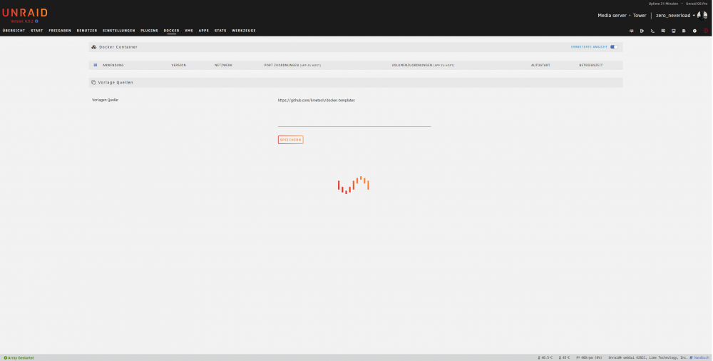

Hallo liebe Community, nach einem Update einiger Dockercontainer habe ich aktuell keinen Zugriff mehr auf den Dockertab im Unraid. Es wird lediglich der Unraid Ladebalken angezeigt. Neustart hat nichts gebracht, auch das Neustarten des Dockerdienstes nichts. Die vorhandenen Container scheinen jedoch noch zu laufen, da ich zugriff auf die Dienste habe. (pi-Hole, Gameserver, etc) Hat jemand eine Idee? Vielen Dank vorab. Nachtrag: das Plugin CA Backup / Restore Appdata lässt sich leider auch nicht mehr öffnen und zeigt eine weisse Seite an.- [SOLVED] Frage zum Festplattenaustausch
