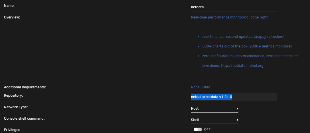

  5. i had the same issue. after the latest update netdata didnt work. everyone who has the same issue just go back go the version before. netdata/netdata:v1.31.0

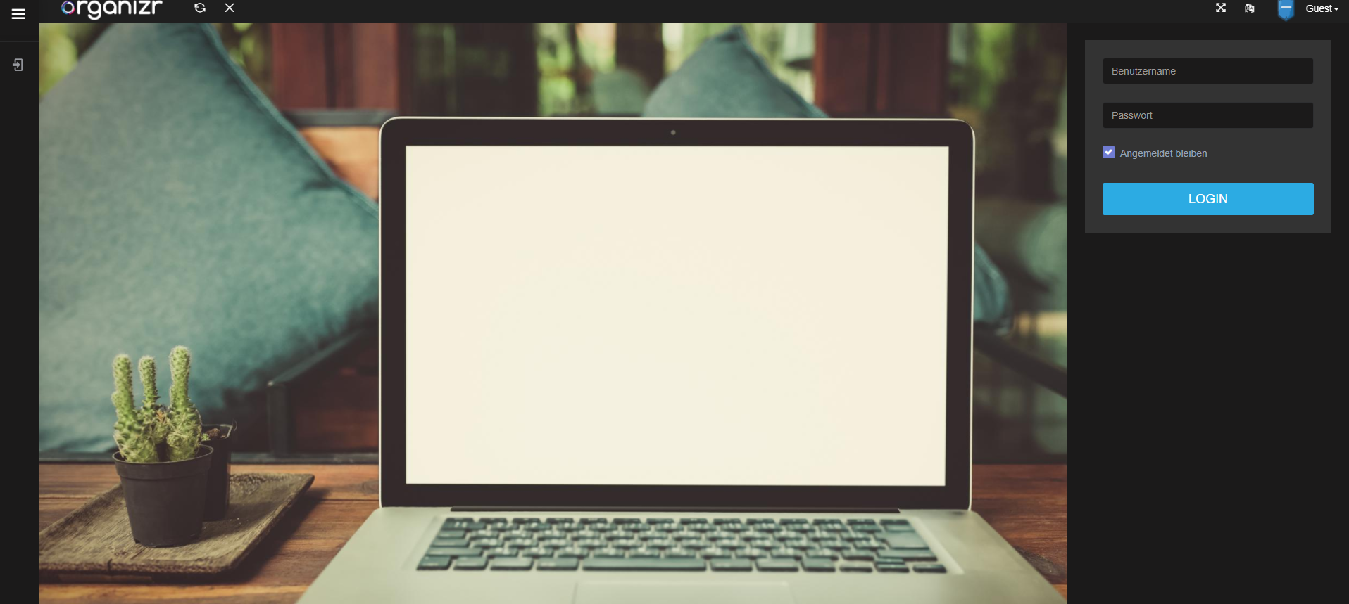

  16. hey iยดve installed this docker with the forest from the appstore. the setup works without a flaw. but when i try to connect it tells me that the server running a different version. (and the ping is kinda high for local???) the docker is up to date. (yes i know its turned off right now)
  17. 6.10 Rc1 and no content as well. and yes i have eth0 selected and the daemon is running.
  18. thx. that was the problem
  19. ## Version 2021/05/18 # make sure that your dns has a cname set for organizr server { listen 443 ssl; listen [::]:443 ssl; server_name organizr.*; include /config/nginx/ssl.conf; client_max_body_size 0; # enable for ldap auth, fill in ldap details in ldap.conf #include /config/nginx/ldap.conf; # enable for Authelia #include /config/nginx/authelia-server.conf; location / { # enable the next two lines for http auth #auth_basic "Restricted"; #auth_basic_user_file /config/nginx/.htpasswd; # enable the next two lines for ldap auth #auth_request /auth; #error_page 401 =200 /ldaplogin; # enable for Authelia #include /config/nginx/authelia-location.conf; auth_request /auth-0; include /config/nginx/proxy.conf; include /config/nginx/resolver.conf; set $upstream_app organizr; set $upstream_port 80; set $upstream_proto http; proxy_pass $upstream_proto://$upstream_app:$upstream_port; } # Optional redirect server errors to organizr error pages #error_page 400 402 403 404 405 408 500 502 503 504 $scheme://$host/?error=$status; }
  20. because i had an issue with a later version of it.. (cant remember what it was) i didnt know there are error logs of nginx ^^ 2021/07/21 23:25:21 [error] 679#679: *1235 auth request unexpected status: 404 while sending to client, client: 162.158.92.159, server: organizr.*, request: "GET /favicon.ico HTTP/1.1", host: "organizr.mydomain.de", referrer: "https://organizr.mydomain.de/" but im not really sure what this means ๐Ÿ˜•

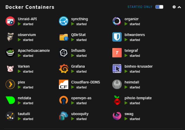

  21. ohhhhh. i missunderstood. i thought you meant i am actually using organizer.DOMAIN.com.... and not my own domain organizer is up to date. swag is almost up to date. im staying on that version because i had issues with a later version. and these are all my docker container and i dont think unraid has a nginx installed nativly that interferes with only one docker. do you thing its the swag version that is causing the problem?
