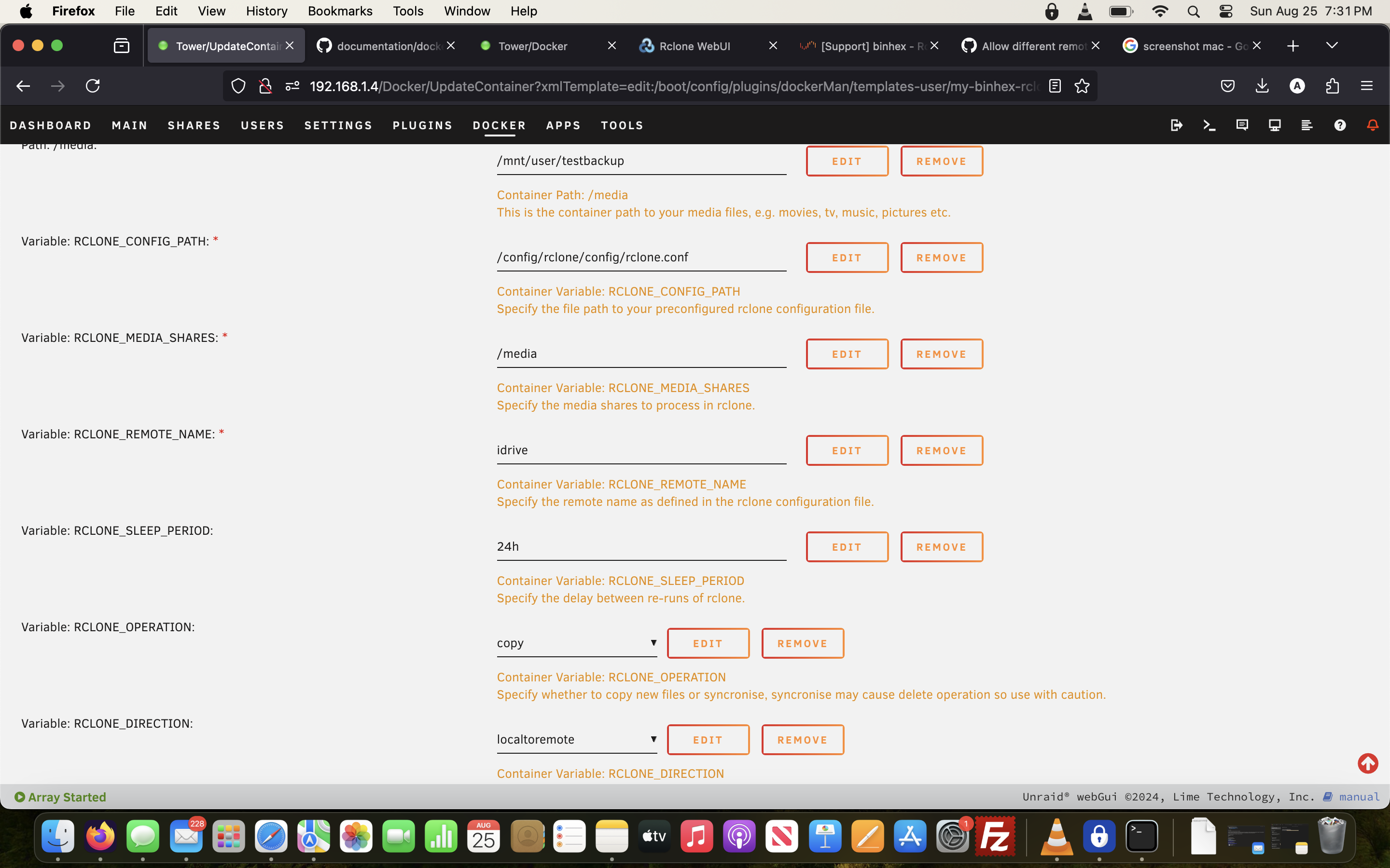

  3. Edit: I think I bumbled into a fix, reading through the issue page. (Config issue with an authentication problem.) So I understand why the fix is working - could someone explain the variable mapping below? Path: /media: (Container to server share location?) Variable: RCLONE_MEDIA_SHARES: (Container to cloud host directory?) -------------------------- Hey folks: Hoping someone can help me out. Been messing with this for a few hours and getting frustrated. Trying to backup an URAID share (testbackup) to Idrive. First I was getting this: 2024-08-25 18:01:58,166 DEBG 'start-script' stdout output: [warn] Media share '/testbackup' does not exist, skipping [info] rclone finished, sleeping 24h before re-running... I figured I had the RCLONE_MEDIA_SHARE variable wrong, so I tried a couple changes. Now I receive: 2024-08-25 19:16:46,690 DEBG 'start-script' stdout output: { "error": "AccessDenied: Access Denied\n\tstatus code: 403, request id: XXXXXXX, host id: XXXXX=", "input": { "dstFs": "idrive:media", "srcFs": "/media" }, "path": "sync/copy", "status": 500 Idrive uses buckets - if that matters. Did I screw around too much and DDoS myself?
