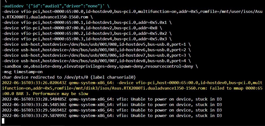

  3. I'm at wits end guys, I really am. I've googled everything and tried everything and nothing works :/. Everything is running fine on 6.9 Upgraded to 6.10.3 and nothing worked Discovered I need a motherboard bios update, so updated to ASUS latest bios Put append pcie_acs_override=multifunction video=efifb:off initrd=/bzroot in syslinux.cfg After I start VM primary GPU shuts down after about a minute with "Cannot power on device, stuck in D3" in the error log Tried vbios from Techpowerup with NVIDIA header removed I would assume this problem is related to Unraids update or bios update because everything was fine prior to updating Unraid and my bios. It could be coincidental that the GPU just happened to die, but I don't think so because it will display the bios screen for hours without shutting down?. Additionally, the GPU in the bottom most slot is code 43 and nothing I do fixes that either, I don't know if that's related somehow? I've tried rolling back bios and Unraid without any luck. Taking into consideration that it's shutting down, could this be due to the ASPM setting bios being incorrectly set? Should it be disabled, bios controlled or OS controlled?. I'd try Q35 instead of i440fx only I don't know how to configure the bus/slots Please help, I need this PC up and running for University. I don't want to RMA the GPU because that takes weeks and I suspect that Unraid or BIOS is the culprit. RMAing is a big job because it invloves dismantling a cooling loop, replacing the air cooler theeen send it back. Peter
  4. I've had the exact same problem for 2 months now. Unraid 6.10 wouldn't boot, a BIOS update fixed that, but that's when all my GPU problems started. Second GPU became the primary GPU. I was able to get a VM to start and give video output on the primary GPU, but would stop after a minute and the VM log would say "could not power on, device stuck in D3". I think I have fixed it. In the BIOS menu and APM Advanced Power Management was set to disabled. I suspected that the GPU was turning off for some reason, but with APM disabled I assumed it wasn't due to APM powering it down. After trying everything else I randomly tried enabling APM and now my primary GPU outputs the BIOS and boot screen. So I think setting APM to enable was the fix. Just gotta redo my cooling loop to be 100% sure. It's counter intuitive, because you'd think that the default state of APM would be to leave everything powered on?

  6. I've spent three weeks trying to solve this. Update to 6.10.3 and wouldn't boot. Forum posts from a multitude of people state that a bios update was a solution Updated to latest bios, Unraid now boots, but bios screen is outputing on GPU 2, GPU 3 says "Unable to power on,stuck in D3" Rolled back to Unraid 6.9.2 and rolled back to an older bios. GPU 2 & 3 now work, GPU 1 isn't the primary GPU anymore and it works for about 10 seconds then shuts down after windows loads. However, it doesn't have any problem displaying the windows repair menu for 10 minutes. I don't know if this is a bios problem, or driver problem. All the problems started with the bios update suggesting a bios problem. However, GPU 1 is working normally until windows loads suggests a driver issue? Why isn't GPU 1 the primary GPU and why is it powering down? UPDATE: The BIOS update included the addition of APM Advanced Power Management. The primary GPU would not be picked up as primary GPU and would shut down after two minutes and give a 'could not power on, stuck in D3' error which led me to believe it could be the power saving feature powering down the primary GPU. So I made sure APM was set to disabled, but it didn't fix the problem. I was about to pull the GPU out and send it back under warranty, as a last hail Mary I set APM to enable. F*ck me, everything is working!?. WTF??? It doesn't make sense?. You'd think that setting APM to disable would leave the GPU on all the time by default?.

  8. Hi Guys, Has anyone passed through the USB controller with all the RGB control on it and booted from a USB PCIE card?
  9. Hi Guys, Tried to boot any of my 3 VMs I would get "VFIO: UNABLE TO POWER ON DEVICE, STUCK IN D3" in the VM log. Read on google that a bios update is the solution. Updated the bios and VMs 1 & 2 boot but I still get "unable to power on stuck in D3" error. So I'm close. However, I just realised that when I boot my server the bios splash logo is appearing on monitor 2 which means my server is treating gpu i2 as the main gpu. Furthermore, the gpu pcie speeds are x8 x16 and x8. I think Unraid my have gpu 3 and not releasing it? UPDATE: The BIOS update included the addition of APM Advanced Power Management. The primary GPU would not be picked up as primary GPU and would shut down after two minutes and give a 'could not power on, stuck in D3' error which led me to believe it could be the power saving feature powering down the primary GPU. So I made sure APM was set to disabled, but it didn't fix the problem. I was about to pull the GPU out and send it back under warranty, as a last hail Mary I set APM to enable. F*ck me, everything is working!?. WTF??? It doesn't make sense?. You'd think that setting APM to disable would leave the GPU on all the time by default?. tower-diagnostics-20220619-2010.zip
  10. UPDATE: I searched google using "vfio unable to power on, stuck in D3" and there are numerous posts on numerous virt forums with the same problem that are all solved with a bios update. Now, I can't see how an upgrade from Unraid 6.9.2 to 6.10.3 can change something that would require a motherboard bios update. In the outback in Australia we have a saying "If it ain't broke, don't try and fix it". So I was very reluctant to touch my bios because, even though a lot of people have solved the problem with a bios update, I really couldn't see the connection or as a solution. Plus, a bios update has the potential to create more problems, on top of the problems I already have. Updated the motherboard bios and now Unraid boots properly (sometimes it would not detect and boot from USB) and faster. In the past it would search all 3 nvme and 6 sata drives for a boot record before going to the Unraid USB, now it just goes straight the Unraid USB. Boots nearly as fast as a windows 10 on a nvme drive (I haven't enabled fast boot yet) . VM1 works. VM2 boot into wrong resolution with a code 43 which was resolved with a driver update. VM3 is still failing to power on D3. Still investigating, but definitely making progress
  11. Jumped the gun. VM 1 is working. VM 2 displays a screen but freezes and VM 3 unable to power on stuck in D3. I'm ready to give up. I'm at a loss?
  12. Resolved by editing syslinux as shown HERE
  13. Found THIS thread relating to the "failing to mmap" but I don't understand it or the msi stuff?
