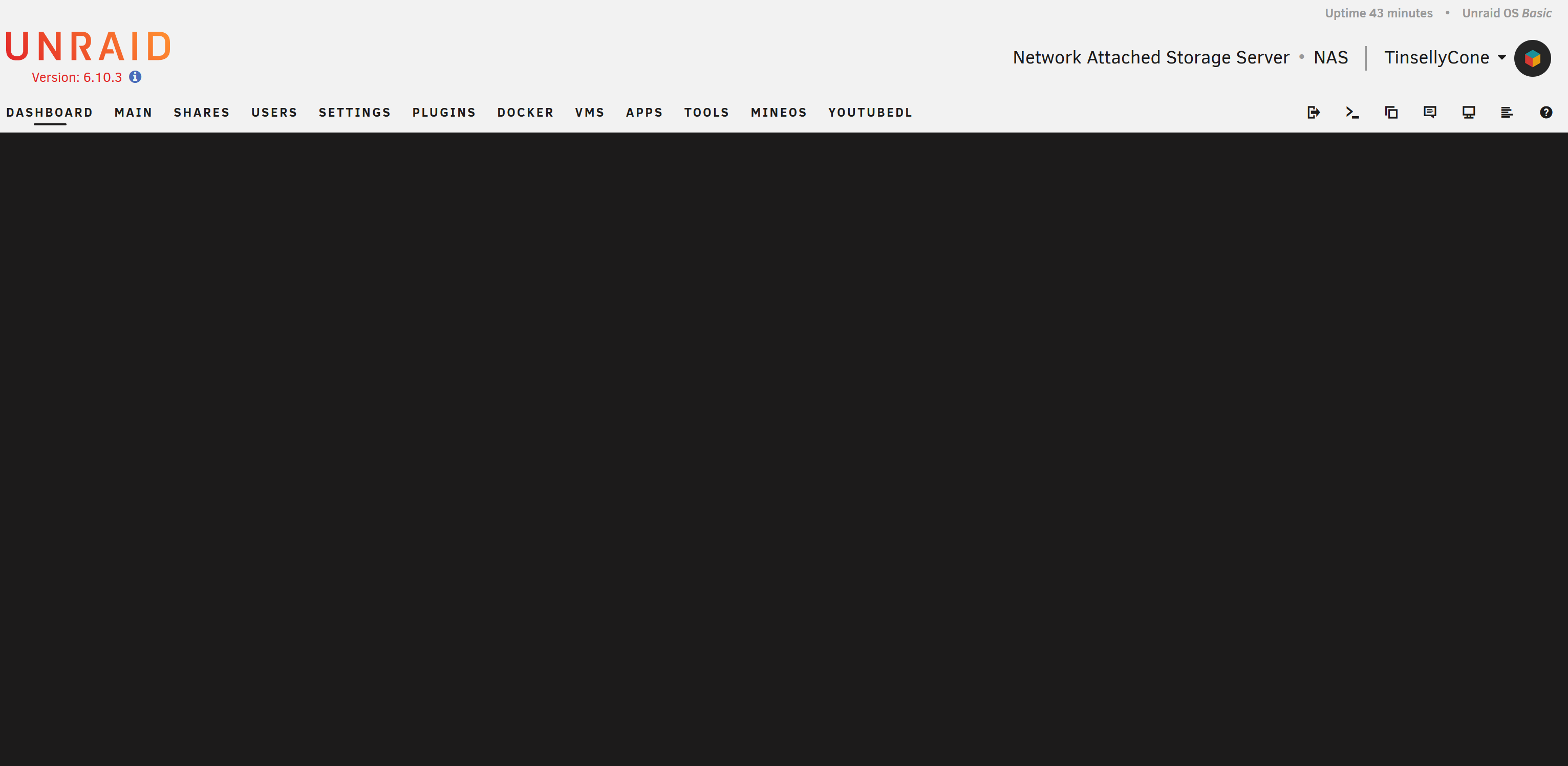

  3. I think I fixed it by removing the Custom Tabs plg and folder from the USB drive but I will update this and include diagnostics if the issue returns
  4. As stated in the title, I am having an issue where the Unraid WebUI will load, but nothing will show apart from the top bar. I've been having this issue for a while now and I cannot seem to find the cause of it. This issue resolves itself temporarily after a reboot, but returns soon after. I have only 3 plugins installed: Community Apps, File Manager, and My Server. As you can see, I did at one point use Custom Tabs, but it doesn't appear under the plugins tab. It doesn't seem to be deleted because the tabs are still there. I'm not sure if that plugin could be the issue or not. If that is the issue, how do I delete that? I am still able to use the WebUI for a bit after a reboot so I can delete it from there if possible.
