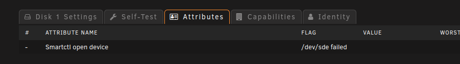

  10. I just tried running a sort self-test and it stopped. Now the attributes page just says this
  11. Crashed again this morning, this time it took down Disk 1. Is there information somewhere that can tell me why the disk was disabled? It's the second time this has happened to that disk since I replaced it. I tried running an extended self-test, but it stops before completing without errors birdskeep-diagnostics-20241023-0900.zip
