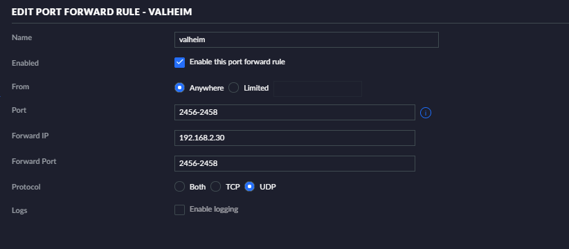

  18. the page looks same, but yours is from mobile phone right? mine is from pc. you only need 1 rule, you can set ports "from-to" so you have all needed ports in one rule. and you have to wait until your usg or what ever has provisioned until the port forwarding is working, and also it take some time after the first start of the server. and if you not have changed the ports in the docker, you need to connect to port 2457 and not 2456 (my fault on my first try xD)
  19. for guys which are using unifi these are my settings and they are working ->
