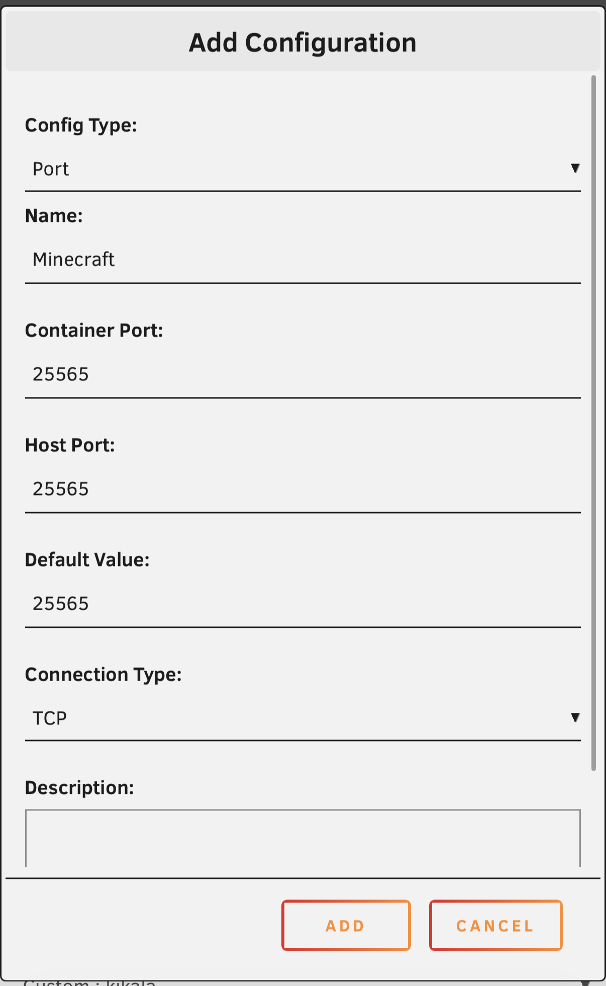

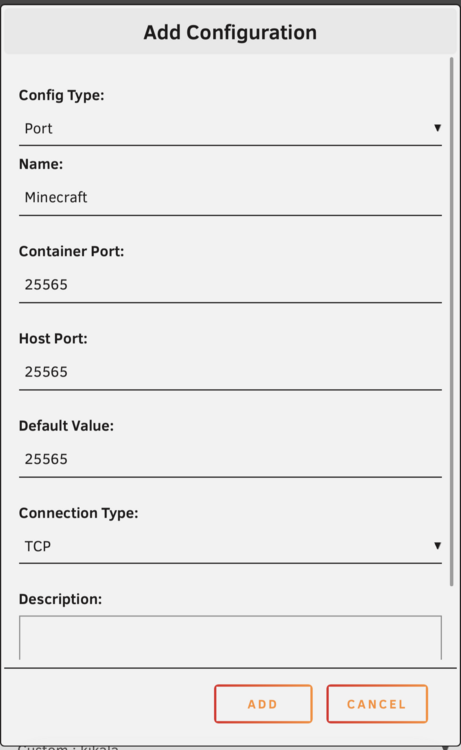

  6. You’re just missing the Minecraft port :) At the bottom of that page click on the button like “Add another Path, Port, …” and then set it to Port, with value 25565 in host, container, and default. Use TCP as the protocol. Like this:
  7. It might be a port issue, can you show me your configuration for the container? Block out the password and license of course.

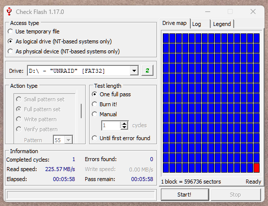

  12. I reseated all my various peripherals (SATA ports, internal USB header, M.2 slots, etc.) and recreated my Docker image. I've had no problems since then! I guess it was a loose connection. (I am still using the same USB drive as before, I guess there wasn't really any problems with it.) Thanks for the help.
  13. Thank you @JorgeB, I'll try this out. Also, I believe my USB drive is a lemon. I ran Check Flash on it and it had a read error: I'm going to run a more thorough test to be sure. I probably need to find a new drive though. ---- Update: I ran more tests and didn't run into the error again. I am leaning towards that being a fluke. I'm going to try running Unraid again and see if the problem persists after a reboot. I did find a somewhat loose M.2 SATA adapter in my case which could have been part of the problem.
