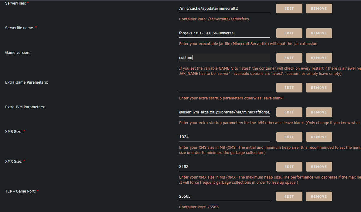

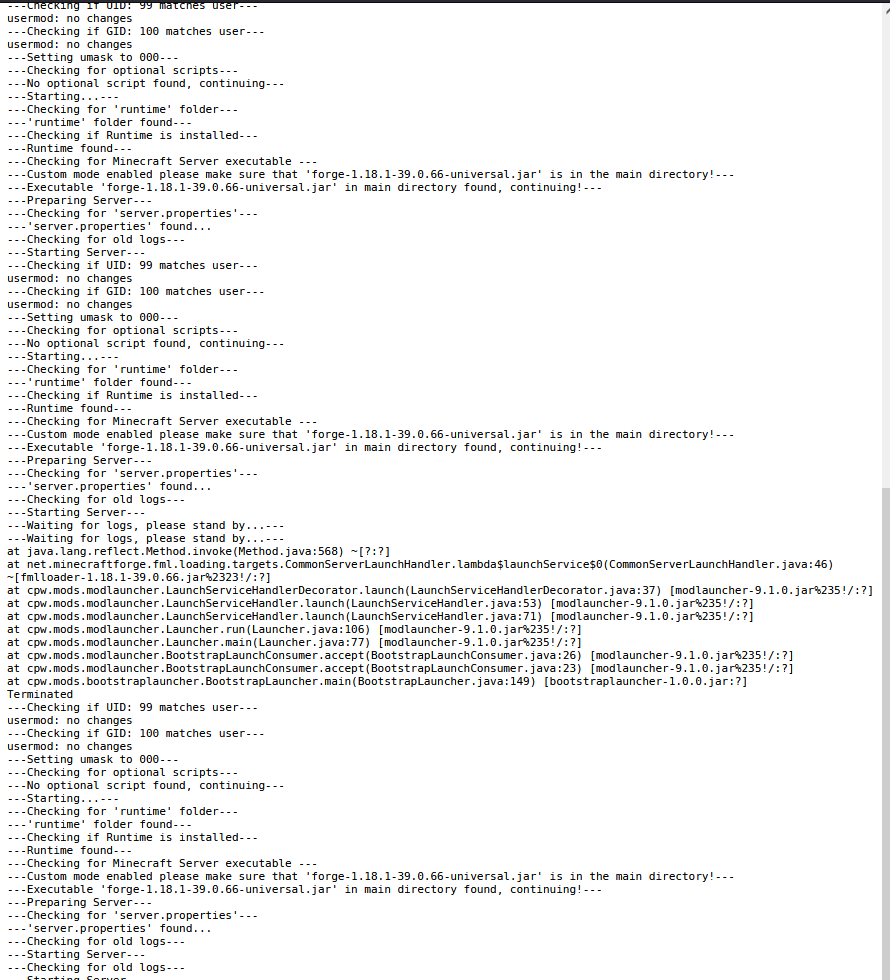

  16. Thats no problem, I will appreciate it if you do when you can. Well the thingis that Forge isnt started via Jars like vanilla... it runs a set of commands within the Library to start. I did just as you said and it didnt work
  17. Well i am looking at Binhex's Minecraft Container configuration and it is rather... unintuitive or at least not very straight forward... there isn't any real explanation on what each setting is and when I loaded my server into it and set the configuration the best I could, it failed to load.. I liked your App because it it is rather straight forward..
  18. Thank you for this information.. I have read the entire issue there and Im having a hard time following unfortunately. Do i need to make a new Variable on the Container setup? If so, how should I set it up.... of if not, what settings should I add and where?
  19. The masterlog.0 file shows this: Ill check the binhex Docker as well.. If anyone else has any advisement, i would appreciate it

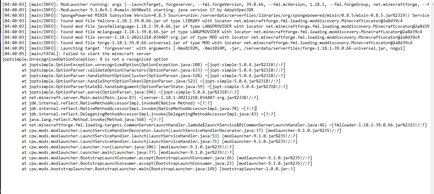

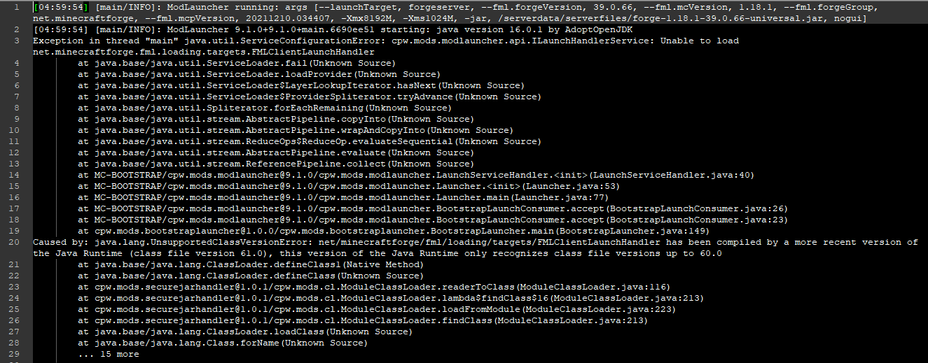

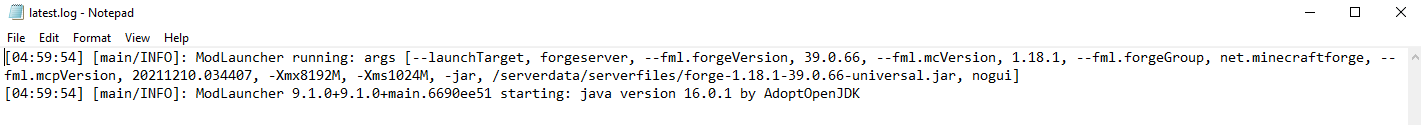

  20. I tried Java11 and that had no change... I then tried Java 16 and i had a change in the log reports: And here is what my Server Logs say now: That seemed to show even less when i did it:
  21. I do not have any mods server or client side installed yet. I was just trying to get the server to actually run first so i pulled out all of my mods for a fresh install. I will attempt to try other Java Versions
  22. I have Java 17 installed on my computer and this same server will start and run on it.. I dont think it is a Java Incompatibility . It looks like the error from the Container logs are truncated... i have added another snapshot of my actual Server Logs to my previous post if you would like to review it

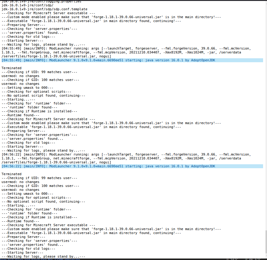

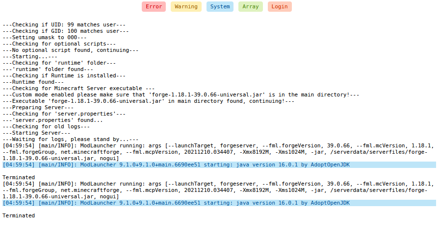

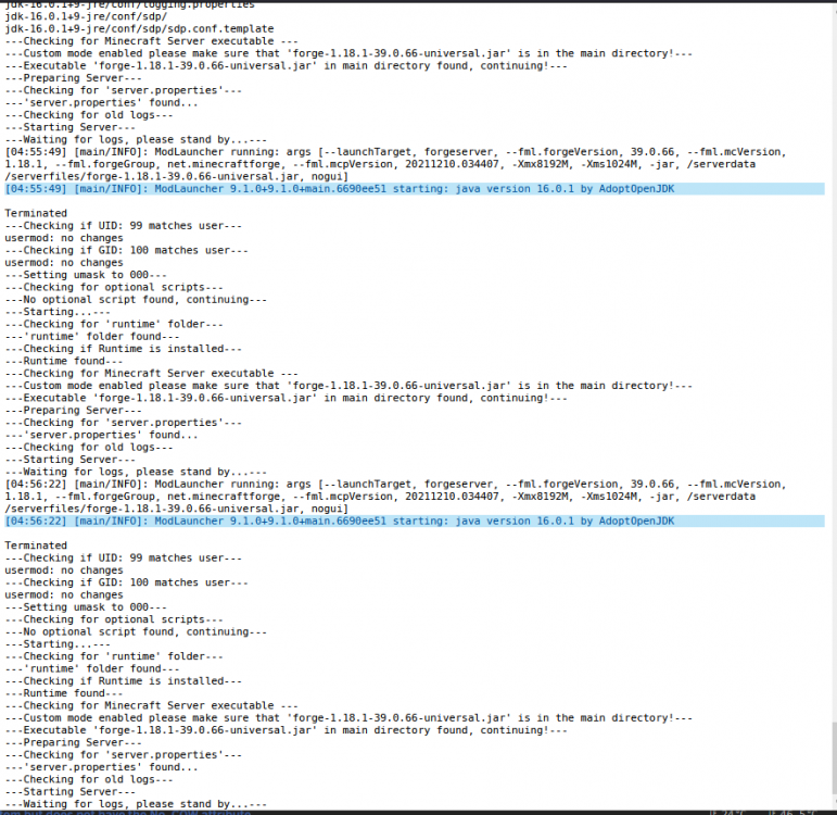

  23. ich777, I am trying to install Forge using your MinecraftBasicServer Docker App. I used to use MineOS, however, the MineOS docker is no longer starting any Servers i have so i have abandoned it to use your App. I can get the server to run with vanilla Minecraft however it will not run using Forge. I have been able to get Forge to work on MineOS Docker by moving the Forge Universal file from the library directory to the Main directory for the server and passing the following Java arguments: @user_jvm_args.txt @libraries/net/minecraftforge/forge/1.18.1-39.0.66/unix_args.txt When do this it on MinecraftBasicServer, it tried to run but then keeps failing.. I have seen other people in this thread have similar issues but no real answers are being provided as it seems the requests are getting lost in other unrelated posts. Could you please provide some advisement. Below is my Logs showing the failure loop and argument settings: EDIT: Here is the full Error from the server's log files.. the Container Log files doesnt seem to show it all:
