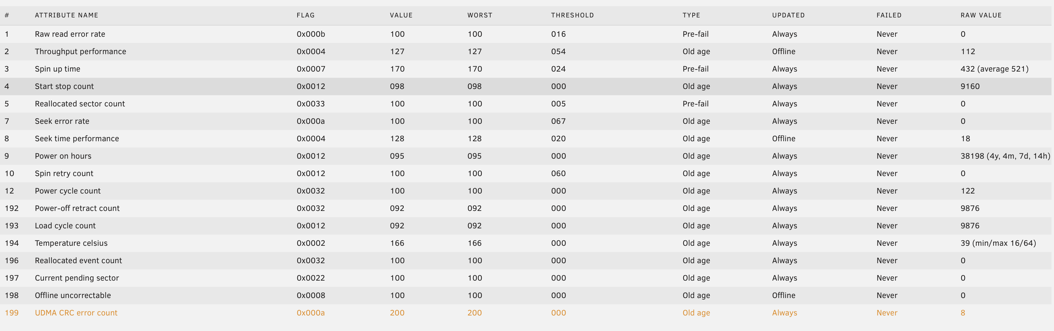

  1. Annoyingly my server is half an hour away and I don't know if that drive is on a SATA-SATA cable or SAS-SATA! This might be a good time to rethink how I'm allocating drives anyway. A number of my array drives are 5+ years old now.
  2. It looks like that might be what's happened, I've attached the diagnostics file but the key bit seems to be here and the read errors precede the write errors: The extended SMART test passed, so I think I'll re-enable the drive. I've ordered two new drives so when they arrive I'll retire this drive to be used as a bit of a dumping ground rather than part of the array. This is where I'd really like multiple arrays - a high value array with my irreplaceable data and newest drives, plus a second array with older drives, which may have thrown an error or two, but which only holds films, music and other replaceable media (but still with a parity drive so a single drive failure isn't a big deal). tower-diagnostics-20260213-0901.zip
  3. Interesting. I've only got a CRC error count of 8, so nowhere near those numbers, but useful to know that I can't entirely discount them as the cause. From the notifications I've had the disk is disabled due to a read error rather than a write error. Hopefully the extended SMART test will throw a little more light on the issue!
  4. Hi all I got a notification from my sever a couple of days ago that disk3 is in error state (disk dsbl), along with another notification stating that the array has 1 disk with read errors (disk3 - errors 16). I've run a short SMART test with no errors, and now the extended test is running. Looking at disk 3's attributes I see this: To my untrained eye nothing looks horrendously abnormal and none of the attributes has 16 errors. The only line that's highlighted is the UDMA CRC error count, but in my experience previously that's just issued a warning and not disabled the drive. Has the behaviour changed in UnRAID or do I need to keep looking for the cause of the disk being disabled? Cheers
