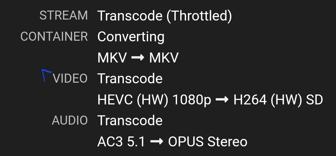

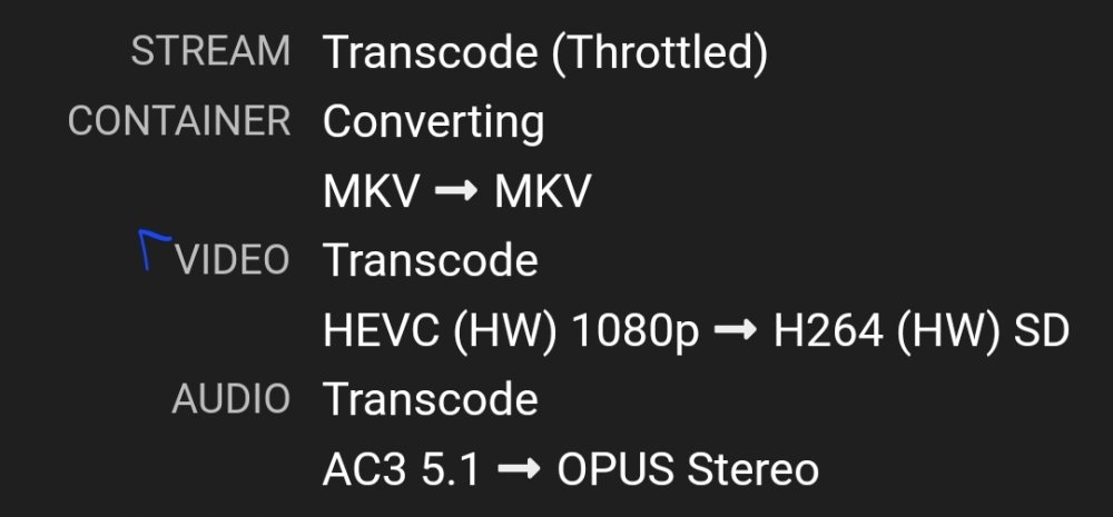

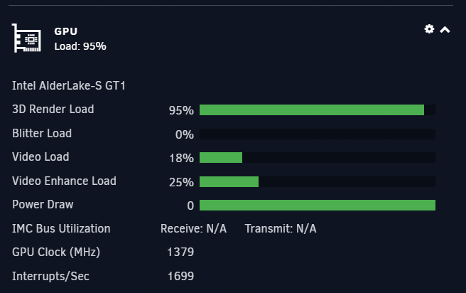

  8. Appreciate the work. Waiting to see how the multi gpu one works. Also plex now shows (HD) when transcoding perfect.
  9. And there we go its working.

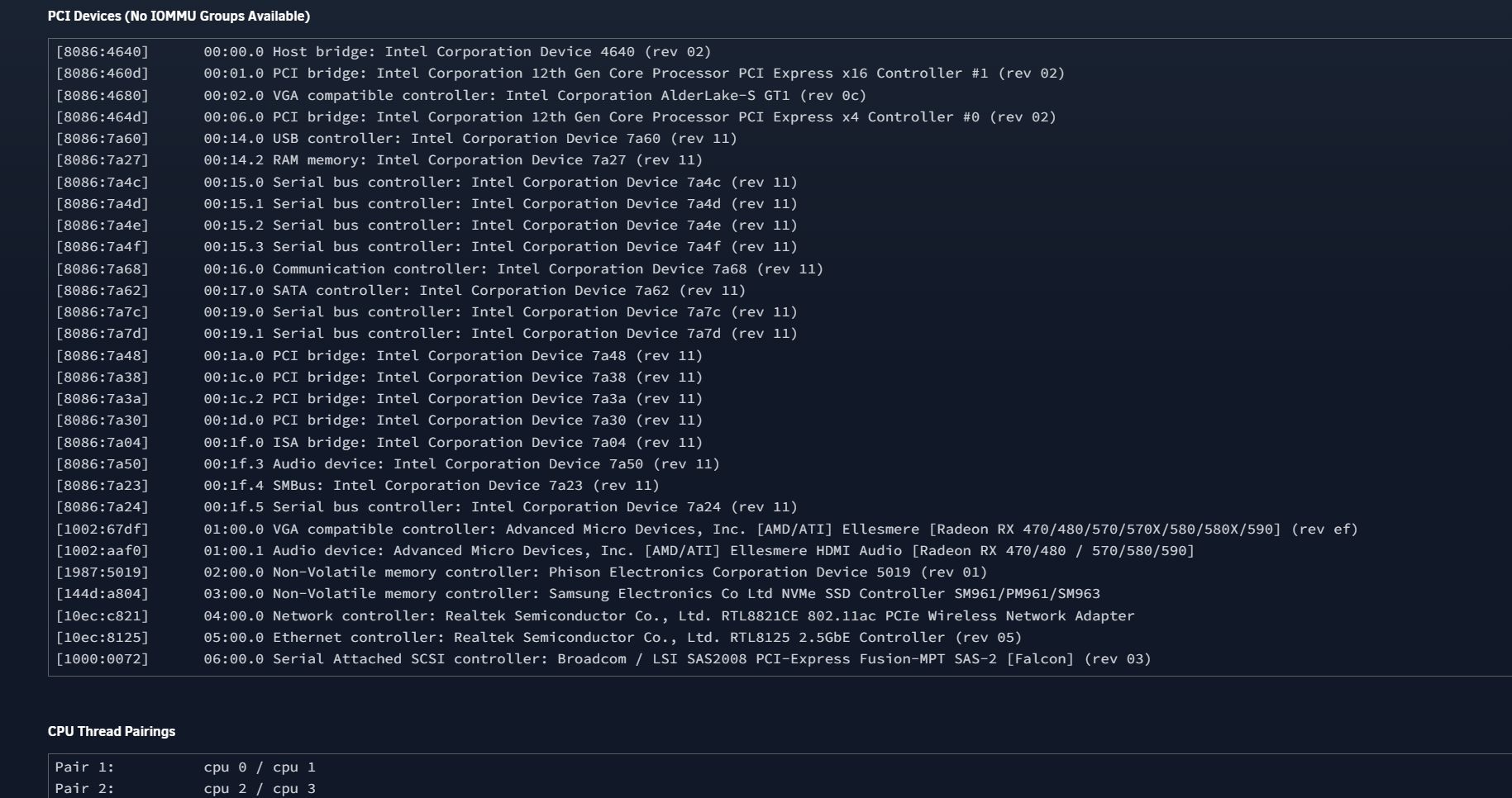

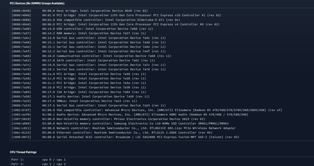

  11. So my system does not have check box options ( used to in older versions on unraid ) I modified the Config file ( FYI path is wrong you gave me, you ment plugins/ ) and added the 0000:00:02.0
  12. Added it for VM testing etc not for transcoding as I had a P400 for that which i removed. How can i bind the Intel?

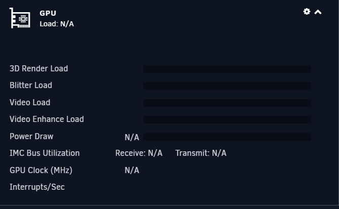

  13. No still N/A root@KiNG-KOOPA:~# cat /tmp/gpujson2 Time = Sun, 19 Mar 2023 09:46:55 -0400 {"clock":"N\/A","fan":"N\/A","memclock":"N\/A","memutil":"N\/A","memused":"N\/A","power":"N\/A","powermax":"N\/A","rxutil":"N\/A","txutil":"N\/A","temp":"N\/A","tempmax":"N\/A","util":"N\/A","error":[{"code":301,"message":"Vendor command returned no data.","extra":""}]}
  14. I removed GPT-g first then ran the command and got that output. Here is a new run. intel_gpu_top -J -s 250 -d pci:slot=0000:00:02.0 { "period": { "duration": 12.701464, "unit": "ms" }, "frequency": { "requested": 0.000000, "actual": 0.000000, "unit": "MHz" }, "interrupts": { "count": 0.000000, "unit": "irq/s" }, "rc6": { "value": 99.999551, "unit": "%" }, "engines": { "Render/3D/0": { "busy": 0.000000, "sema": 0.000000, "wait": 0.000000, "unit": "%" }, "Blitter/0": { "busy": 0.000000, "sema": 0.000000, "wait": 0.000000, "unit": "%" }, "Video/0": { "busy": 0.000000, "sema": 0.000000, "wait": 0.000000, "unit": "%" }, "Video/1": { "busy": 0.000000, "sema": 0.000000, "wait": 0.000000, "unit": "%" }, "VideoEnhance/0": { "busy": 0.000000, "sema": 0.000000, "wait": 0.000000, "unit": "%" } }, "clients": { }
  15. GVT-g was installed so removed it. }^Croot@KiNG-KOOPA:~# intel_gpu_top -Jo - -d pci:slot=0000:00:02.0 { "period": { "duration": 14.966672, "unit": "ms" }, "frequency": { "requested": 0.000000, "actual": 0.000000, "unit": "MHz" }, "interrupts": { "count": 0.000000, "unit": "irq/s" }, "rc6": { "value": 100.000000, "unit": "%" }, "engines": { "Render/3D/0": { "busy": 0.000000, "sema": 0.000000, "wait": 0.000000, "unit": "%" }, "Blitter/0": { "busy": 0.000000, "sema": 0.000000, "wait": 0.000000, "unit": "%" }, "Video/0": { "busy": 0.000000, "sema": 0.000000, "wait": 0.000000, "unit": "%" }, "Video/1": { "busy": 0.000000, "sema": 0.000000, "wait": 0.000000, "unit": "%" }, "VideoEnhance/0": { "busy": 0.000000, "sema": 0.000000, "wait": 0.000000, "unit": "%" } }, "clients": { } } { "period": { "duration": 1011.490547, "unit": "ms" }, "frequency": { "requested": 0.000000, "actual": 0.000000, "unit": "MHz" }, "interrupts": { "count": 0.988640, "unit": "irq/s" }, "rc6": { "value": 100.000000, "unit": "%" }, "engines": { "Render/3D/0": { "busy": 0.000000, "sema": 0.000000, "wait": 0.000000, "unit": "%" }, "Blitter/0": { "busy": 0.000000, "sema": 0.000000, "wait": 0.000000, "unit": "%" }, "Video/0": { "busy": 0.000000, "sema": 0.000000, "wait": 0.000000, "unit": "%" }, "Video/1": { "busy": 0.000000, "sema": 0.000000, "wait": 0.000000, "unit": "%" }, "VideoEnhance/0": { "busy": 0.000000, "sema": 0.000000, "wait": 0.000000, "unit": "%" } }, "clients": { } }^Croot@KiNG-KOOPA:~#
