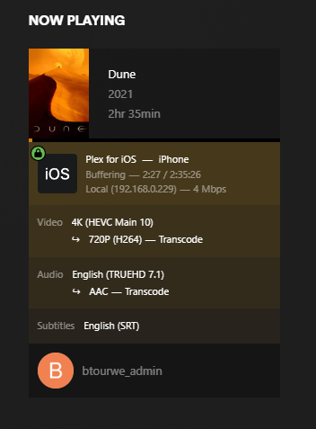

  2. Thanks for your reply. My experience with SRT subs is that they don't cause CPU transcoding, while burnt-in subs do.

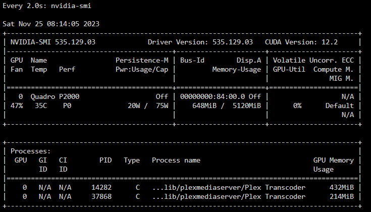

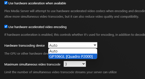

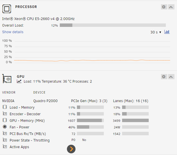

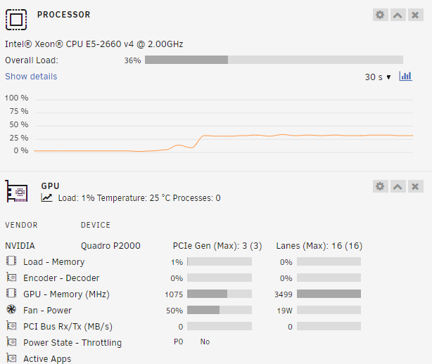

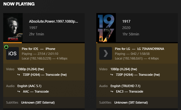

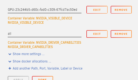

  3. OMG, thank you! This solved it for me. In Plex Server settings, now the GPU card is visible in the transcoder options: Now HW transcoding two streams simultaneously, on iPhone and on LG TV. The stream on the TV is a 4K movie, transcoding to 720P for testing purposes, works as a charm. CPU load is only 12% with 2 streams HW transcoding, instead of 32% before with 1 stream in CPU transcoding. The GPU is humming at 11% load. Both streams also visible in nvidia-smi. @ich777 Thanks for your keen eye in discovering this typo error on my part.

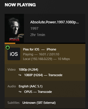

  4. I didn't up until now, thanks for that. So, entered my plex_claim: However, this doesn't solve it. I think I do. Requsting Plex to transcode by requesting a different video quality (e.g. 10Mbps 1080p) in the Plex player (in this case on my iPhone). So still CPU transcoding.

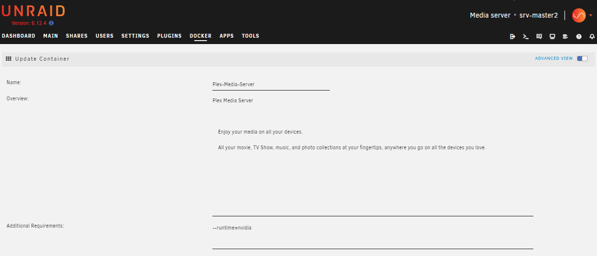

  5. Hi ich777, Thanks for your swift response. Tried putting "--runtime=nvidia" in Extra Parameters, but this doesn't help apparently. Transcoding keeps using CPU, not GPU:

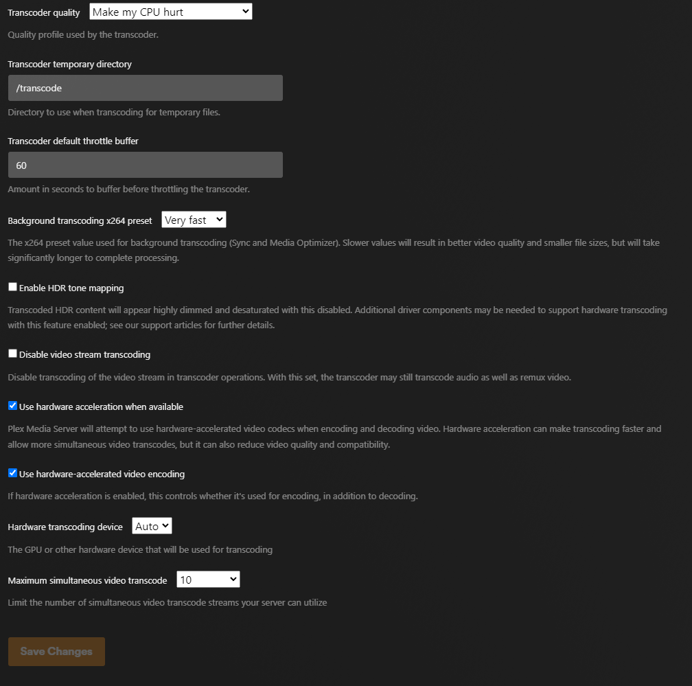

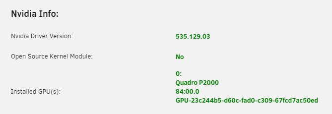

  6. Hoping someone can help, have searched for 2 days now. New Unraid Server, Unraid 6.12.4, HP DL380 G9 with nVidia Quadro P2000 GPU. Can't get Plex to use HW transcoding. Using Production Branch driver in nVidia Plugin Settings. Based on forums tips, I have Plex docker settings like this And these in Plex Server Settings: Still, when forcing transcoding, no HW transcoding is used, only CPU is used. Double checking with "watch nvidia-smi" in Unraid Terminal, shows the GPU isn't working. Posting diagnostics too. Assistance very much appreciated. 🙂 srv-master2-diagnostics-20231124-2312.zip
