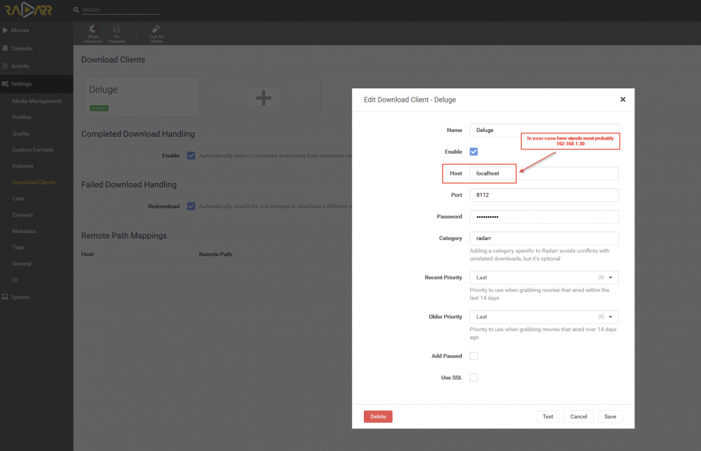

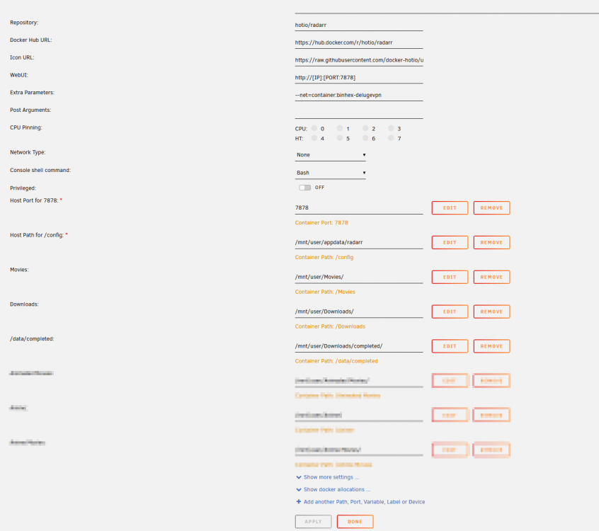

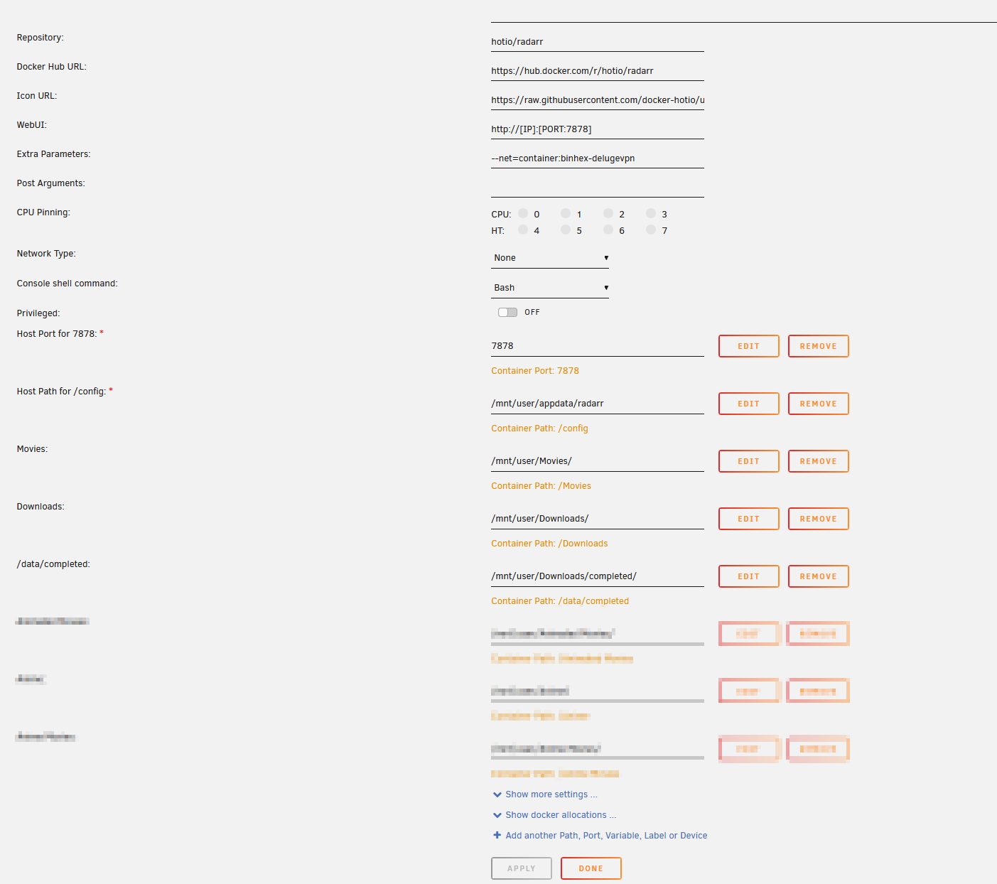

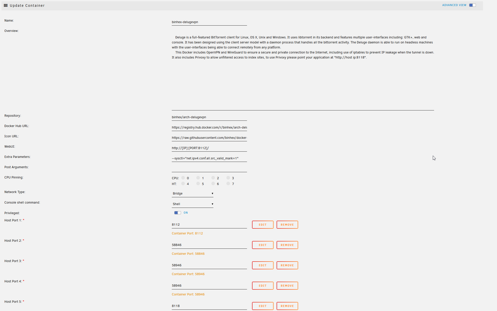

  7. Hi Jayg37 I am using Unraid 6.9 right now. Maybe the missing information comes from different unraid versions (I don't know, I am a newbie). The Unraid 6.9 Version is now the official release, as much as I know and you can update your Server over Tools -> Update OS. Just make a Backup of your thumb drive first .. Just in case. For me the update went smooth as butter :). Here is a Screenshot of my Deluge (they are Up-to-Date at the moment) and Radarr config (I hope I don't show anything I shouldn't :D). To update to docker container, you should first check for the updates under Docker -> Check for Updates (button below the dockers). And Radarr I hope this helps. Edit: The Open WebUI dropdown selection isn't available, when you are using this passtrough. For me, to open for example the Radarr WebUI I am going over the URL http://myserverIP:7878/, where myserverIP is the IP adress of my server. for example 192.168.1.30:7878 in your case (if you are using port 7878 for radarr). Then I added this URL as a Bookmark for ease of access. Plex is http://myserverIP:32400/web/index.html Edit 2: After it is running and you can access Radarr for example, you need to change (for the passtrhough VPN containers) all the written down server IP adresses to "localhost". here my example of Radarr Download client (don't forget the indexers, there you have to change it too): You need to change it everywhere in the dockers, which are running through your vpn deluge docker. I've seen you are using Jackett, so there too.

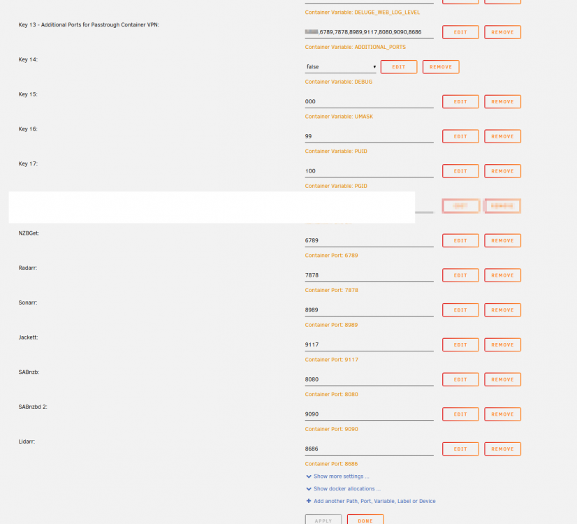

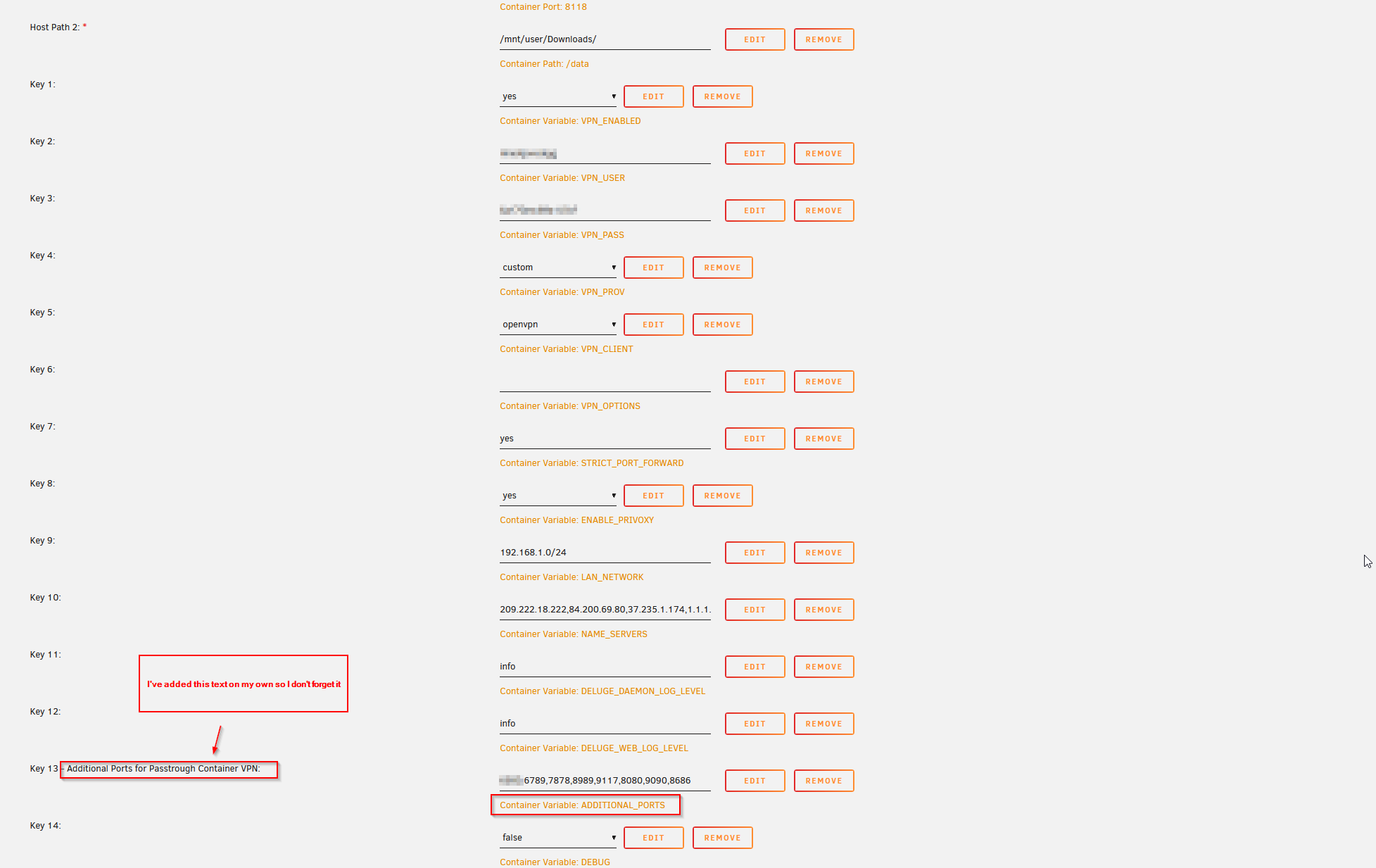

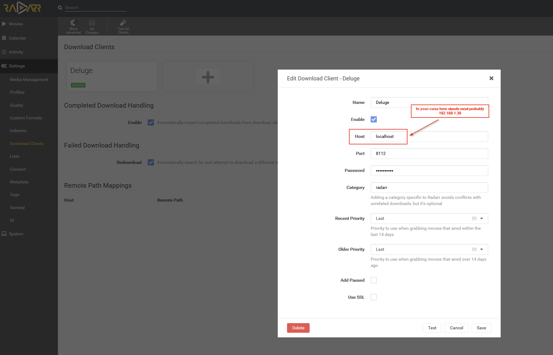

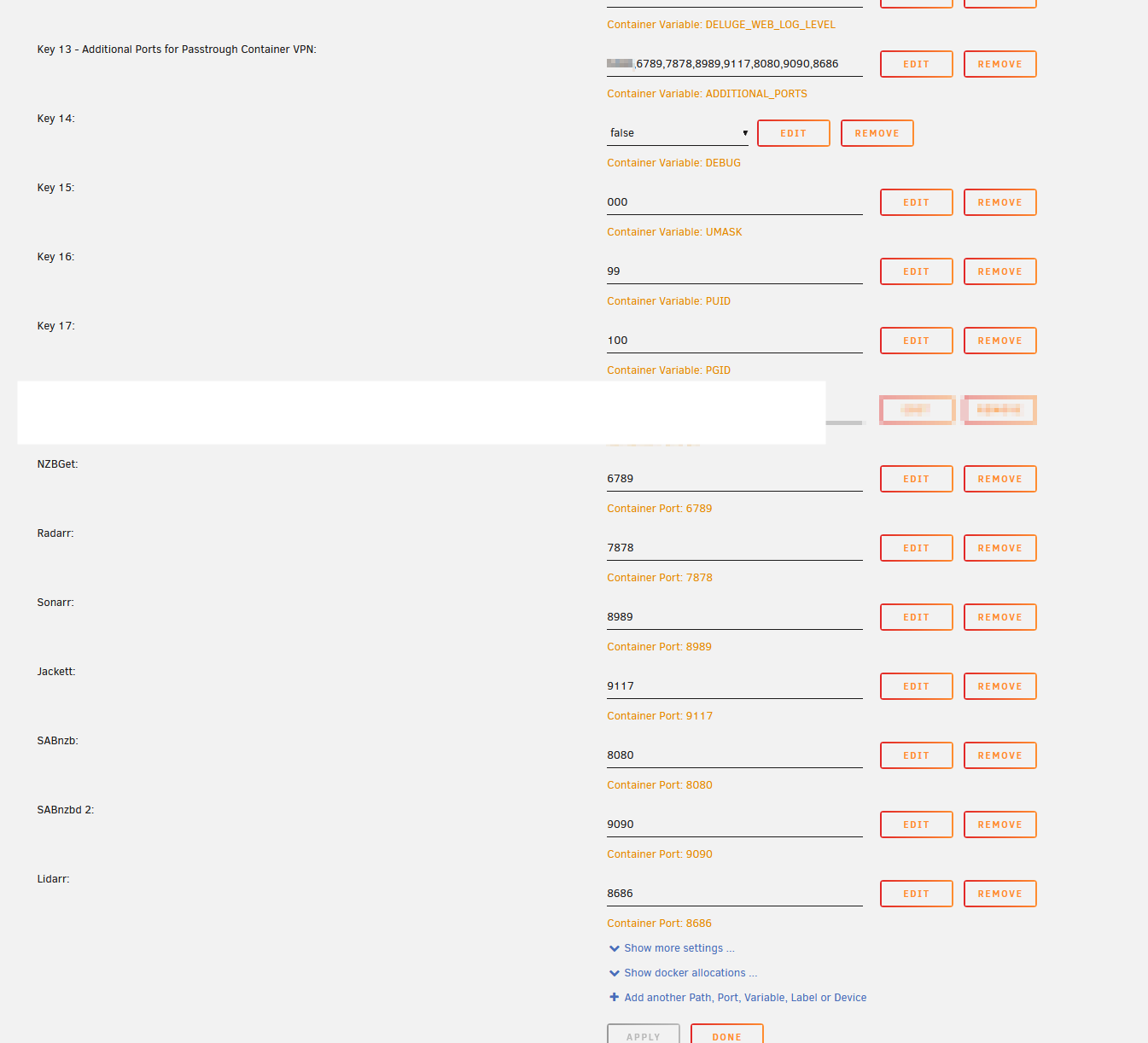

  8. For all the noobs like I am. When you followed the spaceinvader one tutorials to use your delugevpn container for all the others, there is following things to do (thanks to jonathanm for providing the link with all the explanations). 1. In your delugevpn Container -> Edit, and add under Container Variable: ADDITIONAL_PORTS all the ports you have added for your applications, which should be passed through comma separated. For example: 6789,7878,8989,9117,8080,9090,8686. 2. Now you need to change settings in your Containers, which are passed through (Radarr, Jacket and so on). Inside the containers, which now will be accessable you have to change the Server adress to "localhost". So for example if you had in Radarr under Download Clients -> Deluge -> Host (for example) = 192.168.X.XX, you need to change the host to "localhost" without the ".. Just type localhost there. 3. Change it everywhere in the container where you have your host as numbers to text localhost (for example also in indexer). It seems like this helped me with my problem.. If you see that I have missed something, please feel free to note it.
