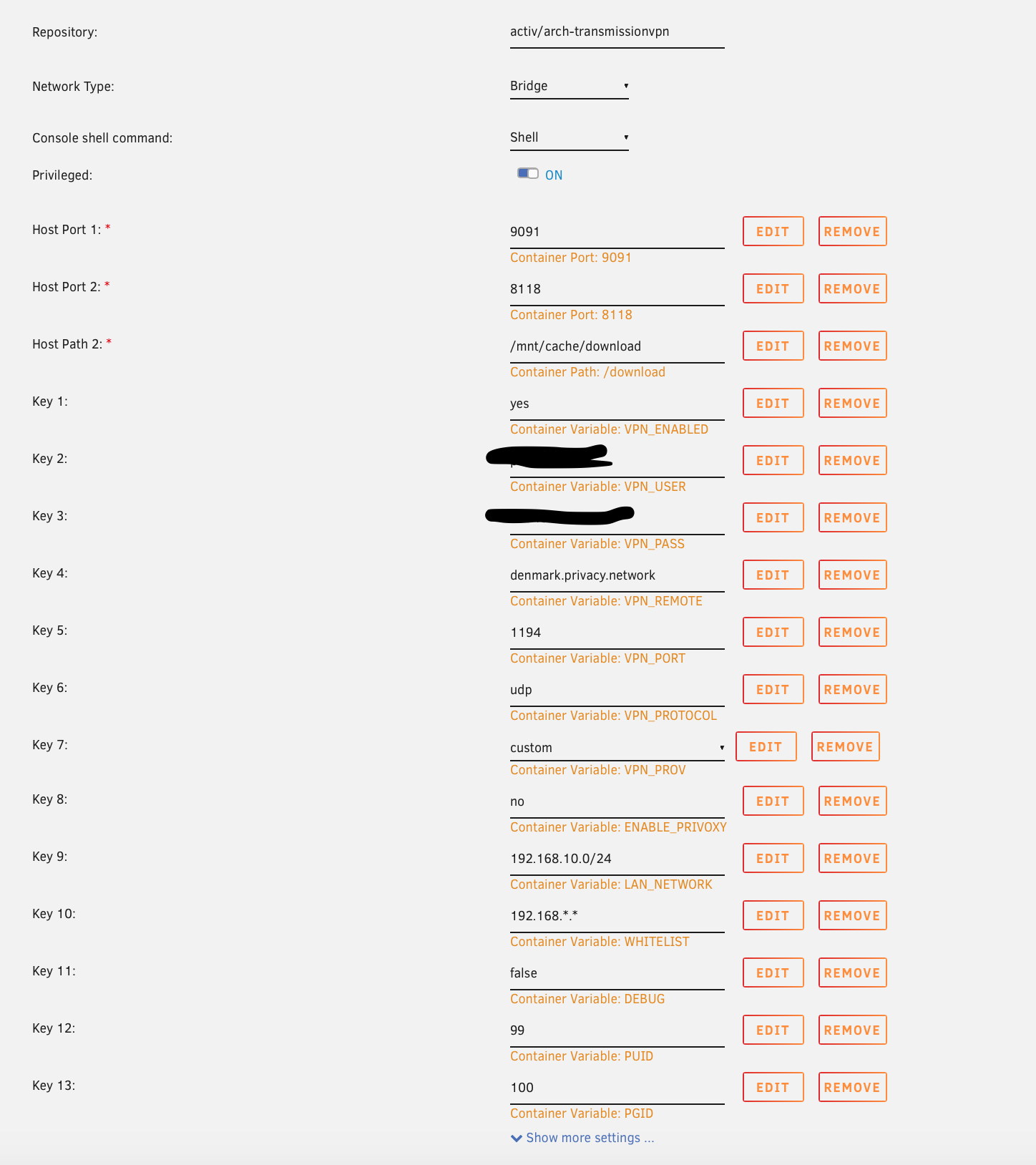

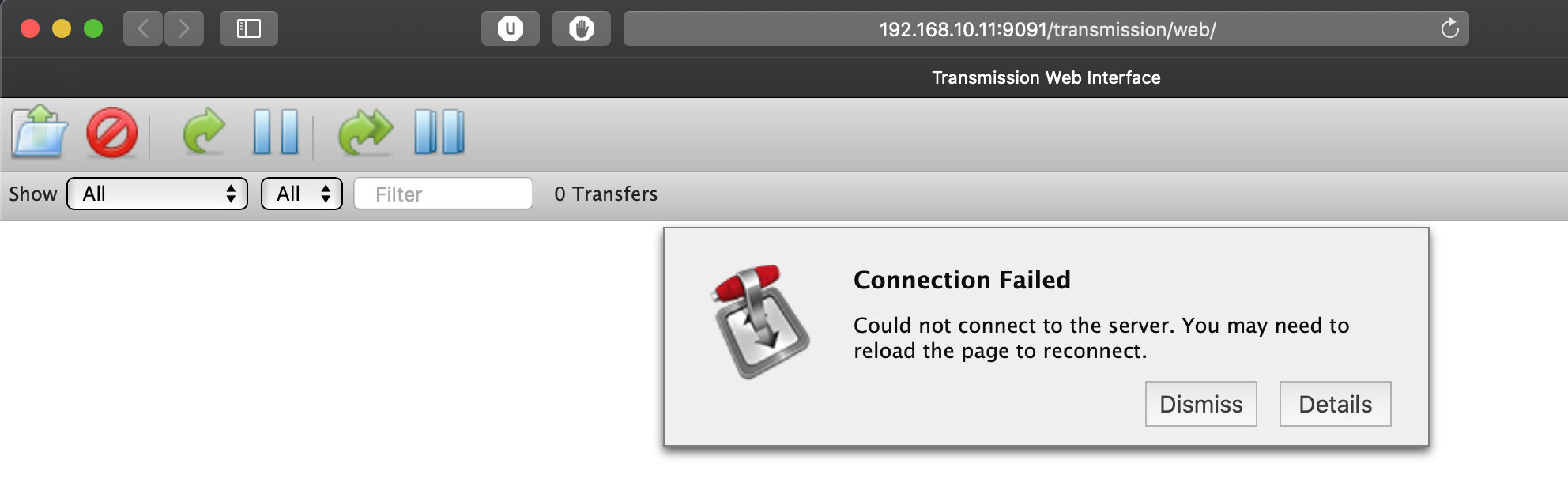

  3. Hi unraid Os 6.11.5 Runing fine several years, primarily as a Plex server. The other day I did something stupid. Deleted some movies from inside Plex. Server froze, had to hard reboot. Everything looks ok when starting, except when I press “start” the server reboots. maybe I can exclude that share/folder? The content is not important. But the rest of server is. Any idea how I start searching for the error and fix this?
  4. Hi, New to this, but would very much like to have my PIA account connected to Transmission. But I can not get it to work. Read many treads, but no luck. Probably missed the solution somewhere reading many treads I´m not an experienced docker-user. I use my unraid for plex and transmission I have "only" downloaded the docker, put my user and password to PIA there, and changed the IP from 192.168.0.* to 192.168.10.* And also downloaded the openvpn file from PIA and replace it with openvpn.ovpn in /mnt/user/appdata/active-transmissionvpn/openvpn/ Do I need to do more? My info: Unrad 6.8.3 server-ip 192.168.10.11 active-transmissionvpn docker transmission settings: If I put key 1 to "no" it works like before. Setting it to "yes" I can see the transmission-gui page, but it will give an error, and nothing works. It do not show my torrens that are there from before. Happy for any help/tips
