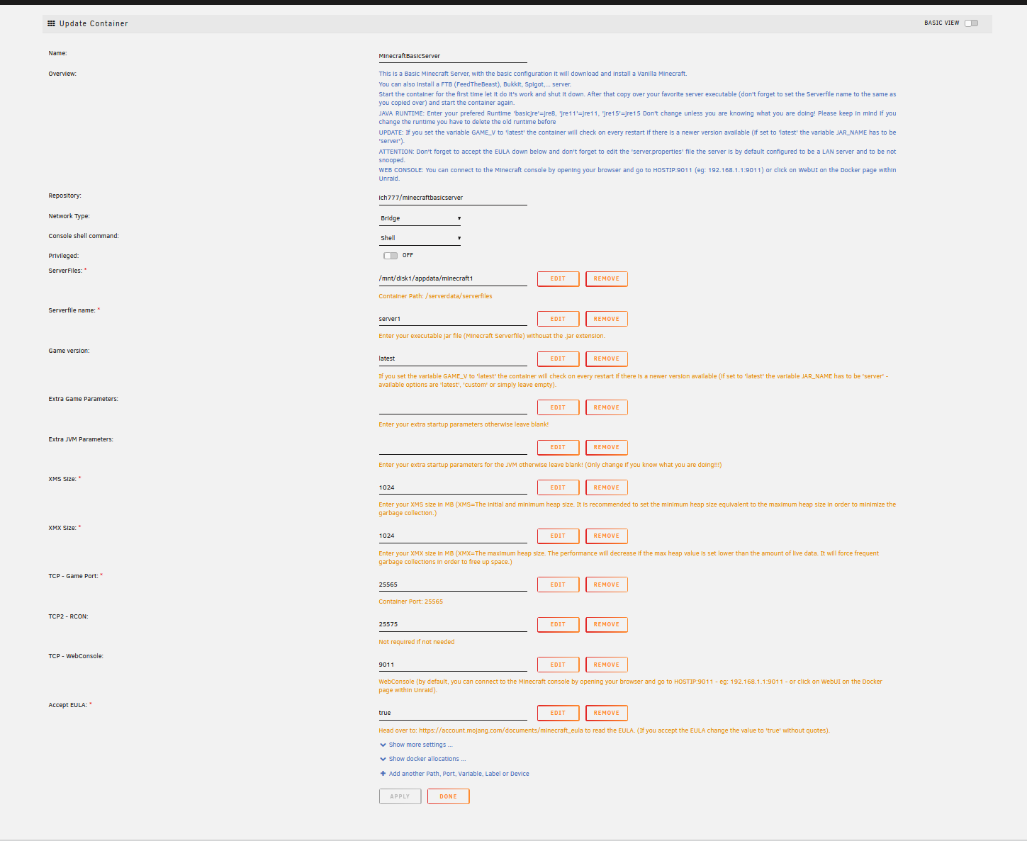

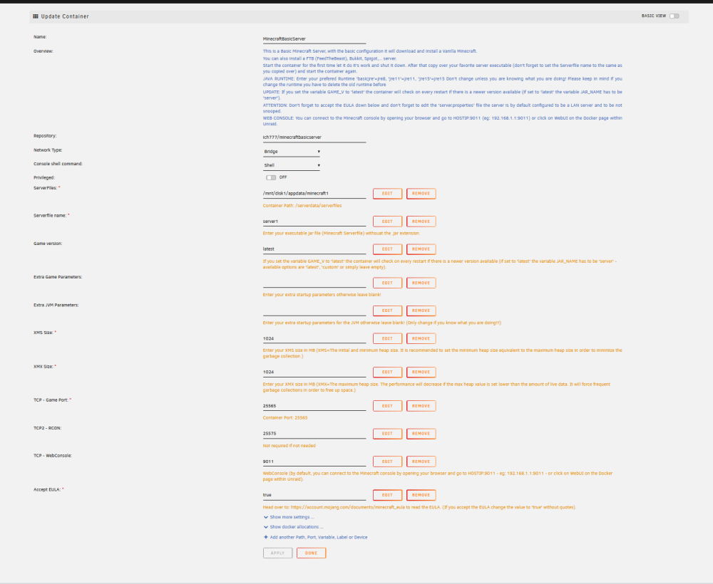

  3. Hello ich777, i have a problem with the minecraft basic server. How can i run this one as a bukket server? When i am replacing the server.jar to the craftbukket jar in the folder and edit this also to the same name in the docker it will always do the default server.jar and replace/delete my old one. What am i doing wrong?

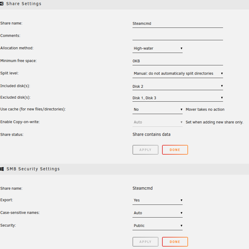

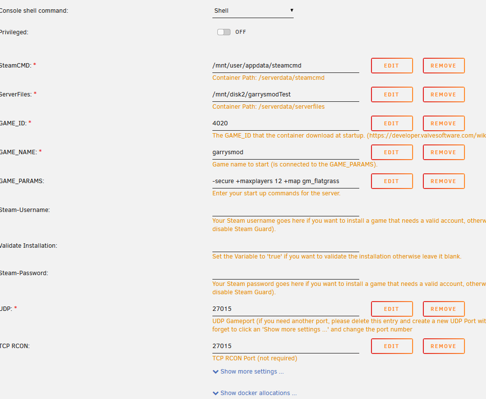

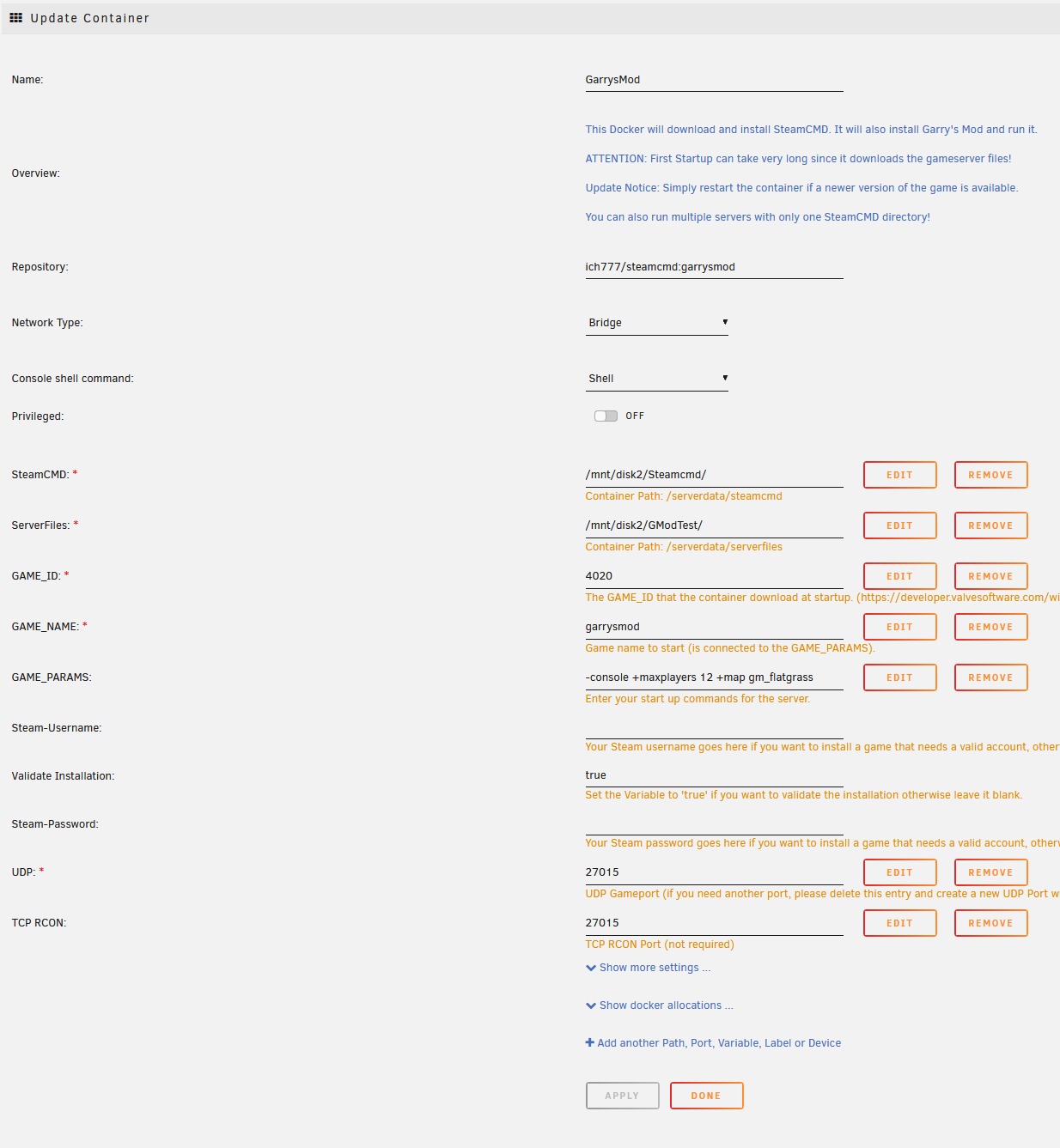

  7. First of all, thanks for your help -- much appreciated I did a clean install, yet nothing changed - still the seg fault crash.log The only change I did to the template from CA was to the ServerFiles to '/mnt/disk2/garrysmodTest' (leaving ServerFiles with default settings segFaults too) All disks are formatted to xfs I don't have a spare disk atm. I can try to hook up an USB stick in the next days, if needed EDIT: @ich777 mounting an USB stick as an unassigned Device for the ServerFiles did infact work. But im still puzzled on why it is not working using an Arraydisk -- any thoughts on this? I think using an USB stick is an sub-optimal solution. Do you have any ideas on how to utilize the array?
  8. No, I do not have a Cache drive installed, just 3 Array- and 1 Parity-Disk. In the meantime I tampered with the template a little - yet had no luck so far. I created 2 shares, dedicated to disk 2 (see below) and mounted these into the container Both shares (Steamcmd and GModTest) are setup identically This is the current (still not working) template configuration.
  9. Hi there :) I am trying to setup a Garry's Mod Server, but unfortunately it keeps crashing with a segmentation fault even on default settings. Here is a snippet of the logs Any idea on what is causing this or how to analyse this further? Best Regards
