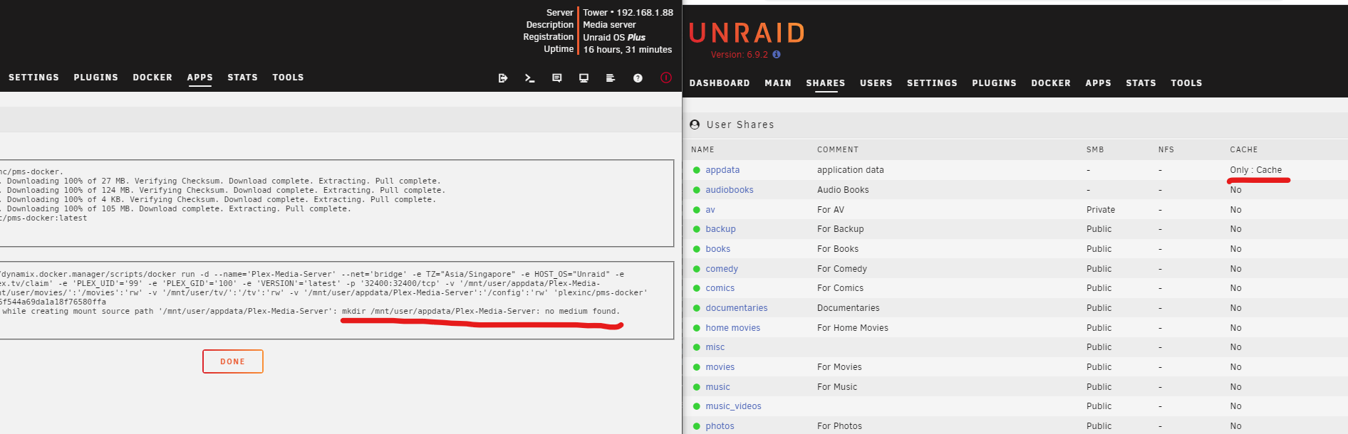

  4. Tried that. Unfortunately, didn't work. I get the error: "Error response from daemon: error while creating mount source path '/mnt/user/appdata/Plex-Media-Server/transcode': mkdir /mnt/user/appdata/Plex-Media-Server: no medium found." whenever I set the appdata to cache-only.

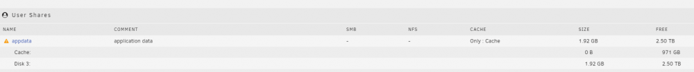

  6. Apologies, I still don't get it. After I set appdata to cache-only, I tried to install plexmediaserver. However, I run into the below error. It seems that I cannot create any new folder in /mnt/user/appdata if I set it to cache-only. I can only create a new folder in /mnt/user/appdata if I set the share to cache-prefer. But if I set it to cache-prefer, the application data will end up on /mnt/disk3/appdata instead of on /mnt/cache/appdata. It is quite confusing.
  7. The other issue is that if I only set the appdata to cache only, I can't start the docker containers properly. E.g plex. The system complains that /mnt/user/appdata: no media found. I had actually upgraded this unraid from a rather old version. Is it worth backing up the .key file in the /boot/config/, reinstall the unraid OS on the same thumbdrive, restore the .key file and redo create all the shares again?

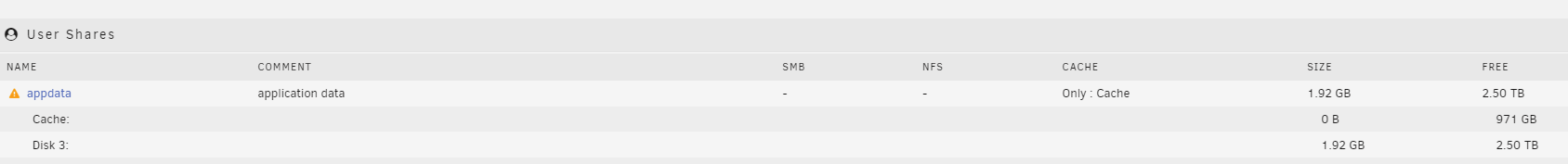

  8. The system would still retain an appdata folder in the disk3. If I delete the appdata folder in disk3, the share would also disappear. Is this the expected behavior? If yes, could you enlightened me why that is so? Thanks.
  9. Oh man! That was such an amateur mistake!!! Thanks for pointing out. However, I am still unable to create an appdata share that is cache only. Did I misconfigure anything? Please advise.

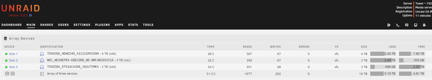

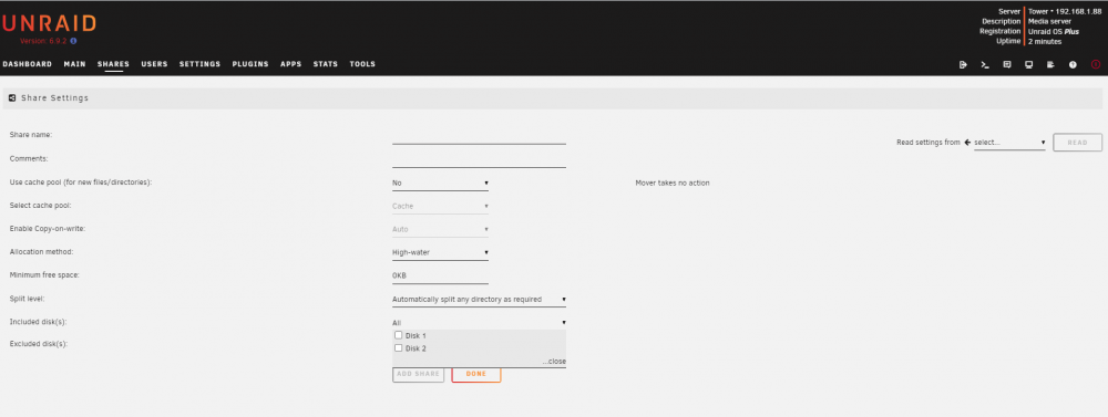

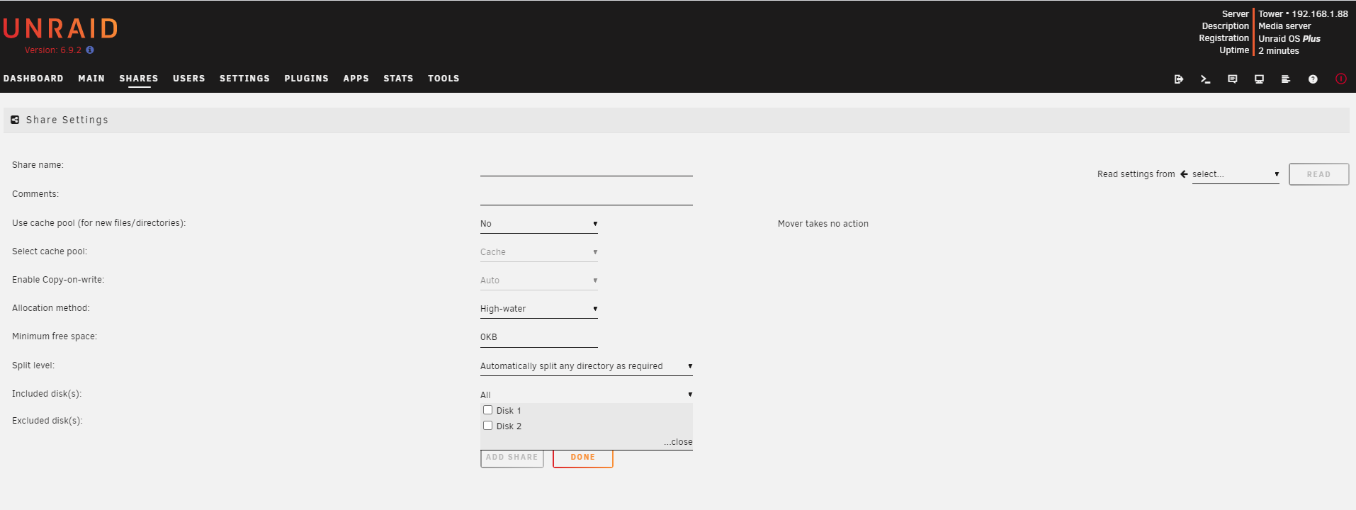

  10. I had recently change my file system from reiserfs to xfs using a swap disk. After doing that, I found that I am not able to create new shares. When attempting to create a new share, the service seems to hang and require to stop and restart the array before it works again. I also noticed that when I add the new share, in the include or exclude drive, I can't find my Disk 3 in there. Even though I clearly have Disk 3 in the array. Attached is my diagnostics log. Hope someone can point me in a direction to solve this. Thanks. tower-diagnostics-20210811-0050.zip

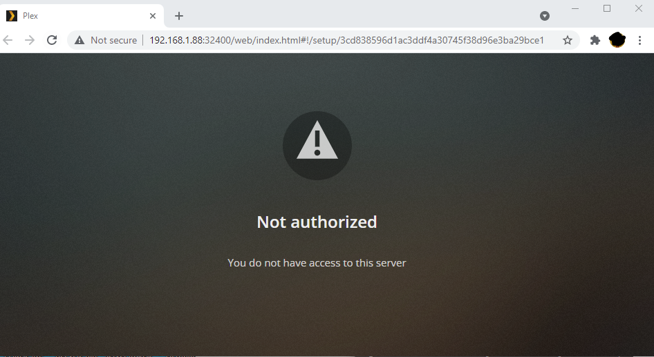

  11. Initially, I tried to add the claim token as advised. Unfortunately, after adding the token, I could not even access the plex server through ip:32400. Then I decided to shutdown the server completely, restart and try again. This time, it worked like a charm with the token! I managed to claim the server! Thanks @mgutt! You saved the day!
  12. Hi. I am a noob. I installed the Plex Media Server plugin. When I tried to open the webui, I kept getting the error: I am attaching the log file hoping someone can advise how to fix this issue. Plex Media Server.log
