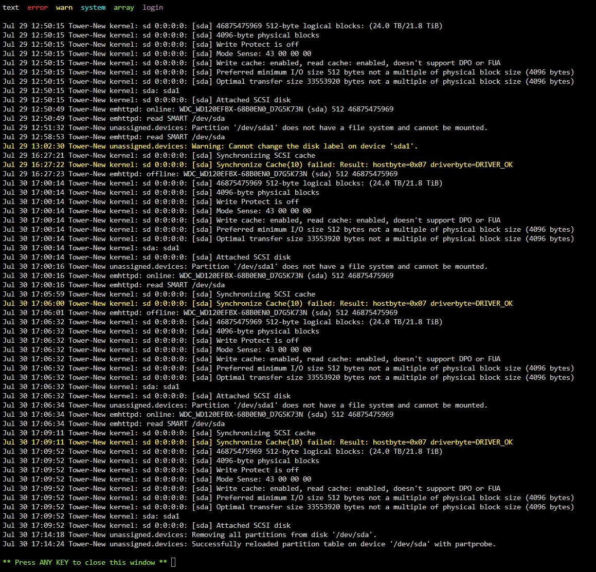

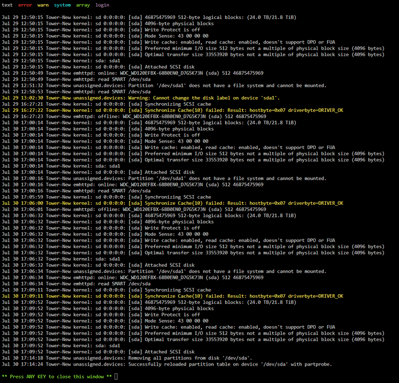

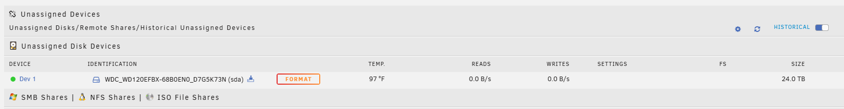

I ran the "wipefs -f /dev/sda", it didn't seem to do anything. I removed the PreClear app. I clicked the red "X" and the RAID device with the 2 disks had some activity. Here is the log file and what UnRaid shows now. I'm going to try clicking on the "FORMAT" button (crossing my fingers of course). I do another post to tell what happens.

1) I'll try the " wipefs -f /dev/sda " first and give that feedback as well. If that doesn't help I'll got to your suggestion, below. 2) I did think about clicking the "X", but when I do it tells me it's going to force the PreClear again. It took almost 67 hours the first time. I've never tried, but maybe the answer to that is to Stop the PreClear once it starts so I don't go through that again. The discs did pass when I already ran it, so they should be good. Can you give me feedback on that assumption. If that has a good chance of working I can try it. Thank you Vr2lo.

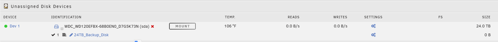

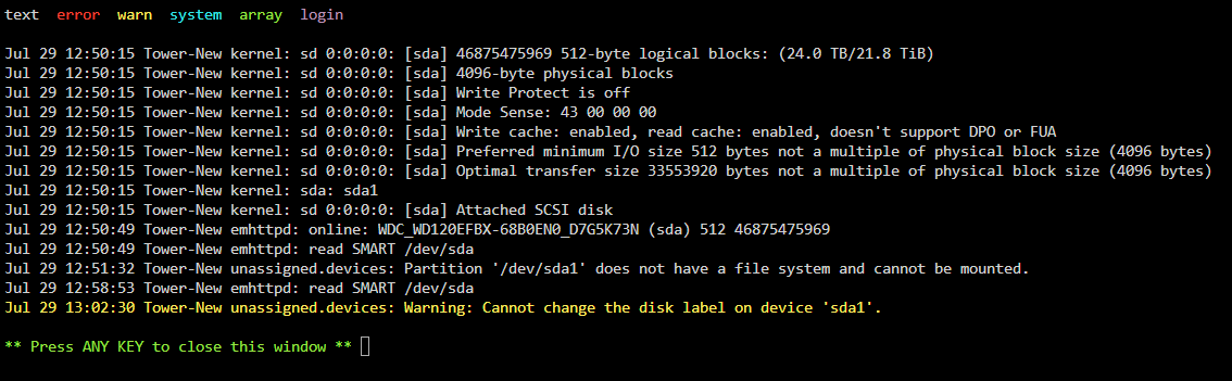

Both Drives are Western Digital 12TB WD120EFBX. The enclosure is a Mediasonic HUR5-SU31C, it is a 2 disc device with Single, JBOD, RAID 0/1 functions. I have it in the RAID 0 setting so I can get the total 24TB of space. I named it "24TB_Backup_Disk". The IDENTIFICATION column is showing the serial number of the original 12TB Disc that I was backing my "/plexmedia/movies" Share successfully to with RSYNC using this command -> "rsync -avh --delete "/mnt/user/plexmedia/movies/" "/mnt/disks/12TB_Backup_Disk/movies/"" I added the 2nd 12TB disc and did a PreClear. After the PreClear UnRaid does show the Size to be 24TB The "Mount" button is Greyed out. This is the log file: I can't figure out how to do the Format to make the drives be seen, which is why I think the "Mount" button is Greyed out. Thank you for your response Kilrah
