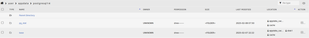

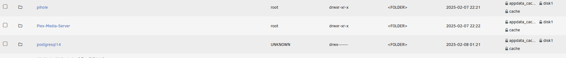

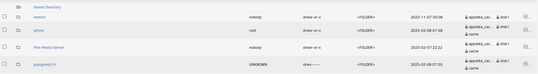

  11. I was able to use Unraids GUI to move files and folders around. For Posterity this is what I did: I stopped docker and VM's. @moved all of the shares onto the array. Deleted any duplicate files left behind on the cache pools. Moved files from the array to the appropriate cache pool if required. Reset file mover directions appropriately (cach->array or array->cache) Restarted docker and VM's. Worked like a charm.

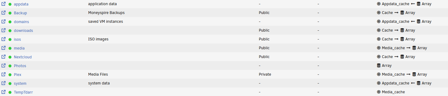

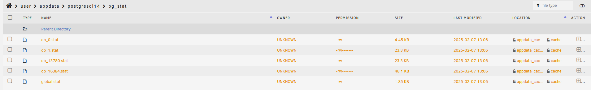

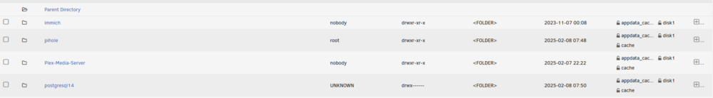

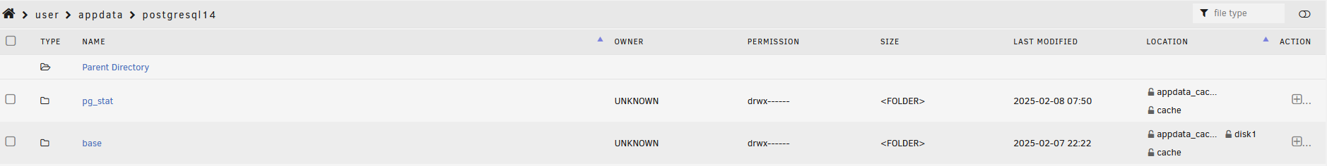

  12. I tried moving everything onto the array again, and I still have files split or duplicated across multiple locations.
