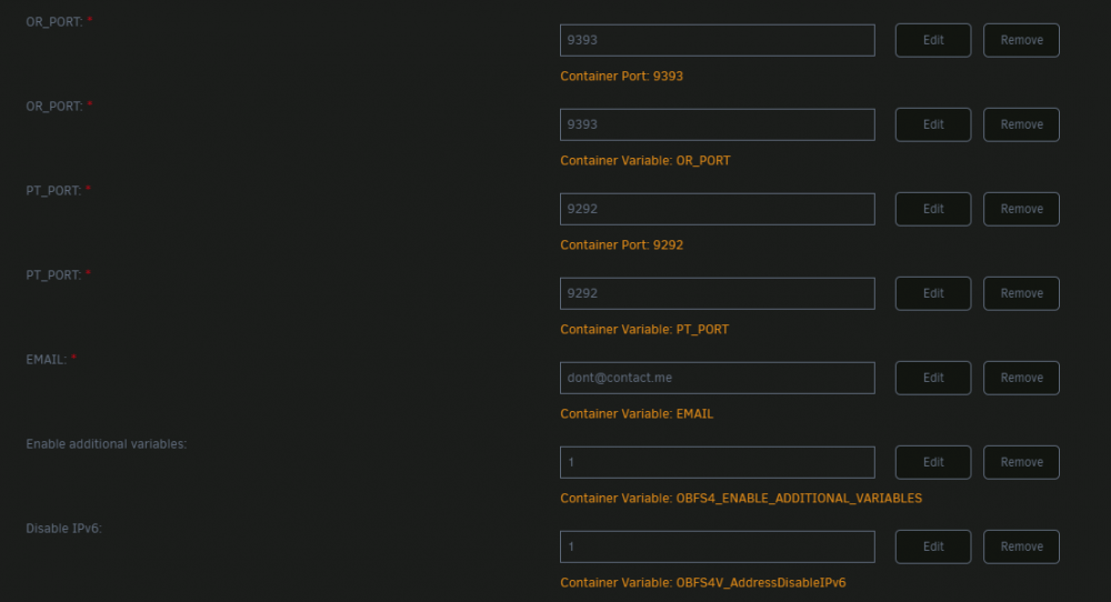

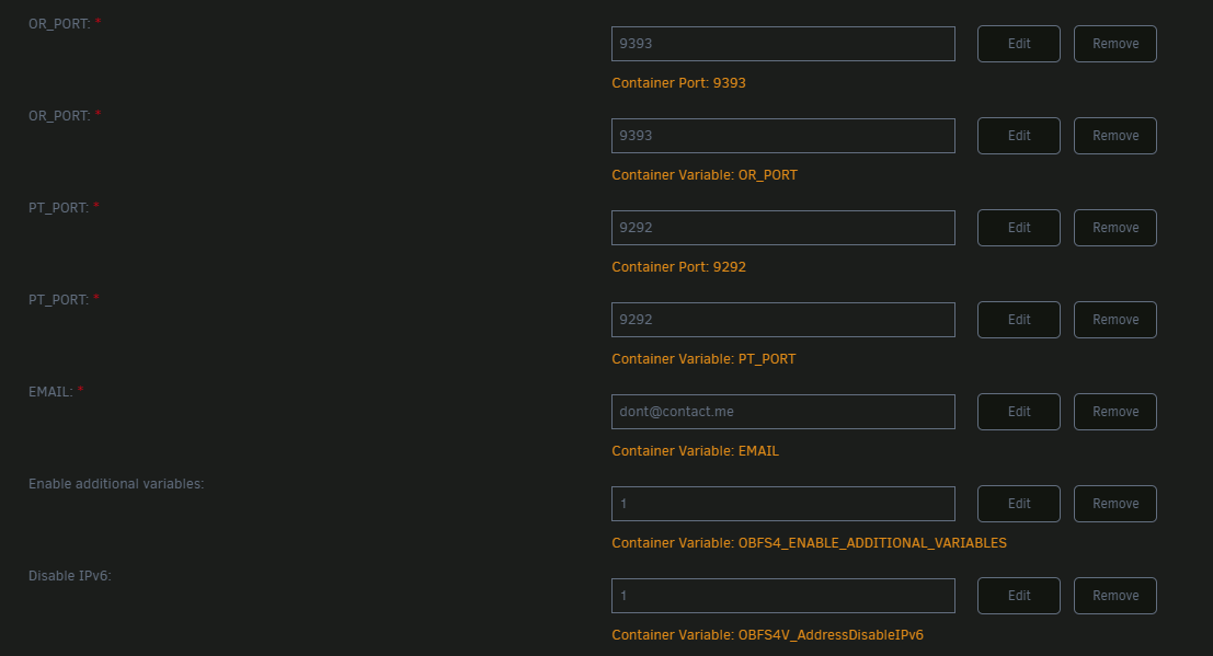

Somehow it seems this is not working for me, I don't get any trafic, even after a couple days waiting. Does someone have an idea what could go wrong? I'm stopping the container every day at night for one hour or so, since this is backup time. https://bridges.torproject.org/status?id=[MyID] is reporting: * obfs4: dysfunctional Error: timed out waiting for bridge descriptor Last tested: 2022-03-22 03:15:07.691628216 +0000 UTC (7h19m51.151949657s ago) Using NICKNAME=DockerObfs4Bridge, OR_PORT=9393, PT_PORT=9292, and [email protected]. Additional properties from 'OBFS4V_' environment variables processing enabled Overriding 'AddressDisableIPv6' with value '1' Starting tor. Mar 22 02:08:33.162 [notice] Tor 0.4.6.10 running on Linux with Libevent 2.1.12-stable, OpenSSL 1.1.1k, Zlib 1.2.11, Liblzma 5.2.5, Libzstd 1.4.8 and Glibc 2.31 as libc. Mar 22 02:08:33.162 [notice] Tor can't help you if you use it wrong! Learn how to be safe at https://support.torproject.org/faq/staying-anonymous/ Mar 22 02:08:33.162 [notice] Read configuration file "/etc/tor/torrc". Mar 22 02:08:33.163 [notice] Based on detected system memory, MaxMemInQueues is set to 6374 MB. You can override this by setting MaxMemInQueues by hand. Mar 22 02:08:33.164 [notice] Opening OR listener on 0.0.0.0:9393 Mar 22 02:08:33.164 [notice] Opened OR listener connection (ready) on 0.0.0.0:9393 Mar 22 02:08:33.165 [notice] Opening OR listener on [::]:9393 Mar 22 02:08:33.165 [notice] Opened OR listener connection (ready) on [::]:9393 Mar 22 02:08:33.165 [notice] Opening Extended OR listener on 127.0.0.1:0 Mar 22 02:08:33.165 [notice] Extended OR listener listening on port 46133. Mar 22 02:08:33.165 [notice] Opened Extended OR listener connection (ready) on 127.0.0.1:46133 Mar 22 02:08:34.000 [notice] Parsing GEOIP IPv4 file /usr/share/tor/geoip. Mar 22 02:08:34.000 [notice] Parsing GEOIP IPv6 file /usr/share/tor/geoip6. Mar 22 02:08:34.000 [notice] Configured to measure statistics. Look for the *-stats files that will first be written to the data directory in 24 hours from now. Mar 22 02:08:34.000 [notice] Your Tor server's identity key fingerprint is 'DockerObfs4Bridge ID' Mar 22 02:08:34.000 [notice] Your Tor bridge's hashed identity key fingerprint is 'DockerObfs4Bridge MyID' Mar 22 02:08:34.000 [notice] Your Tor server's identity key ed25519 fingerprint is 'DockerObfs4Bridge AnotherID Mar 22 02:08:34.000 [notice] You can check the status of your bridge relay at https://bridges.torproject.org/status?id=MyID Mar 22 02:08:34.000 [notice] Bootstrapped 0% (starting): Starting Mar 22 02:08:51.000 [notice] Starting with guard context "default" Mar 22 02:08:51.000 [notice] Registered server transport 'obfs4' at '[::]:9292' Mar 22 02:08:52.000 [notice] Bootstrapped 5% (conn): Connecting to a relay Mar 22 02:08:52.000 [notice] Unable to find IPv4 address for ORPort 9393. You might want to specify IPv6Only to it or set an explicit address or set Address. Mar 22 02:08:52.000 [notice] Bootstrapped 10% (conn_done): Connected to a relay Mar 22 02:08:52.000 [notice] Bootstrapped 14% (handshake): Handshaking with a relay Mar 22 02:08:52.000 [notice] Bootstrapped 15% (handshake_done): Handshake with a relay done Mar 22 02:08:52.000 [notice] Bootstrapped 75% (enough_dirinfo): Loaded enough directory info to build circuits Mar 22 02:08:52.000 [notice] Bootstrapped 90% (ap_handshake_done): Handshake finished with a relay to build circuits Mar 22 02:08:52.000 [notice] Bootstrapped 95% (circuit_create): Establishing a Tor circuit Mar 22 02:08:52.000 [notice] External address seen and suggested by a directory authority: my.private.ip Mar 22 02:08:52.000 [notice] Bootstrapped 100% (done): Done Mar 22 02:09:52.000 [notice] Now checking whether IPv4 ORPort my.private.ip:9393 is reachable... (this may take up to 20 minutes -- look for log messages indicating success) Mar 22 02:09:52.000 [notice] Self-testing indicates your ORPort my.private.ip:9393 is reachable from the outside. Excellent. Publishing server descriptor. Mar 22 02:21:52.000 [notice] Performing bandwidth self-test...done. Using NICKNAME=DockerObfs4Bridge, OR_PORT=9393, PT_PORT=9292, and [email protected]. Additional properties from 'OBFS4V_' environment variables processing enabled Overriding 'AddressDisableIPv6' with value '1' Starting tor. Mar 22 04:45:01.774 [notice] Tor 0.4.6.10 running on Linux with Libevent 2.1.12-stable, OpenSSL 1.1.1k, Zlib 1.2.11, Liblzma 5.2.5, Libzstd 1.4.8 and Glibc 2.31 as libc. Mar 22 04:45:01.774 [notice] Tor can't help you if you use it wrong! Learn how to be safe at https://support.torproject.org/faq/staying-anonymous/ Mar 22 04:45:01.774 [notice] Read configuration file "/etc/tor/torrc". Mar 22 04:45:01.775 [notice] Based on detected system memory, MaxMemInQueues is set to 6374 MB. You can override this by setting MaxMemInQueues by hand. Mar 22 04:45:01.776 [notice] Opening OR listener on 0.0.0.0:9393 Mar 22 04:45:01.776 [notice] Opened OR listener connection (ready) on 0.0.0.0:9393 Mar 22 04:45:01.776 [notice] Opening OR listener on [::]:9393 Mar 22 04:45:01.776 [notice] Opened OR listener connection (ready) on [::]:9393 Mar 22 04:45:01.776 [notice] Opening Extended OR listener on 127.0.0.1:0 Mar 22 04:45:01.776 [notice] Extended OR listener listening on port 33923. Mar 22 04:45:01.776 [notice] Opened Extended OR listener connection (ready) on 127.0.0.1:33923 Mar 22 04:45:03.000 [notice] Parsing GEOIP IPv4 file /usr/share/tor/geoip. Mar 22 04:45:03.000 [notice] Parsing GEOIP IPv6 file /usr/share/tor/geoip6. Mar 22 04:45:03.000 [notice] Configured to measure statistics. Look for the *-stats files that will first be written to the data directory in 24 hours from now. Mar 22 04:45:03.000 [notice] Your Tor server's identity key fingerprint is 'DockerObfs4Bridge ID' Mar 22 04:45:03.000 [notice] Your Tor bridge's hashed identity key fingerprint is 'DockerObfs4Bridge MyID' Mar 22 04:45:03.000 [notice] Your Tor server's identity key ed25519 fingerprint is 'DockerObfs4Bridge AnotherID Mar 22 04:45:03.000 [notice] You can check the status of your bridge relay at https://bridges.torproject.org/status?id=MyID Mar 22 04:45:03.000 [notice] Bootstrapped 0% (starting): Starting Mar 22 04:45:13.000 [notice] Starting with guard context "default" Mar 22 04:45:13.000 [notice] Registered server transport 'obfs4' at '[::]:9292' Mar 22 04:45:14.000 [notice] Bootstrapped 5% (conn): Connecting to a relay Mar 22 04:45:14.000 [notice] Unable to find IPv4 address for ORPort 9393. You might want to specify IPv6Only to it or set an explicit address or set Address. Mar 22 04:45:14.000 [notice] Bootstrapped 10% (conn_done): Connected to a relay Mar 22 04:45:14.000 [notice] Bootstrapped 14% (handshake): Handshaking with a relay Mar 22 04:45:14.000 [notice] Bootstrapped 15% (handshake_done): Handshake with a relay done Mar 22 04:45:14.000 [notice] Bootstrapped 75% (enough_dirinfo): Loaded enough directory info to build circuits Mar 22 04:45:14.000 [notice] Bootstrapped 90% (ap_handshake_done): Handshake finished with a relay to build circuits Mar 22 04:45:14.000 [notice] Bootstrapped 95% (circuit_create): Establishing a Tor circuit Mar 22 04:45:14.000 [notice] External address seen and suggested by a directory authority: my.private.ip Mar 22 04:45:14.000 [notice] Bootstrapped 100% (done): Done Mar 22 04:46:14.000 [notice] Now checking whether IPv4 ORPort my.private.ip:9393 is reachable... (this may take up to 20 minutes -- look for log messages indicating success) Mar 22 04:46:14.000 [notice] Self-testing indicates your ORPort my.private.ip:9393 is reachable from the outside. Excellent. Publishing server descriptor. Mar 22 04:53:14.000 [notice] Performing bandwidth self-test...done. Mar 22 10:45:14.000 [notice] Heartbeat: Tor's uptime is 6:00 hours, with 0 circuits open. I've sent 2.26 MB and received 6.20 MB. I've received 28 connections on IPv4 and 0 on IPv6. I've made 23 connections with IPv4 and 0 with IPv6. Mar 22 10:45:14.000 [notice] While bootstrapping, fetched this many bytes: 48465 (consensus network-status fetch); 897 (microdescriptor fetch) Mar 22 10:45:14.000 [notice] While not bootstrapping, fetched this many bytes: 3889100 (server descriptor fetch); 359 (server descriptor upload); 339753 (consensus network-status fetch); 31346 (microdescriptor fetch) Mar 22 10:45:14.000 [notice] Heartbeat: In the last 6 hours, I have seen 0 unique clients. My Config:
