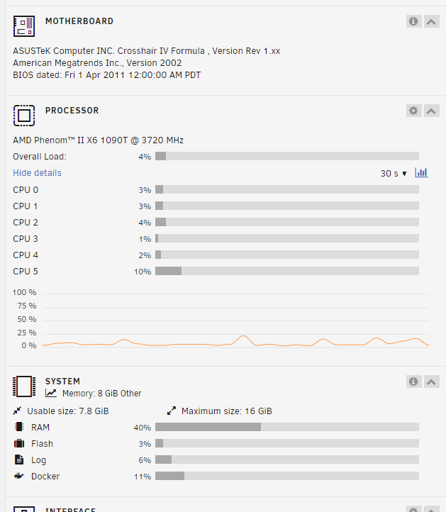

  6. Ohh I see! Maybe time to upgrade the computer. Thank you very much for your time and assistance.

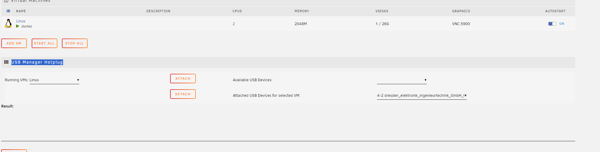

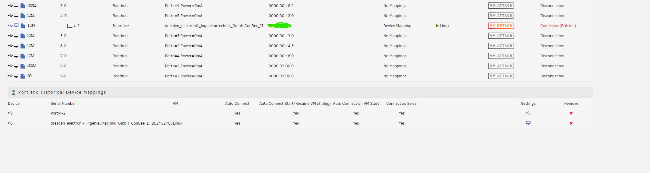

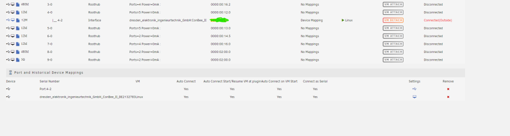

  11. I think I have followed your instructions to the letter. This is the result in HA But when I try to reconfigure my antenna path: /dev/serial/by-id/usb-QEMU_QEMU_USB_SERIAL_1-0000:00:07.7-4-if00-port0 And this is the usb manger: Anything I could be missing? I would hate to have to reset the entire network. Errors when trying to setup: 2024-04-12 08:56:33.369 DEBUG (MainThread) [zigpy.application] Failed to probe with config {'path': '/dev/serial/by-id/usb-QEMU_QEMU_USB_SERIAL_1-0000:00:07.7-4-if00-port0', 'baudrate': 38400, 'flow_control': 'hardware'} Traceback (most recent call last): File "/usr/local/lib/python3.12/site-packages/zigpy_deconz/api.py", line 589, in _command return await fut ^^^^^^^^^ asyncio.exceptions.CancelledError The above exception was the direct cause of the following exception: Traceback (most recent call last): File "/usr/local/lib/python3.12/site-packages/zigpy/application.py", line 631, in probe await app.connect() File "/usr/local/lib/python3.12/site-packages/zigpy_deconz/zigbee/application.py", line 97, in connect await api.connect() File "/usr/local/lib/python3.12/site-packages/zigpy_deconz/api.py", line 466, in connect await self.version() File "/usr/local/lib/python3.12/site-packages/zigpy_deconz/api.py", line 813, in version self._protocol_version = await self.read_parameter( ^^^^^^^^^^^^^^^^^^^^^^^^^^ File "/usr/local/lib/python3.12/site-packages/zigpy_deconz/api.py", line 832, in read_parameter rsp = await self.send_command( ^^^^^^^^^^^^^^^^^^^^^^^^ File "/usr/local/lib/python3.12/site-packages/zigpy_deconz/api.py", line 508, in send_command return await self._command(cmd, **kwargs) ^^^^^^^^^^^^^^^^^^^^^^^^^^^^^^^^^^ File "/usr/local/lib/python3.12/site-packages/zigpy_deconz/api.py", line 588, in _command async with asyncio_timeout(COMMAND_TIMEOUT): File "/usr/local/lib/python3.12/asyncio/timeouts.py", line 115, in __aexit__ raise TimeoutError from exc_val TimeoutError
  12. I have tried this but it still wont configure ZHA. My settings I couldn't figure outif i should setup the usb icon or the screen icon. Both have the same values. With Connect as Serial Guest Port Number: 4 Then vm xaml: <serial type='dev'> <source path='/dev/serial/by-id/usb-dresden_elektronik_ingenieurtechnik_GmbH_ConBee_II_DE2132783-if00'/> <target type='usb-serial' port='4'> <model name='usb-serial'/> </target> <alias name='serial1'/> <address type='usb' bus='0' port='4'/> </serial> <serial type='dev'> <source path='/dev/serial/by-id/usb-dresden_elektronik_ingenieurtechnik_GmbH_ConBee_II_Dxxxxxf00'/> <target type='usb-serial' port='4'> <model name='usb-serial'/> </target> <alias name='serial1'/> <address type='usb' bus='0' port='4'/> </serial> Not 100% sure which port to use for target and adress. In home assistant HA finds: /dev/ttyUSB0 - QEMU USB SERIAL, s/n: 1-0000:00:07.7-4 - QEMU Not sure if it is the correct thing but it does not work at least. Aything obvious error I make? Btw is the "USB manager hotplug" part of usb manager, I saw a reference of someone "removing it" but I can't find it as a separate plugin I have installed:
  13. I have just received a LSI HBA card. https://www.ebay.com/itm/195577459212 However, one of the ports broke from the card on first usage ... How can I see if it could actually work. I have plugged it in and connected 2 sata drives. The card: Uploaded diagnostics bovallstation-diagnostics-20230726-1227.zip
  14. Thank you. It seems to be working now. Is there a way to actually see the mapped name in Unraid. I mean home assistant could find the tricky name /dev/serial/by-id/usb-QEMU_QEMU_USB_SERIAL_1-0000:00:07.7-4-if00-port0 but if I go to command-line in unraid I will only see /dev/serial/by-id/usb-dresden_elektronik_ingenieurtechnik_GmbH_ConBee_II_DE2132783-if00 I have also tried a reboot fully of the system now so that was awesome (last time I had a power outage and stuff stopped working)
