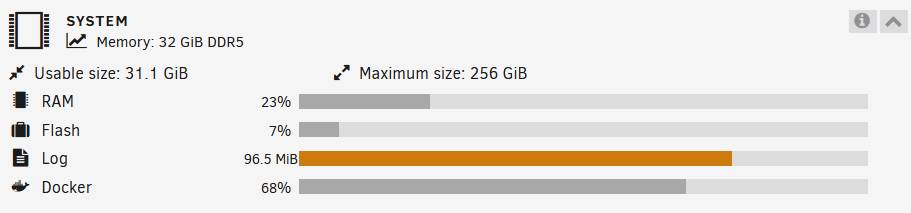

  1. I disconnected the video cable that feeds my video sender and the logs have seemed to stop. Thanks for helping me look in the right direction. Kinda wish the xorg log file was part of the diag files.
  2. @JorgeB See the results below. Looks like its the Xorg log and when i checked the contents it is full of this modeset modeline entries. I do not have a dedicated graphics card, and i believe i have a remote video sender connected to it but i am guessing these messages mean that the connection is going in and out? du -h /var/log 0 /var/log/pwfail 0 /var/log/swtpm/libvirt/qemu 0 /var/log/swtpm/libvirt 0 /var/log/swtpm 0 /var/log/samba/cores/rpcd_winreg 0 /var/log/samba/cores/rpcd_classic 0 /var/log/samba/cores/rpcd_lsad 0 /var/log/samba/cores/samba-dcerpcd 0 /var/log/samba/cores/winbindd 0 /var/log/samba/cores/nmbd 0 /var/log/samba/cores/smbd 0 /var/log/samba/cores 1.4M /var/log/samba 0 /var/log/sa 0 /var/log/plugins 0 /var/log/pkgtools/removed_uninstall_scripts 0 /var/log/pkgtools/removed_scripts 8.0K /var/log/pkgtools/removed_packages 8.0K /var/log/pkgtools 4.0K /var/log/nginx 0 /var/log/nfsd 32K /var/log/libvirt/qemu 0 /var/log/libvirt/ch 36K /var/log/libvirt 103M /var/log ls -lh /var/log total 102M -rw-r--r-- 1 root root 101M Sep 14 09:34 Xorg.0.log -rw-r--r-- 1 root root 85 Sep 14 04:40 apcupsd.events -rw-r--r-- 1 root root 405 Sep 14 04:40 apcupsd.events.1 -rw-r--r-- 1 root root 193 Sep 7 04:40 apcupsd.events.2 -rw------- 1 root root 0 Nov 27 2023 btmp -rw-r--r-- 1 root root 0 Apr 28 2021 cron -rw-r--r-- 1 root root 0 Apr 28 2021 debug -rw-r--r-- 1 root root 503 Sep 4 21:32 dhcplog -rw-r--r-- 1 root root 65K Sep 4 21:31 dmesg -rw-r--r-- 1 root root 6.6K Sep 14 04:14 docker.log -rw-r--r-- 1 root root 0 Feb 13 2021 faillog -rw-r--r-- 1 root root 0 Apr 7 2000 lastlog drwxr-xr-x 4 root root 140 Sep 4 21:33 libvirt/ -rw-r--r-- 1 root root 775 Sep 5 08:19 maillog -rw-r--r-- 1 root root 0 Sep 4 21:32 mcelog -rw-r--r-- 1 root root 0 Apr 28 2021 messages drwxr-xr-x 2 root root 40 Aug 10 2022 nfsd/ drwxr-x--- 2 nobody root 60 Sep 4 21:32 nginx/ lrwxrwxrwx 1 root root 24 Nov 27 2023 packages -> ../lib/pkgtools/packages/ drwxr-xr-x 5 root root 100 Sep 5 21:20 pkgtools/ drwxr-xr-x 2 root root 180 Sep 5 21:20 plugins/ drwxr-xr-x 2 root root 40 Sep 14 09:32 pwfail/ lrwxrwxrwx 1 root root 25 Nov 27 2023 removed_packages -> pkgtools/removed_packages/ lrwxrwxrwx 1 root root 24 Nov 27 2023 removed_scripts -> pkgtools/removed_scripts/ lrwxrwxrwx 1 root root 34 Sep 5 21:20 removed_uninstall_scripts -> pkgtools/removed_uninstall_scripts/ drwxr-xr-x 2 root root 40 Jan 30 2023 sa/ drwxr-xr-x 3 root root 320 Sep 4 21:32 samba/ lrwxrwxrwx 1 root root 23 Nov 27 2023 scripts -> ../lib/pkgtools/scripts/ -rw-r--r-- 1 root root 0 Apr 28 2021 secure lrwxrwxrwx 1 root root 21 Nov 27 2023 setup -> ../lib/pkgtools/setup/ -rw-r--r-- 1 root root 0 Apr 28 2021 spooler drwxr-xr-x 3 root root 60 Sep 27 2022 swtpm/ -rw-r--r-- 1 root root 163K Sep 14 09:32 syslog -rw-r--r-- 1 root root 3.0K Sep 14 09:30 tailscale-utils.log -rw-r--r-- 1 root root 694 Sep 14 04:30 tailscale-utils.log.1.gz -rw-r--r-- 1 root root 697 Sep 13 04:30 tailscale-utils.log.2.gz -rw-r--r-- 1 root root 698 Sep 12 04:30 tailscale-utils.log.3.gz -rw-r--r-- 1 root root 689 Sep 11 04:30 tailscale-utils.log.4.gz -rw-r--r-- 1 root root 0 Sep 14 04:40 tailscale.log -rw-r--r-- 1 root root 752 Sep 13 23:50 tailscale.log.1.gz -rw-r--r-- 1 root root 2.3K Sep 13 04:16 tailscale.log.2.gz -rw-r--r-- 1 root root 901 Sep 11 17:33 tailscale.log.3.gz -rw-r--r-- 1 root root 1.3K Sep 11 00:43 tailscale.log.4.gz -rw-r--r-- 1 root root 0 Sep 4 21:30 vfio-pci -rw-r--r-- 1 root root 0 Sep 4 21:30 vfio-pci-errors -rw-r--r-- 1 root root 1.8K Sep 9 07:38 wg-quick.log -rw-rw-r-- 1 root utmp 7.5K Sep 4 21:32 wtmp XORG: [ 4415.258] (II) modeset(0): Modeline "1920x1080"x0.0 148.50 1920 2008 2052 2200 1080 1084 1089 1125 +hsync +vsync (67.5 kHz eP) [ 4415.258] (II) modeset(0): Modeline "2560x1440"x0.0 119.00 2560 2608 2640 2720 1440 1443 1448 1461 +hsync +vsync (43.8 kHz e) [ 4415.258] (II) modeset(0): Modeline "2560x1600"x0.0 132.25 2560 2608 2640 2720 1600 1603 1609 1623 +hsync +vsync (48.6 kHz e) [ 4415.258] (II) modeset(0): Modeline "3840x2160"x0.0 262.75 3840 3888 3920 4000 2160 2163 2168 2191 +hsync +vsync (65.7 kHz e) [ 4415.258] (II) modeset(0): Modeline "1920x1080i"x0.0 74.25 1920 2008 2052 2200 1080 1084 1094 1125 interlace +hsync +vsync (33.8 kHz e) [ 4415.258] (II) modeset(0): Modeline "1280x720"x0.0 74.25 1280 1720 1760 1980 720 725 730 750 +hsync +vsync (37.5 kHz e) [ 4415.258] (II) modeset(0): Modeline "640x480"x0.0 25.18 640 656 752 800 480 490 492 525 -hsync -vsync (31.5 kHz e) [ 4415.258] (II) modeset(0): Modeline "720x480"x0.0 27.00 720 736 798 858 480 489 495 525 -hsync -vsync (31.5 kHz e) [ 4415.258] (II) modeset(0): Modeline "720x576"x0.0 27.00 720 732 796 864 576 581 586 625 -hsync -vsync (31.2 kHz e) [ 4415.258] (II) modeset(0): Modeline "1920x1080i"x0.0 74.25 1920 2448 2492 2640 1080 1084 1094 1125 interlace +hsync +vsync (28.1 kHz e) [ 4415.258] (II) modeset(0): Modeline "1920x1080"x0.0 148.50 1920 2448 2492 2640 1080 1084 1089 1125 +hsync +vsync (56.2 kHz e) [ 4415.258] (II) modeset(0): Modeline "1280x720"x0.0 74.25 1280 1390 1430 1650 720 725 730 750 +hsync +vsync (45.0 kHz e) [ 4415.258] (II) modeset(0): Modeline "800x600"x0.0 40.00 800 840 968 1056 600 601 605 628 +hsync +vsync (37.9 kHz e) [ 4415.258] (II) modeset(0): Modeline "800x600"x0.0 36.00 800 824 896 1024 600 601 603 625 +hsync +vsync (35.2 kHz e) [ 4415.258] (II) modeset(0): Modeline "640x480"x0.0 31.50 640 656 720 840 480 481 484 500 -hsync -vsync (37.5 kHz e) [ 4415.258] (II) modeset(0): Modeline "640x480"x0.0 31.50 640 664 704 832 480 489 492 520 -hsync -vsync (37.9 kHz e) [ 4415.258] (II) modeset(0): Modeline "640x480"x0.0 30.24 640 704 768 864 480 483 486 525 -hsync -vsync (35.0 kHz e) [ 4415.258] (II) modeset(0): Modeline "720x400"x0.0 28.32 720 738 846 900 400 412 414 449 -hsync +vsync (31.5 kHz e) [ 4415.258] (II) modeset(0): Modeline "1280x1024"x0.0 135.00 1280 1296 1440 1688 1024 1025 1028 1066 +hsync +vsync (80.0 kHz e) [ 4415.258] (II) modeset(0): Modeline "1024x768"x0.0 78.75 1024 1040 1136 1312 768 769 772 800 +hsync +vsync (60.0 kHz e) [ 4415.258] (II) modeset(0): Modeline "1024x768"x0.0 75.00 1024 1048 1184 1328 768 771 777 806 -hsync -vsync (56.5 kHz e) [ 4415.258] (II) modeset(0): Modeline "1024x768"x0.0 65.00 1024 1048 1184 1344 768 771 777 806 -hsync -vsync (48.4 kHz e) [ 4415.258] (II) modeset(0): Modeline "832x624"x0.0 57.28 832 864 928 1152 624 625 628 667 -hsync -vsync (49.7 kHz e) [ 4415.258] (II) modeset(0): Modeline "800x600"x0.0 49.50 800 816 896 1056 600 601 604 625 +hsync +vsync (46.9 kHz e) [ 4415.258] (II) modeset(0): Modeline "800x600"x0.0 50.00 800 856 976 1040 600 637 643 666 +hsync +vsync (48.1 kHz e) [ 4415.258] (II) modeset(0): Modeline "1152x864"x0.0 108.00 1152 1216 1344 1600 864 865 868 900 +hsync +vsync (67.5 kHz e) [ 4415.258] (II) modeset(0): Modeline "1280x960"x0.0 108.00 1280 1376 1488 1800 960 961 964 1000 +hsync +vsync (60.0 kHz e) [ 4415.258] (II) modeset(0): Modeline "1280x1024"x0.0 108.00 1280 1328 1440 1688 1024 1025 1028 1066 +hsync +vsync (64.0 kHz e) [ 4415.258] (II) modeset(0): Modeline "1280x800"x0.0 71.00 1280 1328 1360 1440 800 803 809 823 +hsync -vsync (49.3 kHz e) [ 4415.258] (II) modeset(0): Modeline "1680x1050"x0.0 119.00 1680 1728 1760 1840 1050 1053 1059 1080 +hsync -vsync (64.7 kHz e) [ 4415.258] (II) modeset(0): Modeline "1440x900"x0.0 88.75 1440 1488 1520 1600 900 903 909 926 +hsync -vsync (55.5 kHz e) [ 4415.259] (--) modeset(0): HDMI max TMDS frequency 300000KHz [ 4448.474] (II) modeset(0): EDID vendor "HRI", prod id 256 [ 4448.474] (II) modeset(0): Using hsync ranges from config file [ 4448.474] (II) modeset(0): Using vrefresh ranges from config file [ 4448.474] (II) modeset(0): Printing DDC gathered Modelines:
  3. Hello! My Log size has been getting full, in the diagnostics folder, none of the log files are anywhere near the 96 megabytes that unraid is reporting the logs are using. Any help would be appreciated. I'd assume that something in this diagnostics folder would match the log size. gordo-diagnostics-20250913-1949.zip
