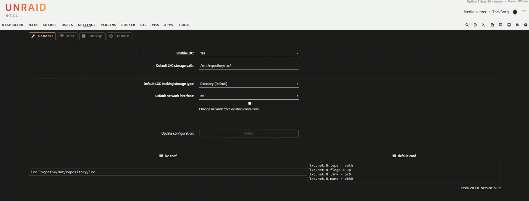

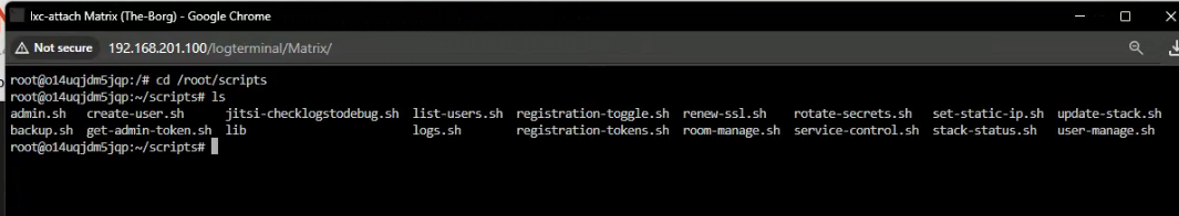

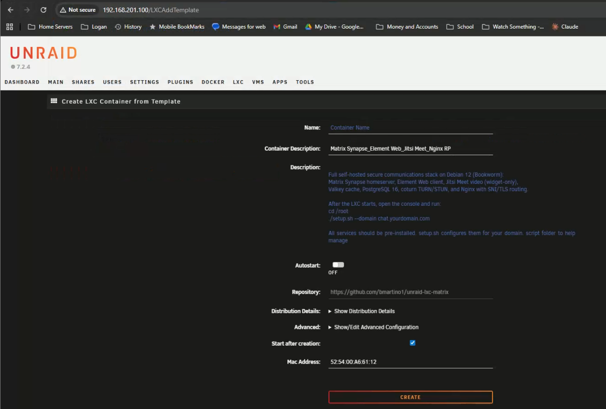

  1. I've completed the lxc version for better contorl full env setup and ease of access. https://github.com/bmartino1/unraid-lxc-matrix this project requires ich777 lxc plugin installed. enable anc configure the volume path This is akin to the appdata folder where the sytem lives... this is akin to a VM but closer to a docker given the continer setup and enviroment.... Unraid Installation Step 1 --- Download the LXC TemplateOpen a terminal on your Unraid server and run: wget -O /tmp/lxc_container_template.xml \ https://raw.githubusercontent.com/bmartino1/unraid-lxc-matrix/main/lxc_container_template.xmlStep 2 --- Import the Template/LXCAddTemplate Open the Unraid LXC template page: http://<Your_UnRAID_IP>/LXCAddTemplate Example: http://192.168.1.10/LXCAddTemplate Unraid will automatically detect the downloaded template. Give the continer a name example matrix. Click create and wait for the done button. Then open the terminal then run the scirpts in this order /root/scripts/set-static-ip.shYou MUST SET A STATIC IP! ⚠️ After setting the static IP, fully stop and start the LXC (do not just restart). The new IP will not take effect until a full stop/start cycle. stop the lxc start the lxc * You may need to scroll down for the menu to apear... If you do't stop start you willhave the dhcp ip and static ip and script will not run coreclty... /root/scripts/set-static-ip.shYou MUST SET A STATIC IP! open prot forwarding to 443 and 80 for nginx to teh static ip then set dns record to the bulic ip this will be your domain. *I was able to use free affraid dns https://freedns.afraid.org/ free teer all 5 sub domains... then run the setup script. /root/setup.sh --domain chat.yourPublicdomain.com --admin-pass ChangeMethen 2 side scirpts to have admin script work #Some admin script require teh admin token to do things,,, /root/scripts/get-admin-token.sh #adds token to matrix.env for scritps... #Patch Nginx TO secure jitsu meet public so all things behind nginx RP cd /root/ && wget https://raw.githubusercontent.com/bmartino1/unraid-lxc-matrix/refs/heads/main/patch.sh chmod +x /root/patch.sh /root/patch.sh see WIP admin scritpt testing https://github.com/bmartino1/unraid-lxc-matrix/blob/main/WIP-Notes-Updates.txt Then run the admin scirpt admin consle to make users enable site registration and enjoy... /root/scripts/admin.sh Many Thanks To @ich777 with ich777 for ther OG assistance on a LXC templte in the past... and Many thanks to Adam for ther intal script to get the project started and functional! I also Can't stress on readiing the documentation! Synapse (Matrix homeserver): https://matrix-org.github.io/synapse/latest/ Element Web config: https://github.com/element-hq/element-web/blob/develop/docs/config.md Jitsi Self-Hosting: https://jitsi.github.io/handbook/docs/devops-guide/devops-guide-docker Coturn: https://github.com/coturn/coturn/wiki/turnserver Matrix federation tester: https://federationtester.matrix.org/

  3. Thought I give a side update... as I pushed the edits and scripting as far as I could... I kinda gave up on the docker compose setup side of it due to issues configuring and geting the RP to play nice... so I went the other direction... LXC Since I run PVE I tired my hands at a semi pre built LXC... Using that for inspiration after geting the LXC fully Functional... I copleted this https://github.com/bmartino1/unraid-lxc-matrix and made a ich777 lxc template. and spent more of my time building the admin helper interface... I've compelted this as far as I'm willing to go as iit only requireees port 443 and port 80 pointed to teh lxc IP for a functiinoal matrix, cotrun, element, jitsuii setup. *you can edit the nginx cofg and secure it further then I did. while only needing 2 ports. meet.domain_name is still exposed. On my PVE i was able to configure it to public 403 blocked but lgoined in users Private full access to jitsu... given the run around and documentations that go over reverse proxies. and workign with another whos been runnign matrix for many years with there assistnce we are happy to present matrix synapse the unraid LXC...

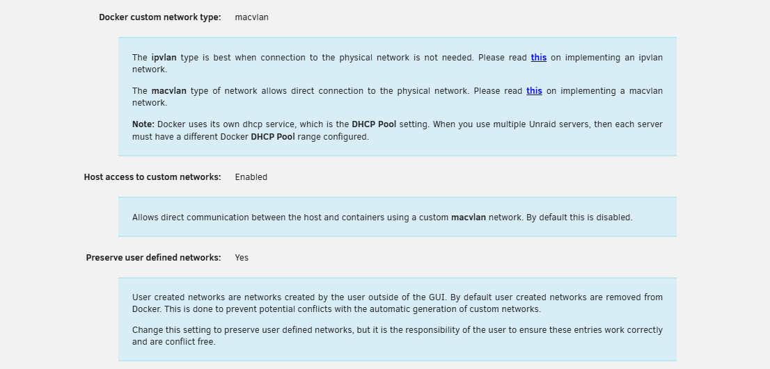

  5. Due to a bug: https://product.unraid.net/p/muti-nic-macvlan-host-enabled-relapse-ip-added-docker-rc-script-issue I still don’t know how to reporduce on other systems… But inteh event other users experience this bug too... The Fix You need to either clear the statics.ini entry before flushing, or increase the sleep enough to ensure docker hasn't fired yet (fragile). The clean approach is to add the statics.ini removal to your user script: bash #!/bin/bash sleep 20 # Wait for docker services to start # Remove the statics.ini entry so the monitor doesn't fight us sed -i '/^shim-br0 .*/d' /var/local/emhttp/statics.ini # Also create the .down sentinel to suppress the monitor touch /var/tmp/shim-br0.down # Bring interface down ip link set shim-br0 down # Remove all existing IPs ip addr flush dev shim-br0 # Set static IP ip addr add 192.168.2.247/24 dev shim-br0 ip link set shim-br0 up # Re-register our desired IP back into statics.ini so it survives future docker restarts rm -f /var/tmp/shim-br0.downThe sed removes the .248 entry from statics.ini before the flush, so the monitor has nothing to restore. The touch /var/tmp/shim-br0.down is an extra belt-and-suspenders sentinel that some versions of the monitor check before acting. runnign this in stead seems to restore the static set on this sytem… How I under stand it for the root cause: Root Cause: Race Between Your User Script and Unraid's statics.ini Monitor There are two separate things adding IPs to shim-br0, and they're fighting each other. The Sequence of Events14:45:51 — Unraid fires your user scripts in the background, including vhost-shimbridge-unifi fix (which has a sleep 20 inside it) 14:45:54 — rc.docker start fires 14:45:58 — rc.docker creates shim-br0, and adds 192.168.2.248/24 to it. Critically, it also calls add_entry "shim-br0 192.168.2.248/24 metric 0" — which appends a line to /var/local/emhttp/statics.ini ~14:46:11 — Your user script wakes from sleep 20 and does: ip link set shim-br0 down → ip addr flush dev shim-br0 → ip addr add 192.168.2.247/24 dev shim-br0 → ip link set shim-br0 up Almost immediately — Unraid's background monitor+ process (the statics.ini watcher, pids 2581/2591 visible in your top) detects that 192.168.2.248/24 is missing from shim-br0 and re-adds it — but now as a secondary address on top of your .247 The result: .247 is primary (your script), .248 is secondary (the monitor restored it). Why This Only Affects This Systemdel_entry() in rc.docker does two things: it creates a .down sentinel file AND removes the entry from statics.ini. Your raw ip addr flush does neither — it just yanks the IP off the interface without telling the monitor. On other Unraid systems, you're presumably running the user script as the only thing managing shim-br0, but here DOCKER_ALLOW_ACCESS=yes with a br type network causes rc.docker to both create the shim and register it in statics.ini.

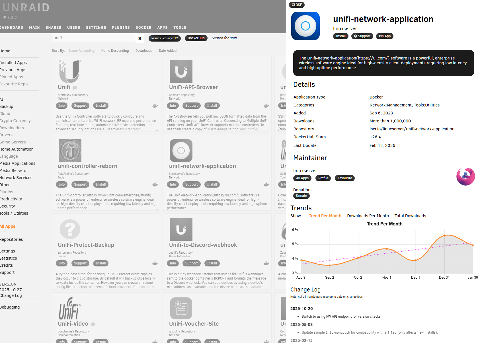

  13. No a dumb quesiotn but in the wrong area asking for thiis kiind of support... this is what the linux server does and can be acomplised using docker compose... https://hub.docker.com/r/linuxserver/unifi-network-application https://docs.linuxserver.io/images/docker-unifi-network-application/ There is also a differnet support area onteh unraid form for this as well.. and I've done what I could to assint useres wanting a CA unraid install vareint seen here: https://forums.unraid.net/topic/78060-support-linuxserverio-unifi-controller/page/56/#findComment-1326226 on that supoprt fourm side... as its is issues withteh mongo db setup and its creation... the issues was users had issues seting up mongdb that was requried with the use of the compose file thuis this docker that combines them as a All in one... using the linux server docs. (even thogh this should be on that support side... here is an example compse alternative.. Step 1 — Create the init script first Save this as /mnt/user/appdata/unifi-db/init-mongo.sh on your Unraid server: #!/bin/bash if which mongosh > /dev/null 2>&1; then mongo_init_bin='mongosh' else mongo_init_bin='mongo' fi "${mongo_init_bin}" <<EOF use admin db.auth("root", "${MONGO_INITDB_ROOT_PASSWORD}") db.createUser({ user: "${MONGO_USER}", pwd: "${MONGO_PASS}", roles: [ { db: "${MONGO_DBNAME}", role: "dbOwner" }, { db: "${MONGO_DBNAME}_stat", role: "dbOwner" }, { db: "${MONGO_DBNAME}_audit", role: "dbOwner" } ] }) EOFThen make it executable: chmod +x /mnt/user/appdata/unifi-db/init-mongo.sh Step 2 — The docker-compose file --- services: unifi-db: image: docker.io/mongo:7 container_name: unifi-db environment: - MONGO_INITDB_ROOT_USERNAME=root - MONGO_INITDB_ROOT_PASSWORD=yourRootPassword # change this - MONGO_USER=unifi - MONGO_PASS=yourUnifiPassword # change this - MONGO_DBNAME=unifi - MONGO_AUTHSOURCE=admin volumes: - /mnt/user/appdata/unifi-db/data:/data/db - /mnt/user/appdata/unifi-db/init-mongo.sh:/docker-entrypoint-initdb.d/init-mongo.sh:ro restart: unless-stopped unifi-network-application: image: lscr.io/linuxserver/unifi-network-application:latest container_name: unifi-network-application depends_on: - unifi-db environment: - PUID=99 # Unraid's nobody user - PGID=100 # Unraid's users group - TZ=America/New_York # change to your timezone - MONGO_USER=unifi - MONGO_PASS=yourUnifiPassword # must match above - MONGO_HOST=unifi-db - MONGO_PORT=27017 - MONGO_DBNAME=unifi - MONGO_AUTHSOURCE=admin - MEM_LIMIT=1024 - MEM_STARTUP=1024 volumes: - /mnt/user/appdata/unifi-network-application:/config ports: - 8443:8443 # Web UI (https) - 3478:3478/udp # STUN - 10001:10001/udp # AP discovery - 8080:8080 # Device communication (do NOT change) - 1900:1900/udp # L2 discovery (optional) - 8843:8843 # Guest portal HTTPS (optional) - 8880:8880 # Guest portal HTTP (optional) - 6789:6789 # Mobile speed test (optional) restart: unless-stopped*THis doen't have the ui stack forthe icon nor adatianl label as i dont' want to get off suport topinc for this are...a A few Unraid-specific notes: PUID=99 / PGID=100 are Unraid's standard nobody/users — this avoids permission headaches with appdata shares. Pin MongoDB to a major version (e.g., mongo:7) — never use latest since Mongo doesn't support auto-upgrades between major versions. The init-mongo.sh only runs on the very first start with a clean /data/db. If you've already run the MongoDB container without it, you'll need to delete the data folder and start fresh. After everything is up, the UI is at https://your-unraid-ip:8443. For device adoption, go to Settings > System > Advanced and set the Inform Host to your Unraid server's IP. Please use the other support area for that setup... Thsi is the suport area for: Ultimately with teh unif capabilitet to run the consol os (which runs superviosr docker and podman... I would run teh full consoel os (In a VM) per ealier post https://forums.unraid.net/topic/147455-support-unifi-controller-unifi-unraid-reborn/page/35/#findComment-1608639
