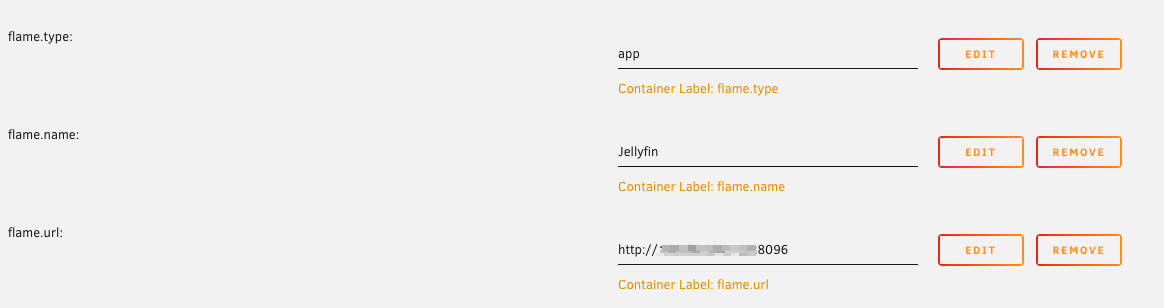

  3. I had this problem too. What you need to do is add certain labels to your Docker containers. See the attached for an example one for Jellyfin. I had to add these labels to all my containers for it to work--even if the containers didn't have a Webui. Once I added all these labels, Flame populated automatically without any errors. It also seems I didn't have to add these for new containers. Flame would work without them being added. But if you want them to show up in Flame, you have to add these labels to new containers.

  5. This helped me too, thanks! Maybe it should be added to the instructions?
