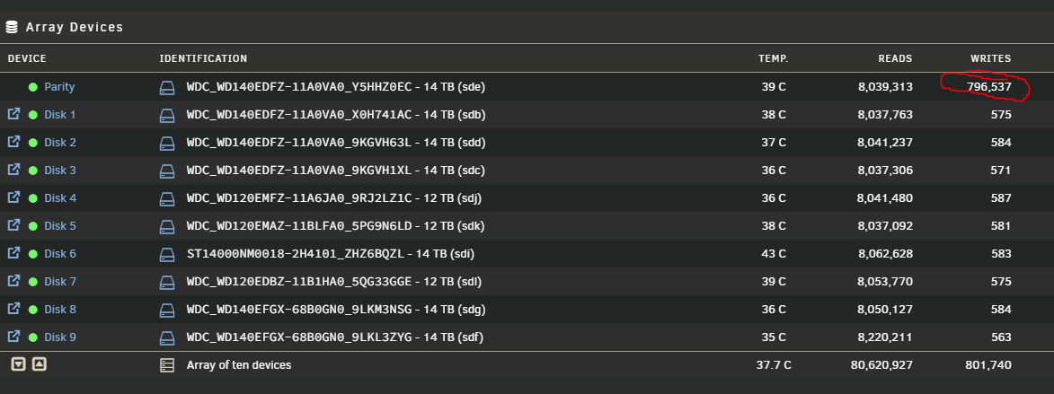

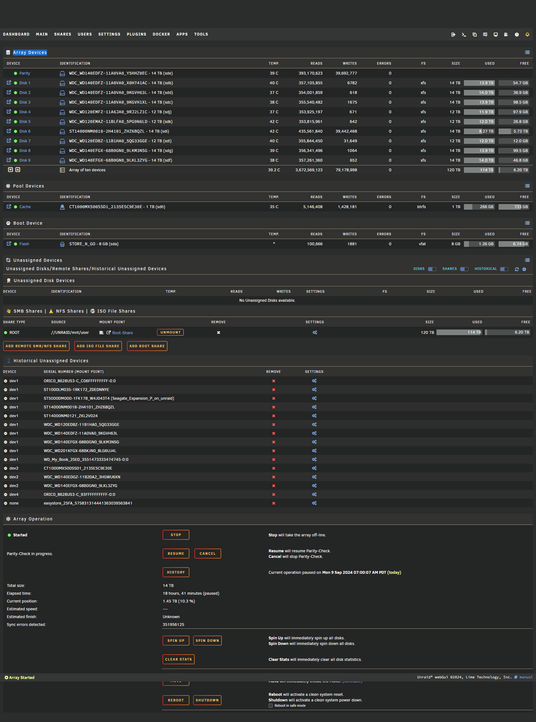

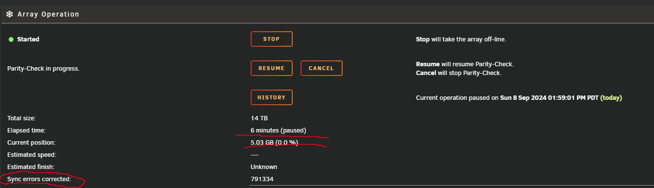

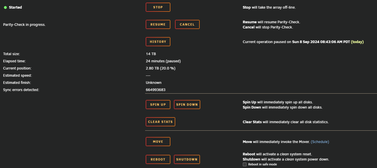

(SOLVED) 600k Sync Errors detected after replacing a failing disk
Update on this. This all happened due to a loose SATA cable to the motherboard. I was able to copy old disk 6 to new disk 6 using rsync, and my server is back. Currently correcting parity.
I did not manually initiate a parity check, but I do have scheduled parity check every night between 2-7AM. However, my screenshot shows elapsed time of 24 minutes, so that does not add up. Please see the uncropped screenshot attached, this should help identify if new disk is unmountable or not. Do you see any potential issues for the below plan? Plan C (plan B but steps rearranged) 1.) Stop array and reformat new disk 6 2.) Shut down server and attach old disk 6 3.) Power on server, Stop array. Copy old disk 6 to new disk 6. 4.) Shut down server, remove old disk 6 5.) Power on server. Choose new disk 6 manually if required and start array. 6.) Run corrective parity check to fix rebuild parity drive. Edit: In step 3 to copy and check, use rsync command via the terminal. Thanks again Kilrah.
Hi Kilrah, Thank you for the response. Are you referring to screenshot from the original post or the screenshots from the follow up post? In the original post, the data has been fully rebuilt onto disk 6. I only noticed there was a lot of sync error in the main page as indicated in the first post screenshot, and new disk 6 has very high raw value (21475164165) of 188 command timeout. This can be confirmed in the diagnostics. After I rebooted the system. I cancelled the parity check because I want to start checking from 0%. I probably missed unchecking the "write correction to parity disk" and started parity check. Then it wrote the corrections to my parity disk. I believe this is data loss as I assume the data from disk 6 is incorrect. I noticed I screwed up after a couple of minutes in, I paused the parity check. Based on second post screenshot, I believe I am 5.03gb in so far. Therefore I think using old disk 6 to rebuild parity would mean less write to the parity, compared to letting the current parity finish (using the corrupt? data from disk 6). There has been minor data changes between when I took old disk 6 out to now, would this cause major issues to the overall array? Or it would only mean I lose the data between when I took disk 6 offline to now? Here is my plan, please let me know if these steps are correct Plan A: 1.)Cancel parity check 2.)Shutdown server 3.)Replace new disk 6 with old disk 6 4.)Boot server and run corrective parity check (This should write the correct data back to parity disk) 5.)After rebuilding/corrective parity write done, shutdown server. 6.)Replace old disk 6 with new disk 6 7.)Reformat new disk 6 8.)Use dropdown menu to select newly formatted disk 6 as part of the array and rebuild. Or Plan B: 1.) Run the corrective parity rebuild as suggested. This will use the corrupted new disk 6 data to overwrite parity. 2.) Mount old disk 6 as unassigned disk. 3.) Stop array and reformat new disk 6 4.) Copy old disk 6 to new disk 6 Wouldn't this require another parity rebuild as disk 6 data would have been changed. Is plan B a higher risk approach if my old disk 6 fails? This is because I am overwriting 100% of my parity disk with corrupted disk 6 first. Thanks!
I have shutdown my server, connected disk 6 to another set of Sata Power cable and sata data cable. After starting the array, I resumed the partiy check from 20%, and did not get any sync errors. It reset to 0 as I rebooted the server. I was still unable to navigate to certain folders on the array. I then cancel the parity-check so it starts from 0% rather than 20%. As soon as parity check starts checking at 0%, there is a high number of sync errors 791334 CORRECTED (not detected), I hit pause. I believe I overwrite the error checks into my parity, and may have caused some data loss (it ran for a couple of minutes) I am lost on what to do next to prevent further dataloss. Should I replace new disk 6 with old disk 6 and rebuild parity? Ensure to check correct data correction, so Unraid writes to parity. The old disk may have enough life left to do that. Then reformat new disk 6 and rebuild new disk 6 using now intact parity.
Hi everyone, My old disk 6 (8tb) was failing so I replaced it with a new precleared (14tb) disk. The new disk precleared without errors. Here are the steps I did. 1.) preclear replacement disk 2.) shutdown server 3.) replace data drive with new precleared drive 4.) start server 5.) server detects missing disk, select new disk in drop down 6.) start array 7.) rebuild I am unable to access some folders as they appear to be 0kb, then I noticed there's 600k sync error detected and disk 6 (new disk) shows very high raw value (21475164165) of 188 command timeout. Please see the attached diagnostics, any help is much appreciated! unraid-diagnostics-20240908-0858.zip

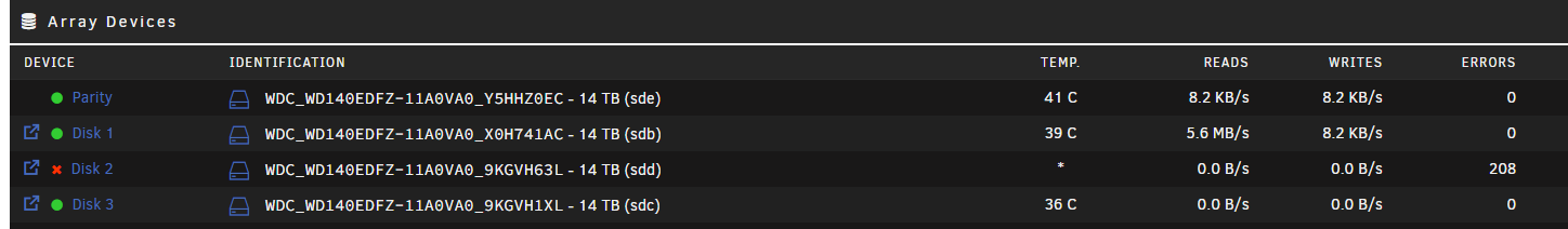

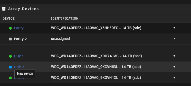

[6.12.6] DISK2 has read errors to DISK 2 Not installed - Disk failed?
Finished rebuilding disk 2 with no errors. Marked post as solved, thank you!
Update - After 26 hours of extended self test it's still at 90%. I disabled disk 2 and started the array, which stopped the extended self test. I checked the emulated disk and found data was intact. I then started rebuilding the array without preclearing disk 2.
Thanks JorgeB. When you say the disk got disabled, are you referring to a write failure or the fact that the disk was "offline" while array was running and therefore it's not longer in sync and required rebuilding? Do you think it's worthwhile waiting for the SMART extending self test to complete? The recommended polling time for extended is 1498 mins, but google suggest others have taken significantly more time (4days?) for a 14 tb, and some have gotten stuck. Do you see any error from the short self test and can I stop the extended test? Then unassign disk 2 and start array, check contents as you mentioned. If contents look okay, rebuild disk 2.
Disk 2 seems to be working, SMART short self test attached. I am running a SMART extended self-test, and is at 90% for over two hours. Will upload file once complete. New diagnostics also attached. I removed disk 2 from the server case and noticed I h ad previously taped over the 3.3V Pin on the power connector as it was a shucked drive. Then I wondered if it was a issue with 3.3V pin not being isolated properly, rather than the disk physically failing. I then removed disk 3 and use its power and sata to connect to disk 2, and insert a new hard disk into disk 3's physical slot and plugged into disk 2's sata and power. I probably shouldn't have done that as I think this is what tiggered Unraid to think a new device is installed and requires a parity sync/ data-rebuild. Unraid booted fine and it recognized disk 2 and the new disk so I shut it down. I did not start the array. I then removed the new hard disk from disk 3's physical slot, and inserted back the old disk 3 and booted array fine. Now Unraid thinks that my disk 2 is a new hardware. Old configuration: unraid-diagnostics-20240216-2051.zip
