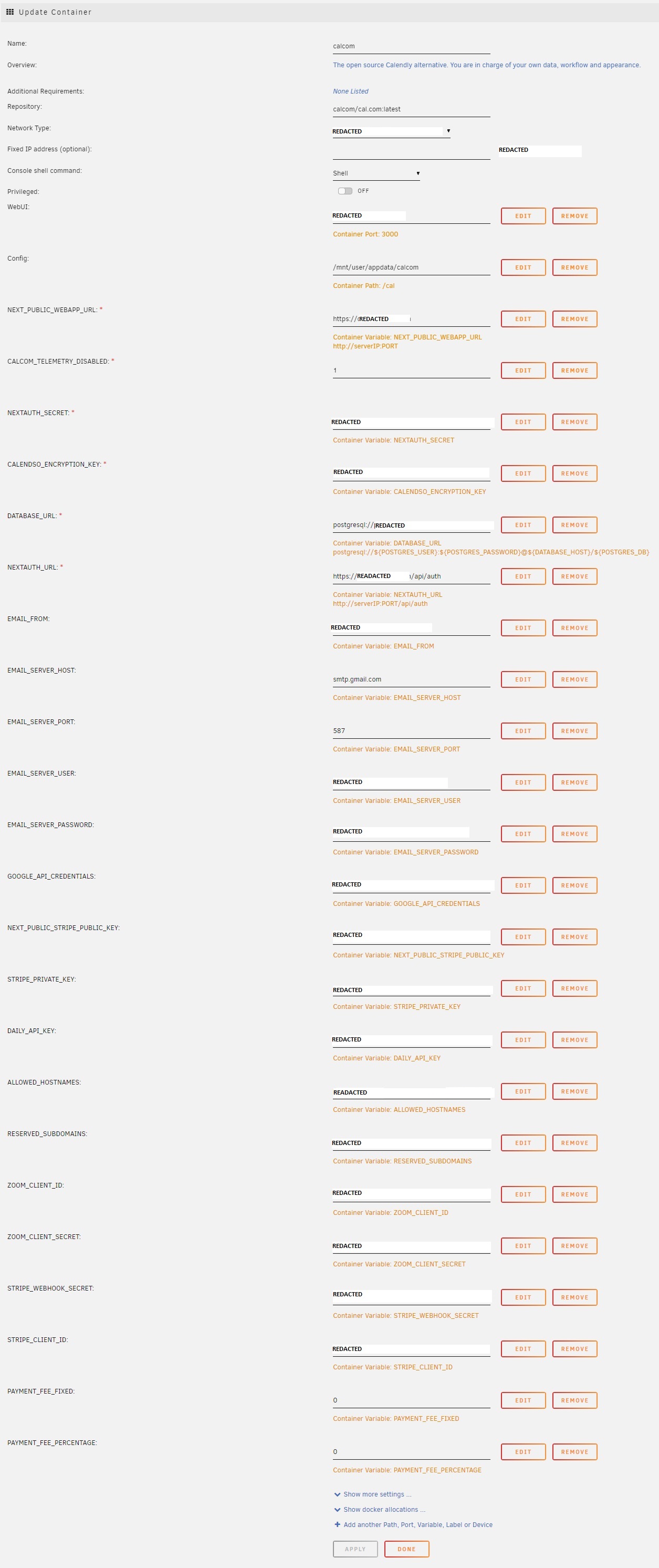

  4. Two things, there is an issue with the docker images so they are not up to date yet, but the developers are working on a solution, see details here: https://github.com/calcom/docker/issues/347 As to the syntax error, please check your variables to make sure they are correctly added. One person had a similar issue and it was an error due to the ALLOWED_HOSTNAMES variable: https://github.com/calcom/cal.com/issues/11330 You should be able to currently install up to version 3.9.1 and make sure you have the DATABASE_DIRECT_URL variable included in your configuration.
  5. Yeah I don't have giphy running on my instance, so I'm just taking guesses here on how to help. For the variables, all of mine are uniquely generated for each one. Use openssl rand -base64 32 to generate a key and add it under NEXTAUTH_SECRET. Use openssl rand -base64 32 to generate a key and add it under CALENDSO_ENCRYPTION_KEY. And then another 2 times for the following new ones: Use openssl rand -base64 32 to generate a key and add it under CALCOM_WEBHOOK_SECRET Use openssl rand -base64 24 to generate a key and add it under CALCOM_APP_CREDENTIAL_ENCRYPTION_KEY
  6. Did you upgrade the giphy api to production? See instructions here: https://developers.giphy.com/docs/api If you generated the secret keys for CALENDSO_ENCRYPTION_KEY and NEXTAUTH_SECRET correctly, maybe try this section I saw in the sample template here: # - APP CREDENTIAL SYNC *********************************************************************************** # Used for self-hosters that are implementing Cal.com into their applications that already have certain integrations # Under settings/admin/apps ensure that all app secrets are set the same as the parent application # You can use: `openssl rand -base64 32` to generate one CALCOM_WEBHOOK_SECRET="" # This is the header name that will be used to verify the webhook secret. Should be in lowercase CALCOM_WEBHOOK_HEADER_NAME="calcom-webhook-secret" CALCOM_CREDENTIAL_SYNC_ENDPOINT="" # Key should match on Cal.com and your application # must be 24 bytes for AES256 encryption algorithm # You can use: `openssl rand -base64 24` to generate one CALCOM_APP_CREDENTIAL_ENCRYPTION_KEY=""

  8. I missed a note at the end of that issue, one commenter said a new variable needs to be added now: DATABASE_DIRECT_URL="postgresql://postgres:@localhost:5450/calendso" So we need to add this and keep the duplicate DATABASE_URL in our template also. Looks like this change happened 2 weeks ago, but I haven't tested to see if this allows things to run correctly after v.3.7.11.
  9. I started experiencing issues with the database and searched for the problem. I came across this issue on github: https://github.com/calcom/docker/issues/329 The recommendation is to switch the image calcom/cal.com:latest with image: calcom/cal.com:v3.7.11 until they can figure out why the container is failing. You were right to narrow down the problem starting with version v3.7.15 and I would stick to 3.7.11 for the time being. I downgraded and zero errors in my logs now, so this should be the image to stick with while troubleshooting how to get your container running correctly.

  12. I had to redact a lot of the fields, but this is what my calcom template looks like in unRaid:
