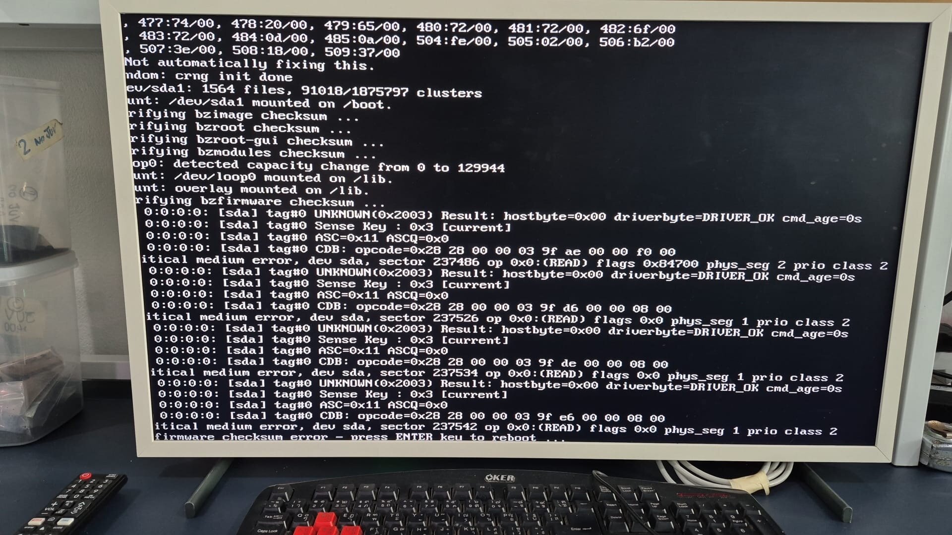

  5. I have an issue with my unraid server after a power failure and I get the firmware checksum error on boot up. I have checked the usb is OK using windows chkdsk and I have changed out the usb stick for a new one but the same problem occurs. What can I do? Cheers Maurice
