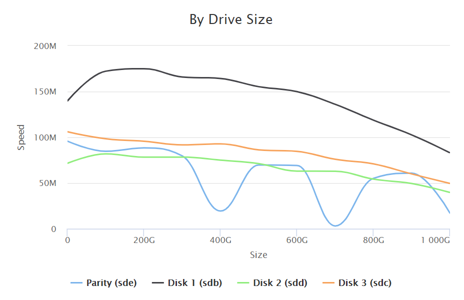

  13. @Squid, I think you're right. Thanks! I'll probably just pull the drive. Swap drive assignments (parity to be fastest) and add in a SSD cache. See if that helps with data transfer performance.
  14. I've relatively new to UNRAID and learning how to improve performance now. This utility is awesome! My server is cobbled together from old parts and I'm replacing / reassigning hardware as I can. When running a speed benchmark is there any reason the parity drive output would be expected look different than the smooth curve of the others? The array is running but there shouldn't be any data transfer or parity checks ongoing at this time. If the answer is no, then I guess I just have a really wonky drive?
