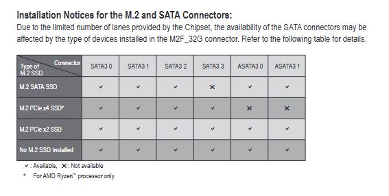

  23. Check your BIOS settings for GPU/Display/Multi Monitor/ etc, and try different choices for one that hopefully works. If no success with BIOS settings, toss any cheap GPU in the machine to make it happy. I have a Zoltac GT710 in my backup server (Ryzen 1500X) that's only there for troubleshooting. If you need buy a cheap card, a Quadro P400 can be had for less than $100 USD new, half that used. (Fun Fact: The GT 710 was the lowest capable card that Microsoft allowed one to install Windows 10. That's why I had one on hand.)
