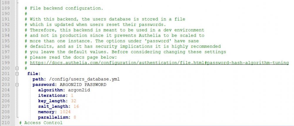

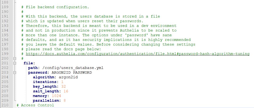

  11. Well, I got a little farther. I followed your video which made editing everything much easier! However, when I try to start Authelia I get: "Error malformed yaml: line 200: did not find expected key". The only thing at line 200 for me is a comment hashtag. Is it referring to something else?
