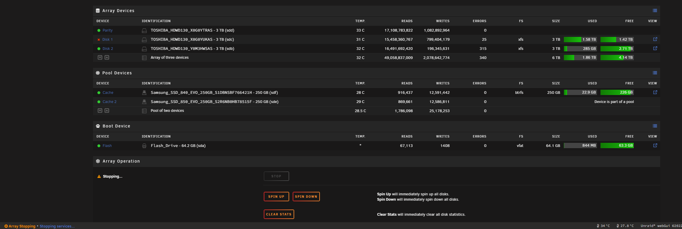

  1. Stopping array got stuck... I dont know how to proceed and I am afraid I'll lose everything. Dont have knowledge for this kind of problems. Anyone?
  2. @itimpi thank you for your help. And thank you for pointing me to the correct chapter in the documentation. I have successfully Acknowledged the CRC count. Rebuilding a drive onto itself manuals say that at step 1 you have to stop the array. I clicked on a button to stop it. Now it's been stopping it for 20 minutes and I think this should not take that long or?

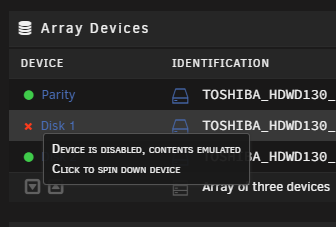

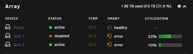

  3. Hello, it has happened to me also. "Device is disabled..." I can also see that disk 2 has error at SMART 1 more thing and i am not sure if it's connected to that problem. Docker utilization is 95%. I've also tried turning dockers off/on, it doesnt help. Can anybody please suggest what I can do? I've also attached diagnostics. thank you in advance! BR, Žiga abazuu-diagnostics-20240508-1710.zip
