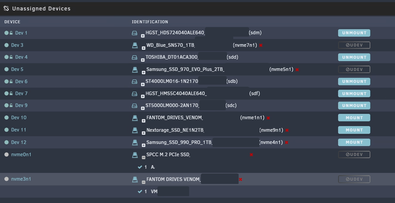

  3. Yes, I do not mount them when passing-through, I also mark them as pass-through in UD prior so I don't accidently mount and pass at the same time. I'm trying to understand, why did I need to press the two-arrow button? I thought that every time I open the MAIN tab UD does a refresh automatically, isn't that the case? What does the two-arrow button do that the MAIN tab refresh doesn't? Just trying to understand. Also, how often should I use this button? Thanks again for all the help!
  4. Ha, it was that easy? Didn't even notice the icon... It did clear up the duplicates, shows the correct filesystem, and now I can mount them I'm using two quad NVMe PCIe controllers, one Gen3, one Gen4, and also using the two NVMe ports on the motherboard, so 10 in total. I tried using an octa NVMe controller (Highpoint Rocket 1108) but since it uses a PLX (the other two cards do not, the need motherboard bifurcation support), I couldn't get any of the drives to passthrough to a VM since they were all in the same iommu group. ACS did not help.

  6. Hi, I'm having a weird issue with the drive listing: Some drives show the 0UDEV thingy and cannot be mounted. They are all formatted ntfs (formatted in a Win11 VM). In UD they appear to show xfs as filesystem, which they were prior to doing the Windows ntfs format. Some drives are listed twice: Venom is shown as Dev 10 as well as nvme3n1. Any idea what is going on? Any logs I can pull? A reboot clears up the duplicates, but the 0UDEV thingy still remains. Thanks!

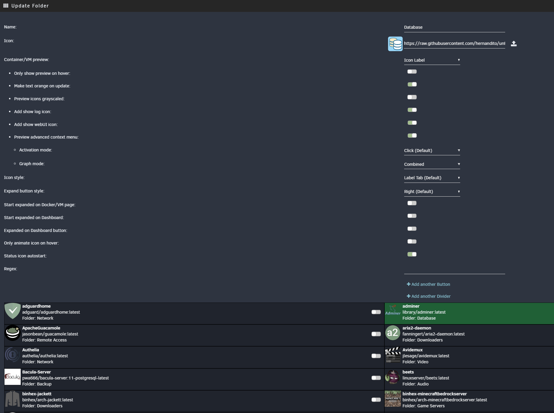

  18. I installed the plg file from your original post on pg. 31. Same issue, all the VM's are listed and no folders showing. Is this update from a different location? I used this one: Plugins update page shows:

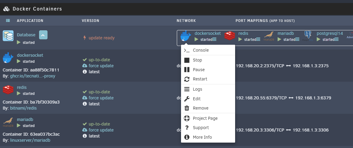

  20. It's not working for me in VM tab. I added a new folder yet it doesn't appear at all. All I see is a straight-up list of all VM's, as if there are no folders created. The only difference is when I go to add a 2nd folder, the ones I already added to the 1st folder do not appear in the toggle list. So the code is aware of the assignments but no folder is shown in the VM tab. Is there a log somewhere we can examine what the plugin is doing? Thanks

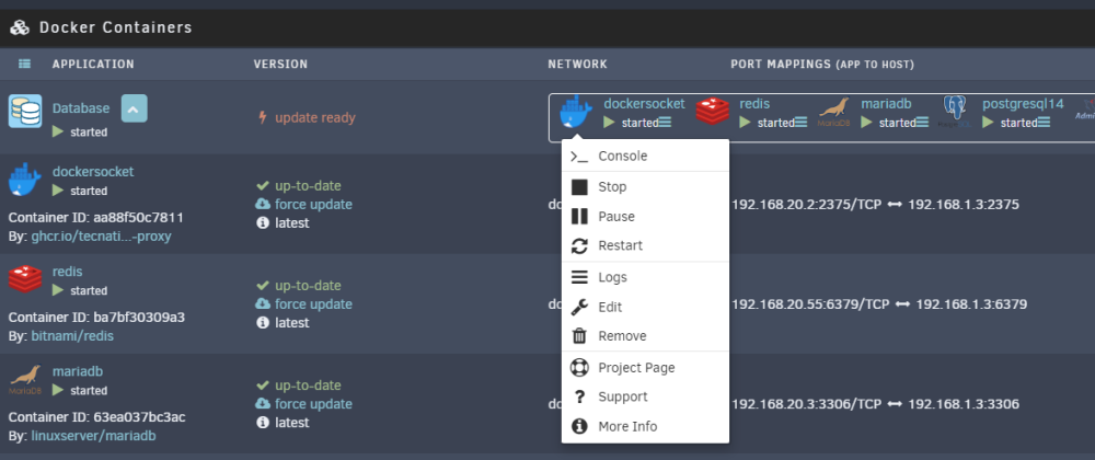

  22. Thanks guys, that worked! Have we lost the ability to click on a container icon and get to see cpu/mem usage graphs and set autostart like in the old plugin? This is what I get when I click on a container icon: Amazing work @scolcipitato, thanks much for the hard work!
