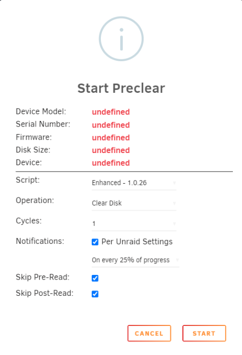

Ok, all is well. I couldn't format or preclear via Unraid, got errors, even after i manually removed partitions. What I did to fix it was to just pass it through to my other VM , then used the AData SSD Toolbox to do a secure-erase. I then restored the backup (using Easeus Todo Backup), and Windows won't boot. I booted the VM with a Windows 10 retail disc, went to command prompt in recovery, then ran And all is well, got back into a running Windows 10 install. Thanks for the help @dlandon!
I actually have four of these drives, I checked them all, the other three have normal english text in the attributes. Here's the output from my other pass-through drive: Is there anything you can do on your end to eliminate the issue? I'm going to image it and format, see if it solves the issue. Thanks!
Holly Molly, check this out: No idea how all these characters came about, is there any way to fix them? The drive is running fine as passthrough in the VM (or even when I boot it baremetal).
The NVMe is actually a pass-through to a VM (which is currently off), and it does have an NTFS GPT partition on it. I can't config it @ all since there is no cog for it, anything I could do to make it recognize the NTFS partition?
