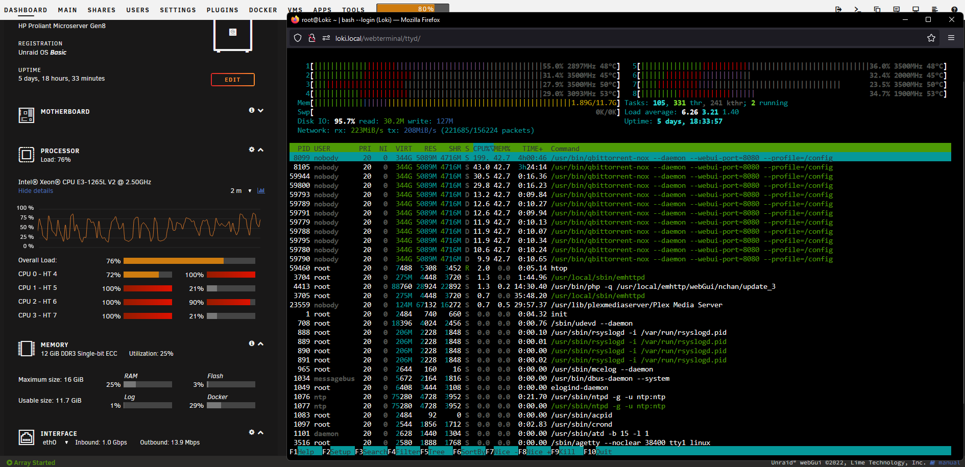

  2. Hello all I'm still new to UnRaid, and Linux in general, but i have been having a problem with Binhex qBittorentVPN for over a year. I have just done a reinstall of UnRaid 6.10.3. Before i was on 6.9.2, but QB has the same issue in the new version. I have a 1Gbps Internet Connection over Fiber, but when I download at full speed 6 Cores out of 8 is pined at 100% most at the time on the Dashboard. I have done the command htop where i can see QB using over 200% CPU often. How is that even possible? In UnRaid 6.10.3 the download speed will jump very quickly up to 1Gbps and then back down to like 350-450Mbps, and then completely stop for 10-15Sec, and then repeat. I only have 49 torrents seeding and 1 Downloading when this happens. I should mention that i have set "VPN_ENABLED" = no in the Docker Template, but it was the same issue with it enabled on 6.9.2 using PIA VPN, but the connection was more stable, and topping out at 850Mbps. I have just noticed in the syslog.txt from the diagnostics zip when writing this: Line 195 "Jun 23 21:14:18 Loki kernel: Performance Events: PEBS fmt1+, IvyBridge events, 16-deep LBR, full-width counters, Broken BIOS detected, complain to your hardware vendor." Line 196 "Jun 23 21:14:18 Loki kernel: [Firmware Bug]: the BIOS has corrupted hw-PMU resources (MSR 38d is 330)" what is this? Could this be the culprit? loki-diagnostics-20220629-1939.zip
