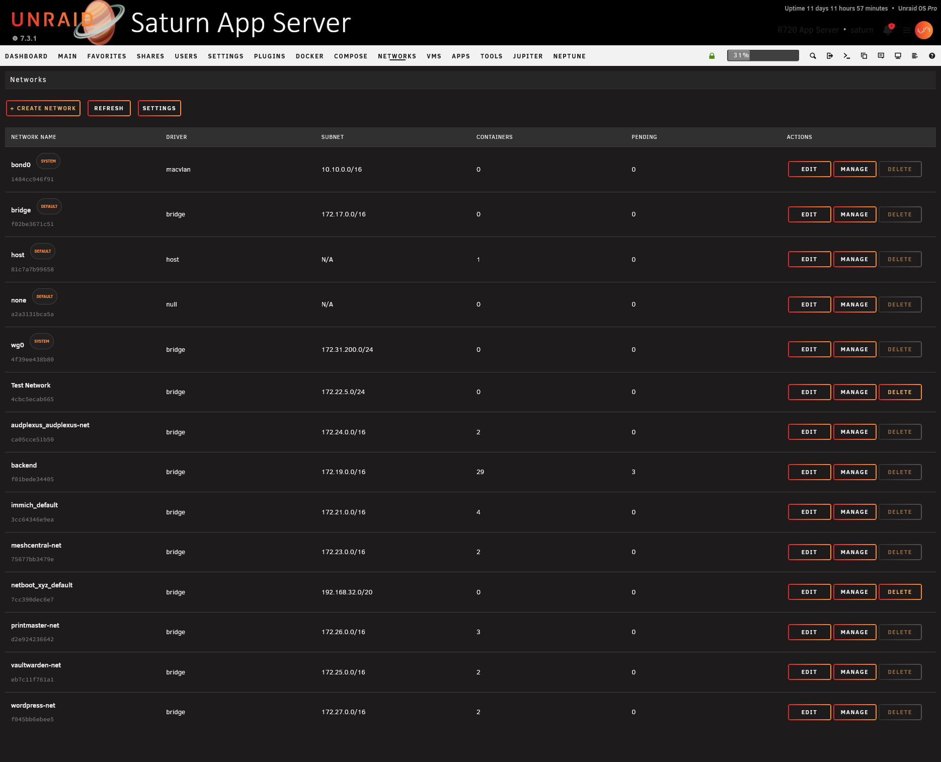

  4. This is also fixed but the fix is in the latest beta of Compose Manager Plus, the issue was related to the editor modal tabs causing the Network tab to remain hidden when selected.
  5. Thanks to everyone who reported the stuck “pending” entries, duplicate-endpoint errors, and failed container updates. The plugin’s use of Post Arguments for network persistence was the wrong approach, and I’m moving away from it entirely. I’ve committed changes for the next release: Unraid 7.4 and newer: additional attachments use Unraid’s native Additional Networks field. For prerelease builds, this requires 7.4.0-beta.1.2 or newer, which includes the container-update restoration fix. Earlier Unraid versions: container attachment changes are disabled. Network inspection, creation, and metadata editing remain available. Post Arguments are left alone: the plugin will no longer add, remove, or migrate network commands there. If reconnect commands are detected in existing Post Arguments, a warning will identify the affected containers. Attachment changes through the plugin will be blocked for those containers to avoid adding conflicting configuration. Those commands may have been added manually, so the plugin will not assume ownership or remove them. This does not automatically repair existing Post Arguments. Review affected containers in Unraid’s container editor, and don’t indiscriminately clear unrelated arguments. Deleting networks or rebuilding docker.img does not remove commands saved in container templates. The changes also correct pending counts and distinguishes attachments awaiting container recreation from live connections. A plain container start does not apply newly saved Additional Networks.
