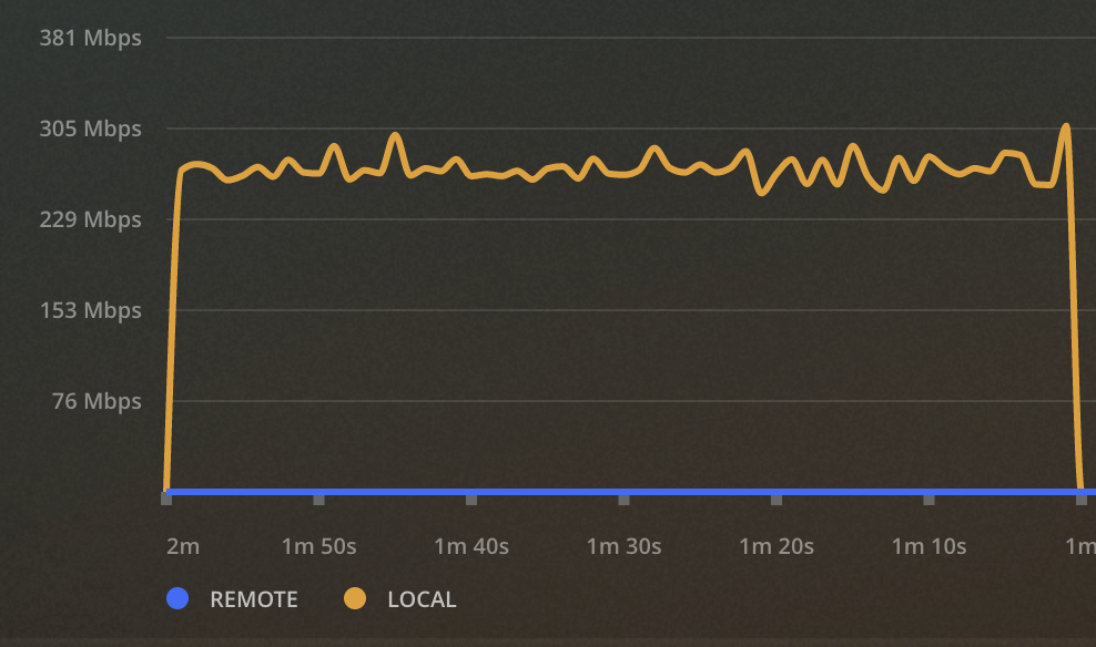

  16. Hi! I'm having an issue with my Plex in combination with my Nvidia Shield. When I want to play a certain piece of content it keeps loading for a minute. After that 1 second the video plays and it keeps loading again for a minute. Other pieces of content work just fine. And this piece of content where I have this issue with just works fine in the browser. My bandwith looks like in as in the picture, but the video isn't playing. In the error logging I'm seeing this issue: Failed to stream media, client probably disconnected after 3588096 bytes: 104 - Connection reset by peer Thanks!
