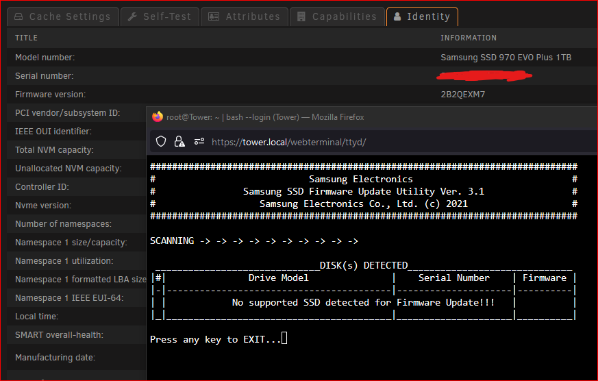

  12. No dice. Tried with the array stopped and with the cache drive out of the motherboard. Cache 2 was removed and only cache was left installed. Firmware listed on Samsung website: None of my other PC's have an nvme slot, otherwise i'd try to remove the old FW drive and update in another Mobo....I'm out of ideas.

  14. Once this parity check is complete, I'll first try stopping the array and running the tool again from an external drive. If that doesn't work I'll do as you suggest and remove the 'cache 2' drive to see if it'll pick up the old FW on the 'cache' drive. I'll report back with results. Much appreciated for your help with the instructions and troubleshooting.

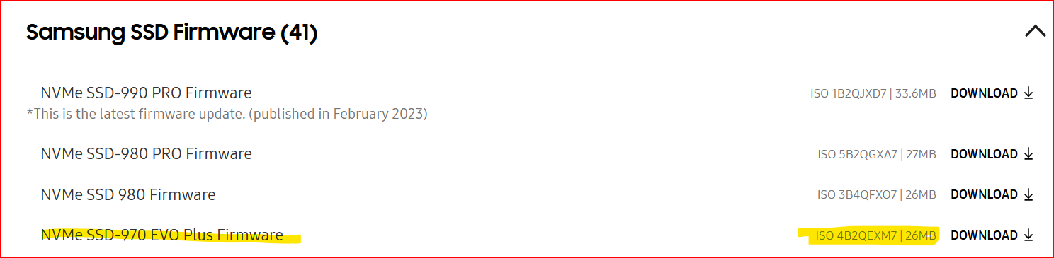

  15. I was able to follow all the steps but the firmware updater does not detect all of my Samsung SSD's. I have two 970 EVO Plus drives in a cache pool together for mirroring. The drive named "Cache" has an older firmware starting with '2B' and Cache 2 already has the updated firmware starting '4B'. I'm looking to update the "Cache" NVME. When running the updater, it only detects "Cache 2" and says that the firmware is already up to date (which is true), but it does not list out the first drive "Cache". Any ideas?

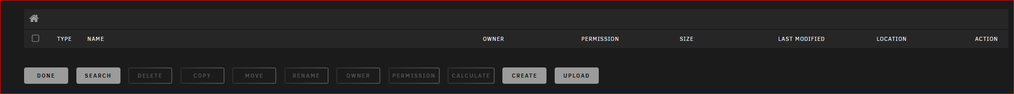

  16. With the new version 2023.02.19, I'm unable to see any files when opening up shares. The screen just shows zero files. Everything worked great until this updated version. Is there a way to downgrade versions for plugins? Edit: a server reboot appears to have resolved the issue.
