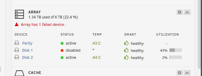

  3. Hello Sir, I am facing device disable from time to time. usually what i have done is stop the array, remove the disk and start the array without the disk. After started, i stop the array again, reselect disk 1 and start array again. usually what happens is that array will check pariety again and when it is complete, i have active disk. which will last for a few days before disabled again. I have attached my diagnostic for reference. I have changed my sata cable for this disk as well, but the problem persist. homenas-diagnostics-20231123-1625.zip

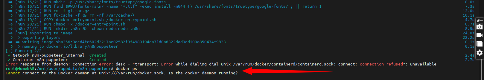

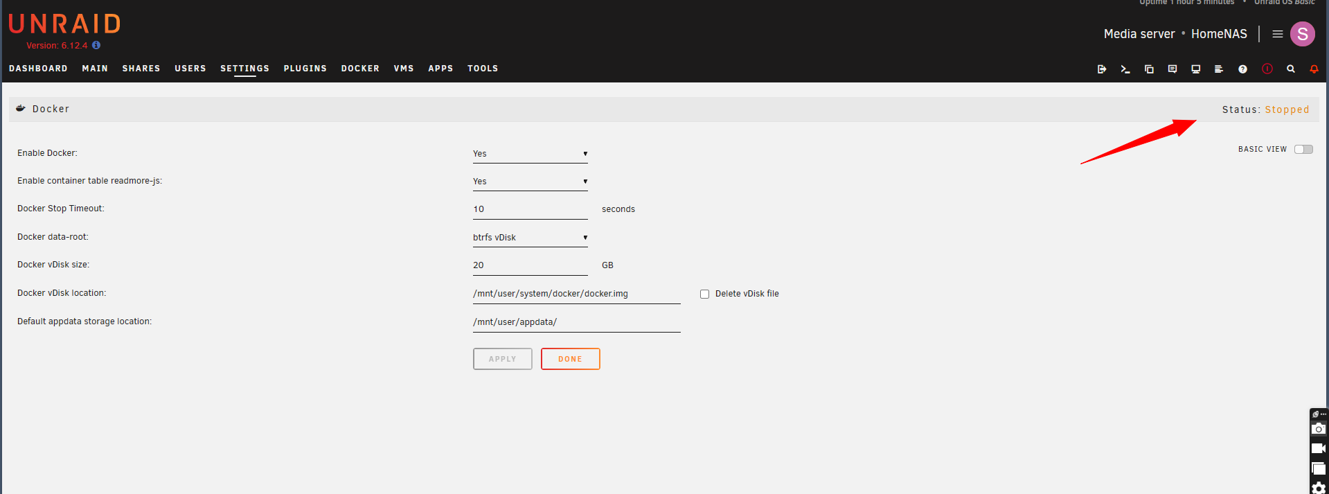

  5. Hello Sir, I am facing problem of restarting docker after stopping ( ie i have the "enable docker " to "no " , press done and change back to " yes " and press done . However, the status is showing "stopped " as shown in my screenshot below if i login using SSH and try 'docker ps' , it gives me error as well. I have attached my diagnostic for reference. May i know what should i be doing? homenas-diagnostics-20231025-1421.zip
  6. nope..it does not show up in docker page. Anyway i am reinstalling all the docker. Since harddisk is working well, my previous setting for docker containers can be retrieve easily. Thank you once again for your help.
