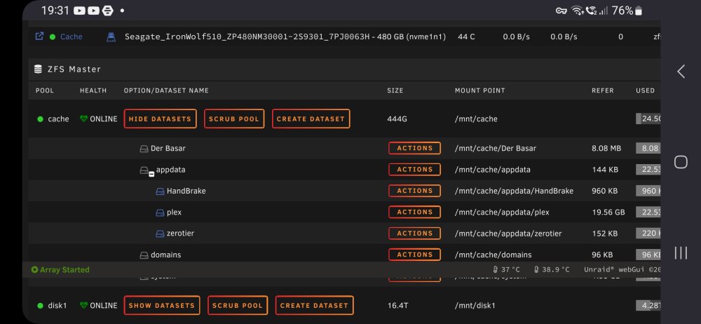

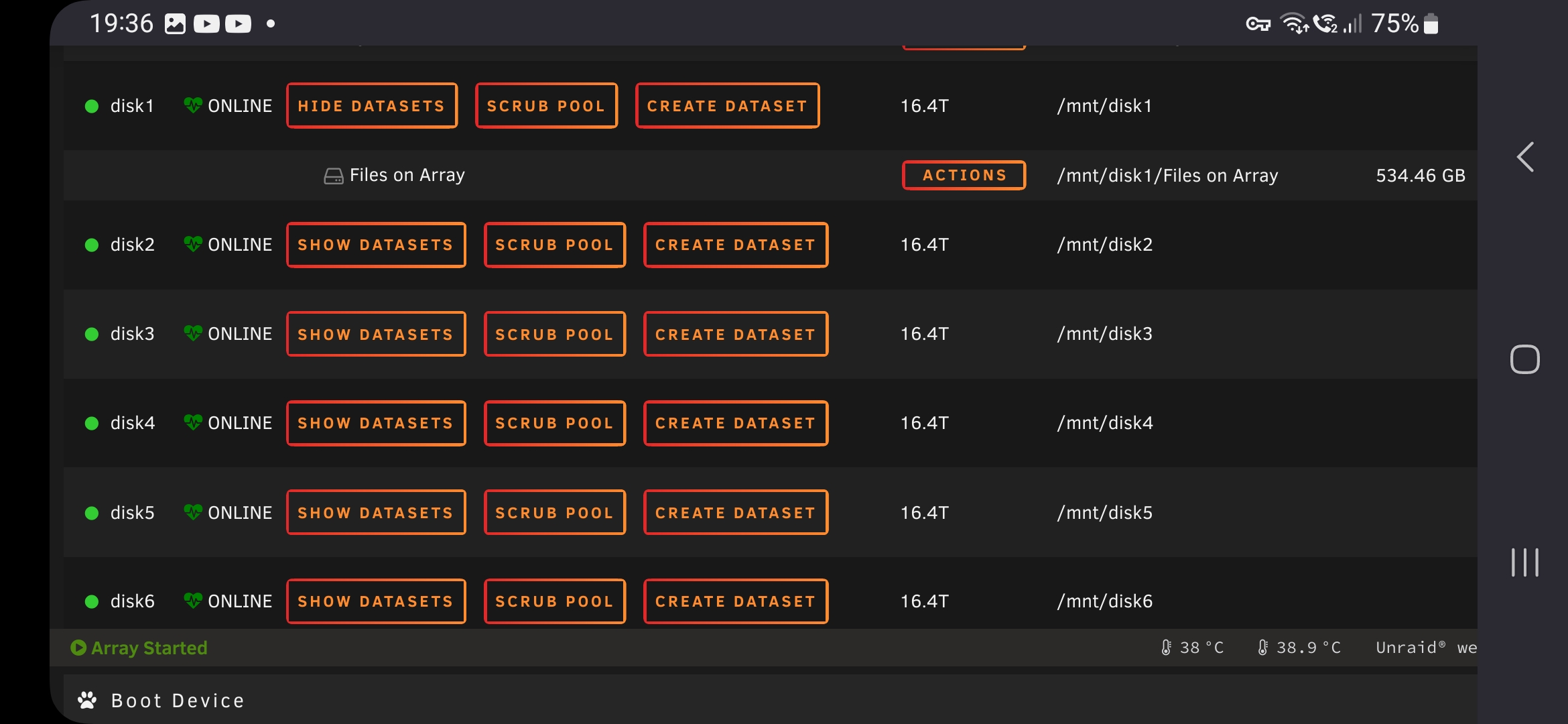

  1. unbalance. What Else. I move all data from one disk to a 7th disk, Format disk X to ZFS and move everything back.
  2. Oh, sorry. I was not in a good condition yesterday. On the Cache drive (like in the video from Spaceinvader) All Shares are Datasets and every docker is its own dataset to make individual snapshots. But this is not the case on the ARRAY There is nothing, except for this one Share, but the Data from this share are on disk 1, 3, 4, and 6
  3. Hi, Im Stuck with a similar problem. I have used unbalance to move everything from the disk, format to zfs and move it back. (For this i have removed my 2nd parity, move everythingon and of and after all put it back to be the 2nd parity) Now Array is a dataset and everything is fine. The script also works and every docker is its own dataset. But on the array I have no dataset. I know why I can't use the folder to dataset script, but not, what I should to do.
