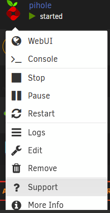

  18. Low importance question here: I just noticed today (did work last week), that the link to the support forum seems to be wrong. It's pointing to https://unraid.net/forum/index.php?topic=50453.0 Would you mind fixing it, when you change the template the next time? As said before: not high prio, but simply convenient 🙂

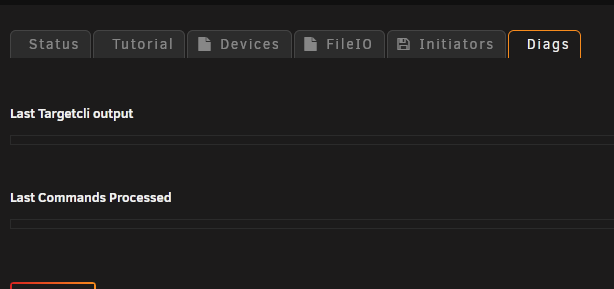

  19. Additional information from my side: When updating unraid from 6.11.0 to 6.11.1, I did not re-install the plugin and everything worked. When updating from 6.11.1 to 6.11.2 it did not work and after reading this thread, I re-installed it- without resolving the issue as mentioned in my prev. posts. After the provided fix, I updated the plugin without re-installing it + recreated the luns, iqn, etc. -> worked again, but I did re-install it before the fix, don't know if that changed anything
  20. Thanks a lot for the quick fix @ich777! I can confirm, that the "Fix 6.11.2 - added missing libffi7 package" is working. But I can add: DNS vs IP did not change anything for me. I had to re-create everything in the "initiators" tab. I could re-add the existing fileIO images, even though they would not show in the "FileIO" tab.
  21. Just fyi (I don't use it for important data yet, so not a huge deal). It worked fine when upgrating to 6.11.1 Today I updated to 6.11.2 and it does not work anymore. De- and re-installed the plugin, but did not change the behaviour. Both Status and Diags look the same = empty Devices, FileIO and Initiators look good, as far as I can tell, but my PC can't connect to it anymore. P.S. Expanding / shrinking and changeing write-back for existing fileio would be awesome, if possible at all /edit: add the traceback -> looks like he can't import ImportError: libffi.so.7
