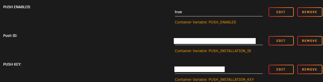

  10. FYI as of the latest version of this you can enable mobile client push notifications (basically live sync to your phone) https://github.com/dani-garcia/vaultwarden/wiki/Enabling-Mobile-Client-push-notification. Add the variables to the docker template mentioned above, and restart the container. After that, re-install your phone app. Kind of a pain but well worth it to not have to sync manually any more.
