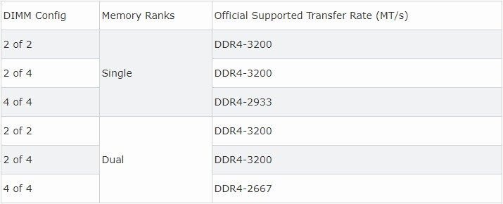

  1. Current change: Updated to utilize Profile and XMP Profile for ram to get correct timings, then changed the speed down to 2666, to match the required speed setting but also hopefully to make the ram more stable, it has currently lasted - BIOS: Enabled power boost - BIOS: Curve +7 Uptime 1 hour 25 minutes However, I've had intermittent stability for over 5 days.
  2. Still crashing... Tried: - Updating bios to 5.60 https://www.asrock.com/mb/AMD/X570 Taichi/index.asp#BIOS - Removing two sticks of ram - Trying the other two sticks of ram - trying different ram slots with different 2 sticks Nothing seems to be resolving the issue, system is now unstable after less than 1 hour. - BIOS: Disable power boost - BIOS: Disable global c-state - BIOS: Power idle control = Typical current idle - BIOS: IMMOU enabled - BIOS: Curve +6 - BIOS: RAM 1.35V speed 2666

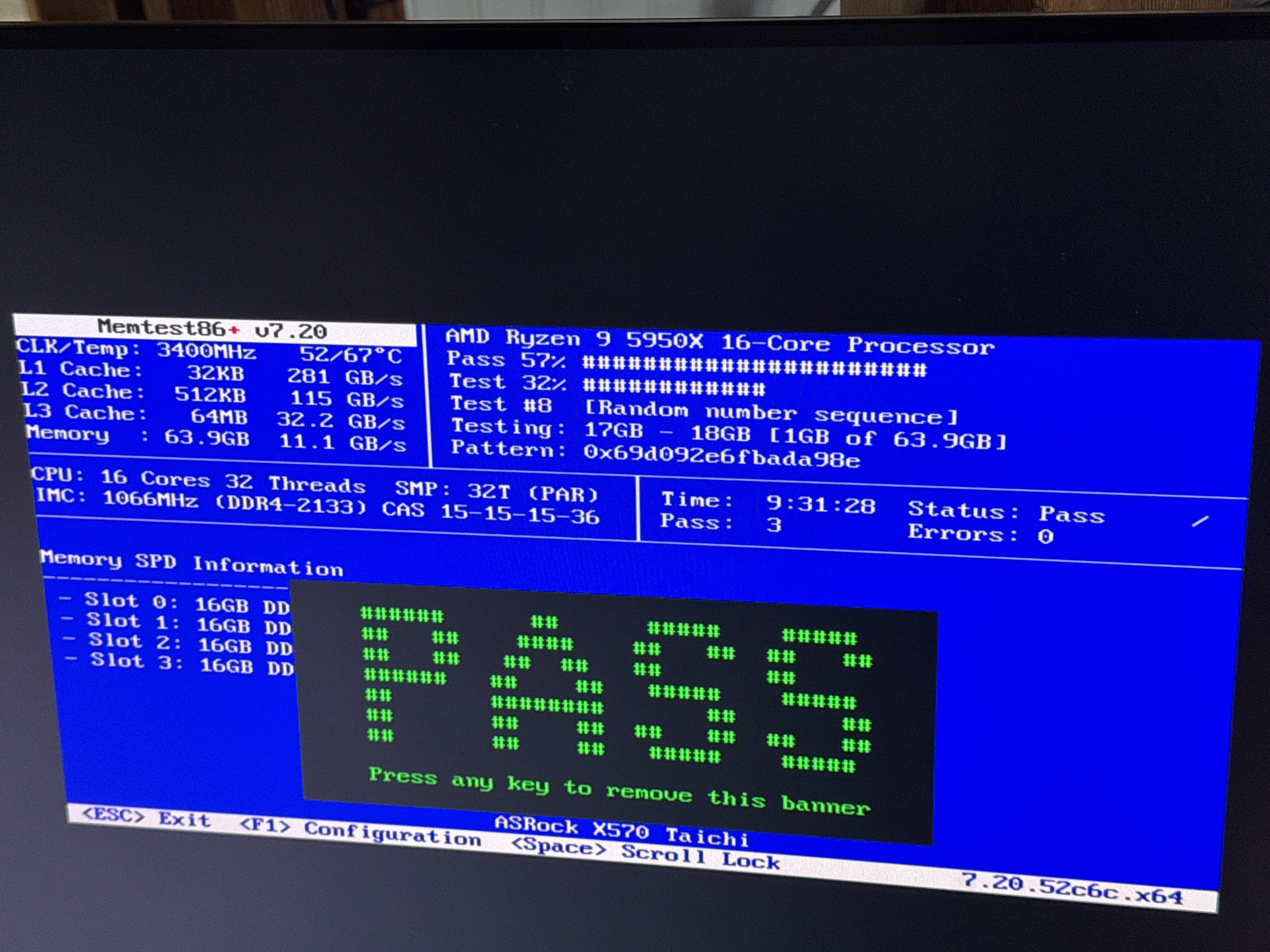

  7. Bumped up to +6 on the curve for silicon lottery mention, also already had typical idle current set in bios, since server was stable before update + giving all cpu cores to unraid through the boot command, I believe this is a CPU issue I wasn’t hitting when only running half the cores. ill continue boosting the curve to test, current setting +6

  10. Alright, what I am parsing from the above post. 1. [done global c-state disabled] In bios check for disabling c-states 2. [done Advanced -> AMD Overclocking -> Curve +4] Change bios with ``` To solve this problem you need to supply higher voltage to your CPU so that it is stable when running at peak frequencies. The easiest way to achieve this is to use the AMD curve optimiser which is accessible via your motherboard's UEFI. Access it and put a positive offset of 4 points, which will increase the voltage your CPU is getting at higher loads. It will limit overclocking potential due to higher heat dissipation requirements, but it will run stable. ``` 3. [was already disabled changed speed from 2377 to 2666] Make sure XMP is disabled and instead use slower supported speeds 4. [running server now start time 5/12/25 5:39pm EST] Test 5. if still having issues, try different ram stick pairs 6. next, ``` Reducing frequencies to within non-overclocked standards and increasing voltages of CPU or RAM helps, but might not fix the issue. A potential fix is to update the UEFI (also misnamed "BIOS updates"), and then apply the PBO+4 curve for more stability on higher frequencies. Per silicon lottery, some CPUs might need +6 or higher offsets. ``` 7. next, not sure how to do this one, but I'll take a gander. ``` This seems to be related to the C6 c-state, that does not seem to be well supported (if at all) in Linux. To fix this issue, go into UEFI Setup and search for an option labelled something like this: "Power idle control". Change its value to "Typical current idle". Note that these names are dependent on what the motherboard manufacturer calls them, so they may be a little different in your particular case. Other less ideal solutions include disabling c-states in the UEFI Setup or adding processor.max_cstate=1 to your kernel command line arguments. ```

  13. Alright so it isn’t the ram, any help would be appreciated
  14. Ran in safe mode with no gui and it still crashed (before I could pull the logs), running a full memory test now to cehck if there are perhaps issues there.
