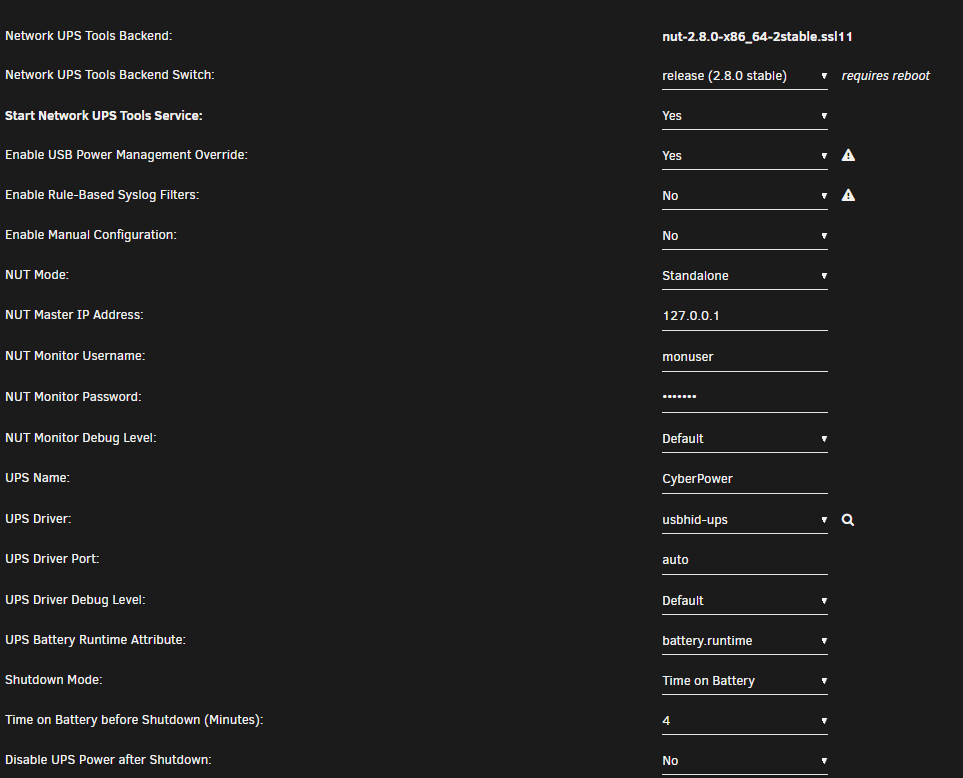

  1. I am having a problem starting the NUT service for my UPS. I am not quite sure what I'm missing, but I've tried to follow other's advice and try different drivers other than usbhid-ups, but none seem to work. Can someone help me figure out what I need to change to get this working? I am running nut-2.8.0-x86_64-2stable.ssl11 on Unraid Version 6.11.5. I have a USB connected CyberPower UPS (cp1500 AVR LCD) only servicing the Unraid server (no master/slave required). When I scan for the ups driver, I get the following: [nutdev1] driver = "usbhid-ups" port = "auto" vendorid = "0764" productid = "0501" bus = "005" This jives with the USB Diagnostics output of: Bus 005 Device 003: ID 0764:0501 Cyber Power System, Inc. CP1500 AVR UPS When I try and start the service, the syslog indicates the following and NUT doesn't start: Jun 6 22:34:37 Ceti rc.nut: Network UPS Tools - Generic HID driver 0.47 (2.8.0) Jun 6 22:34:37 Ceti rc.nut: USB communication driver (libusb 1.0) 0.43 Jun 6 22:34:37 Ceti rc.nut: libusb1: Could not open any HID devices: insufficient permissions on everything Jun 6 22:34:37 Ceti rc.nut: No matching HID UPS found Jun 6 22:34:37 Ceti rc.nut: Driver failed to start (exit status=1) Jun 6 22:34:37 Ceti rc.nut: Network UPS Tools - UPS driver controller 2.8.0 Jun 6 22:34:45 Ceti ool www[2953]: /usr/local/emhttp/plugins/nut-dw/scripts/write_config Jun 6 22:34:45 Ceti rc.nut: Writing NUT configuration... Jun 6 22:34:48 Ceti rc.nut: Updating permissions for NUT... Jun 6 22:34:48 Ceti rc.nut: Checking if the NUT Runtime Statistics Module should be enabled... Jun 6 22:34:48 Ceti rc.nut: Disabling the NUT Runtime Statistics Module... Here is a screen cap of the settings in the UI:

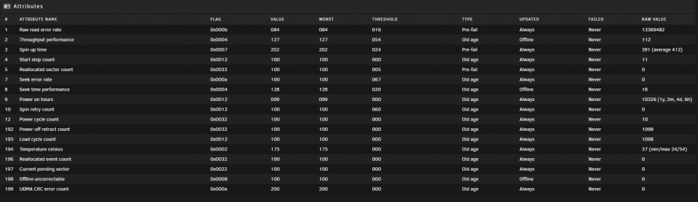

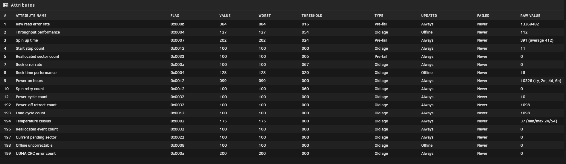

  4. Looking through the log, I see the most recent 4 errors. They all look like this: Error 137 [0] occurred at disk power-on lifetime: 10328 hours (430 days + 8 hours) When the command that caused the error occurred, the device was active or idle. After command completion occurred, registers were: ER -- ST COUNT LBA_48 LH LM LL DV DC -- -- -- == -- == == == -- -- -- -- -- 40 -- 41 00 00 00 00 00 00 00 00 00 00 Error: UNC at LBA = 0x00000000 = 0 Commands leading to the command that caused the error were: CR FEATR COUNT LBA_48 LH LM LL DV DC Powered_Up_Time Command/Feature_Name -- == -- == -- == == == -- -- -- -- -- --------------- -------------------- 60 04 00 00 a8 00 02 9b be 2c 28 40 00 1d+07:49:43.717 READ FPDMA QUEUED 2f 00 00 00 01 00 00 00 00 00 10 00 00 1d+07:49:43.717 READ LOG EXT 61 04 00 00 a0 00 02 9b be 30 28 40 00 1d+07:49:30.714 WRITE FPDMA QUEUED 60 00 30 00 d0 00 02 9b bc 3a e0 40 00 1d+07:49:24.272 READ FPDMA QUEUED 60 00 08 00 b8 00 02 9b bc 3a d8 40 00 1d+07:49:24.271 READ FPDMA QUEUED These are the two lines that seem concerning. Everything else looks ok. 0x03 0x028 4 100435 --- Read Recovery Attempts 0x04 0x008 4 137 --- Number of Reported Uncorrectable Errors So obviously there have been some errors. I just don't know where the tipping point is for replacing the drive. What would you do? Would these errors be enough to warranty-replace the drive?
  5. ceti-smart-20220107-1050.zip Thanks for all your help. Here's the report.
  6. SMART extended self-test finished and completed without errors. Is the SMART test result something that can be relied on? Does this mean the disk is fine?
