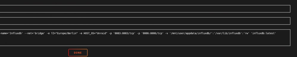

  5. Thank You for looking into it @kennymc.c Changing Host Path 1 didn't change much. A new directory /appdata/influxdb2 is created but remains empty. The log says 2021-03-14T23:23:42.532348802Z warn boltdb not found at configured path, but DOCKER_INFLUXDB_INIT_MODE not specified, skipping setup wrapper {"system": "docker", "bolt_path": ""} ts=2021-03-14T23:23:47.947998Z lvl=info msg="Welcome to InfluxDB" log_id=0StlggQl000 version=2.0.4 commit=4e7a59bb9a build_date=2021-02-08T17:47:02Z ts=2021-03-14T23:23:47.963094Z lvl=info msg="Resources opened" log_id=0StlggQl000 service=bolt path=/var/lib/influxdb2/influxd.bolt ts=2021-03-14T23:23:47.970154Z lvl=info msg="Bringing up metadata migrations" log_id=0StlggQl000 service=migrations migration_count=14 ts=2021-03-14T23:23:48.918810Z lvl=info msg="Using data dir" log_id=0StlggQl000 service=storage-engine service=store path=/var/lib/influxdb2/engine/data ts=2021-03-14T23:23:48.918919Z lvl=info msg="Compaction settings" log_id=0StlggQl000 service=storage-engine service=store max_concurrent_compactions=2 throughput_bytes_per_second=50331648 throughput_bytes_per_second_burst=50331648
  6. Hi, I have the installed InfluxDB docker and I can log in and see and display data. But I wonder why my appdata/influxdb directory remains empty. It seems as if tha data goes somewhere else. Perhaps in the image file? I removed the docker and reinstalled form the apps tab making sure that the default configuration for Host Path 1 points to /mnt/user/appdata/influxdb/ . The success message after installation includes the desired path but also /var/lib/influxdb . I add the log after restart below. What puzzles me is the line ts=2021-03-14T22:29:48.418174Z lvl=info msg="Using data dir" log_id=0StiaunG000 service=storage-engine service=store path=/var/lib/influxdb2/engine/data What can I do to get the data written to a proper location? Thanks in advance Michael 2021-03-14T22:29:42.498767181Z warn boltdb not found at configured path, but DOCKER_INFLUXDB_INIT_MODE not specified, skipping setup wrapper {"system": "docker", "bolt_path": ""} ts=2021-03-14T22:29:47.593475Z lvl=info msg="Welcome to InfluxDB" log_id=0StiaunG000 version=2.0.4 commit=4e7a59bb9a build_date=2021-02-08T17:47:02Z ts=2021-03-14T22:29:47.614938Z lvl=info msg="Resources opened" log_id=0StiaunG000 service=bolt path=/var/lib/influxdb2/influxd.bolt ts=2021-03-14T22:29:47.623203Z lvl=info msg="Bringing up metadata migrations" log_id=0StiaunG000 service=migrations migration_count=14 ts=2021-03-14T22:29:48.418174Z lvl=info msg="Using data dir" log_id=0StiaunG000 service=storage-engine service=store path=/var/lib/influxdb2/engine/data ts=2021-03-14T22:29:48.418315Z lvl=info msg="Compaction settings" log_id=0StiaunG000 service=storage-engine service=store max_concurrent_compactions=2 throughput_bytes_per_second=50331648 throughput_bytes_per_second_burst=50331648 ts=2021-03-14T22:29:48.418333Z lvl=info msg="Open store (start)" log_id=0StiaunG000 service=storage-engine service=store op_name=tsdb_open op_event=start ts=2021-03-14T22:29:48.418419Z lvl=info msg="Open store (end)" log_id=0StiaunG000 service=storage-engine service=store op_name=tsdb_open op_event=end op_elapsed=0.088ms ts=2021-03-14T22:29:48.418489Z lvl=info msg="Starting retention policy enforcement service" log_id=0StiaunG000 service=retention check_interval=30m ts=2021-03-14T22:29:48.418523Z lvl=info msg="Starting precreation service" log_id=0StiaunG000 service=shard-precreation check_interval=10m advance_period=30m ts=2021-03-14T22:29:48.418756Z lvl=info msg="Starting query controller" log_id=0StiaunG000 service=storage-reads concurrency_quota=10 initial_memory_bytes_quota_per_query=9223372036854775807 memory_bytes_quota_per_query=9223372036854775807 max_memory_bytes=0 queue_size=10 ts=2021-03-14T22:29:48.419963Z lvl=info msg="Configuring InfluxQL statement executor (zeros indicate unlimited)." log_id=0StiaunG000 max_select_point=0 max_select_series=0 max_select_buckets=0 ts=2021-03-14T22:29:48.735702Z lvl=info msg=Starting log_id=0StiaunG000 service=telemetry interval=8h ts=2021-03-14T22:29:48.735688Z lvl=info msg=Listening log_id=0StiaunG000 transport=http addr=:8086 port=8086 ts=2021-03-14T22:29:58.362115Z lvl=info msg=Unauthorized log_id=0StiaunG000 error="authorization not found" ts=2021-03-14T22:29:59.014941Z lvl=info msg=Unauthorized log_id=0StiaunG000 error="session not found" [...] ts=2021-03-14T22:32:29.836588Z lvl=info msg="index opened with 8 partitions" log_id=0StiaunG000 service=storage-engine index=tsi ts=2021-03-14T22:32:29.837291Z lvl=info msg="Reindexing TSM data" log_id=0StiaunG000 service=storage-engine engine=tsm1 db_shard_id=1 ts=2021-03-14T22:32:29.837311Z lvl=info msg="Reindexing WAL data" log_id=0StiaunG000 service=storage-engine engine=tsm1 db_shard_id=1
