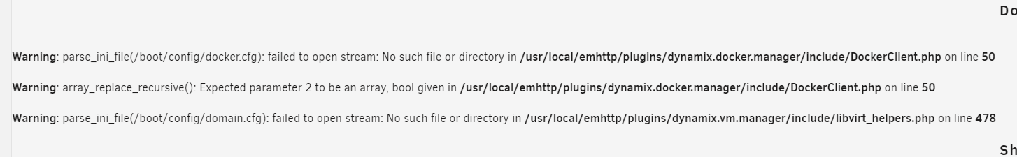

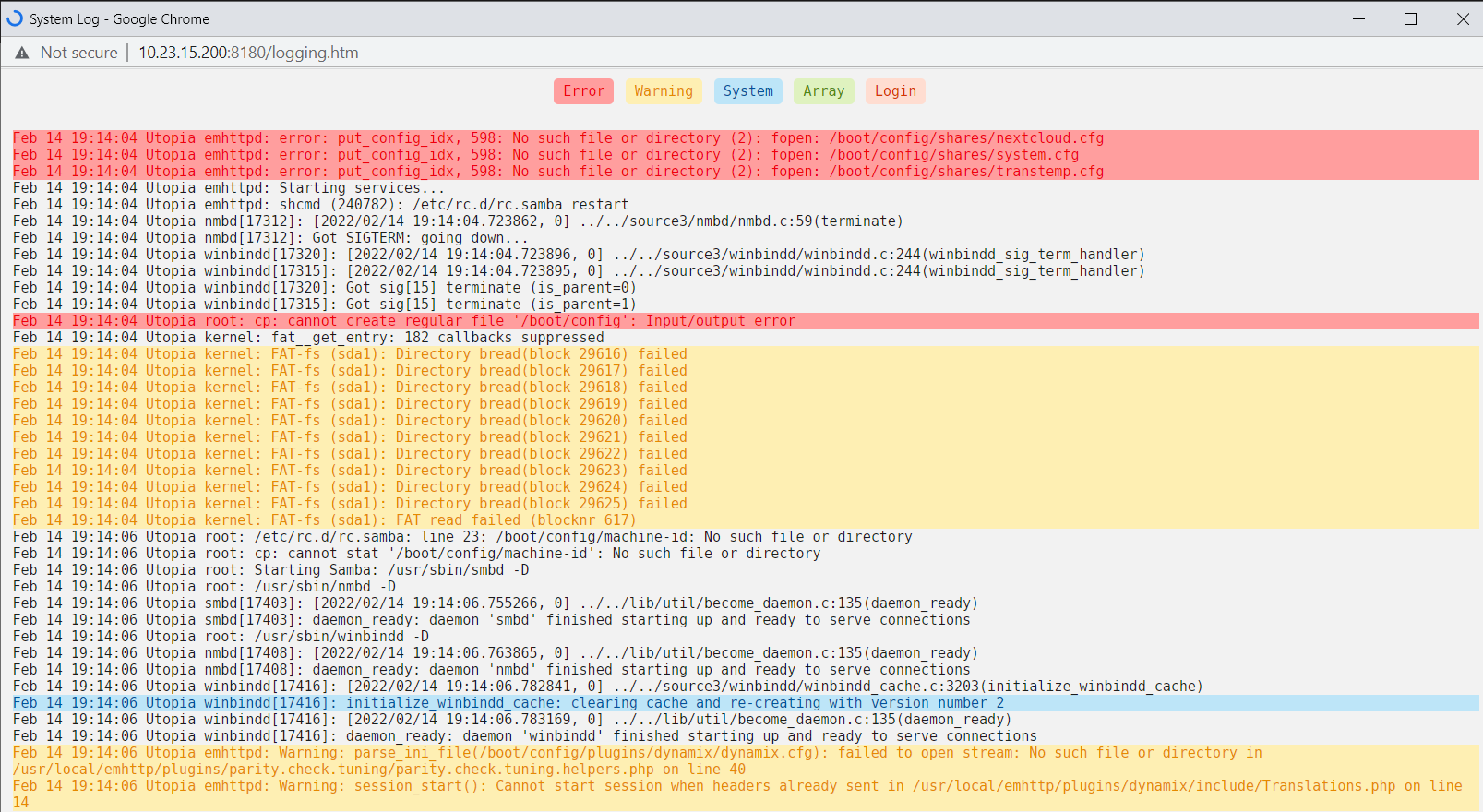

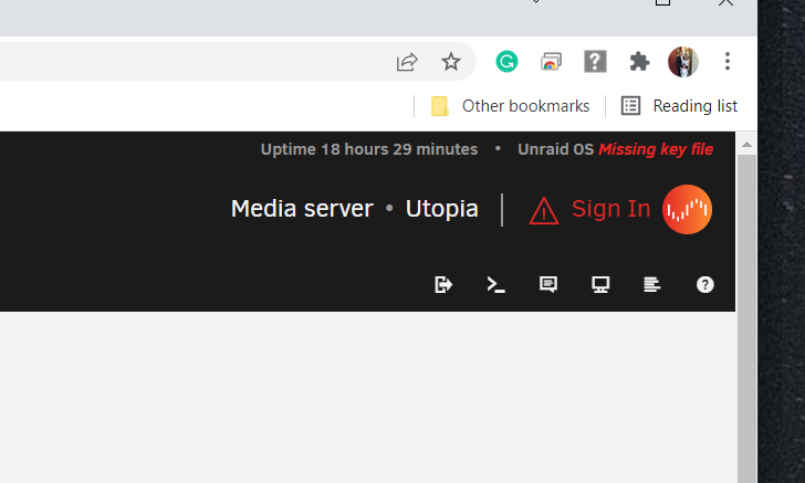

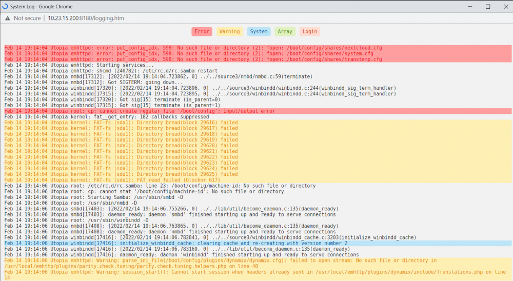

  1. Hello, I had a previous issue with a full cache drive causing problems with mover and appdata. I don't know what I messed up in my quest to fix that problem but after I sorted that mess out I had an error where my docker service randomly stopped and unraid was "signed out". I could still access some of my dockers webgui through manually typing the address in my browser. For example: Plex still worked no problem. I ended up replacing the USB drive as part of troubleshooting and all was well. Fast forward a month or so and I am getting the same errors again with the docker service. Docker Service appears stopped but I can still use plex, access webguis, and unraid appears "signed out". If I try to restart unraid the array wont stop and I get the error "RETRY UNMOUNTING USER SHARE(S)". An ungraceful shutdown and restart fixes the docker issue but I would like to fix it for good. Any help would be appreciated. utopia-diagnostics-20220214-1915.zip

  3. Figured I would loop back on this for posterity. I am still not sure what happened but my downloads share was on cache and that's what filled it up. It must have been a mis-click on my part. I ended up backing up appdata, domains, and system shares and reformatting. After transferring all data back I still had the issue with dockers. I ended up backing up the .confs (and any other db/config files for each docker) and wiped app data and docker.img and started fresh. I am now in the processes of setting up a second unraid server to send across country for backup.
