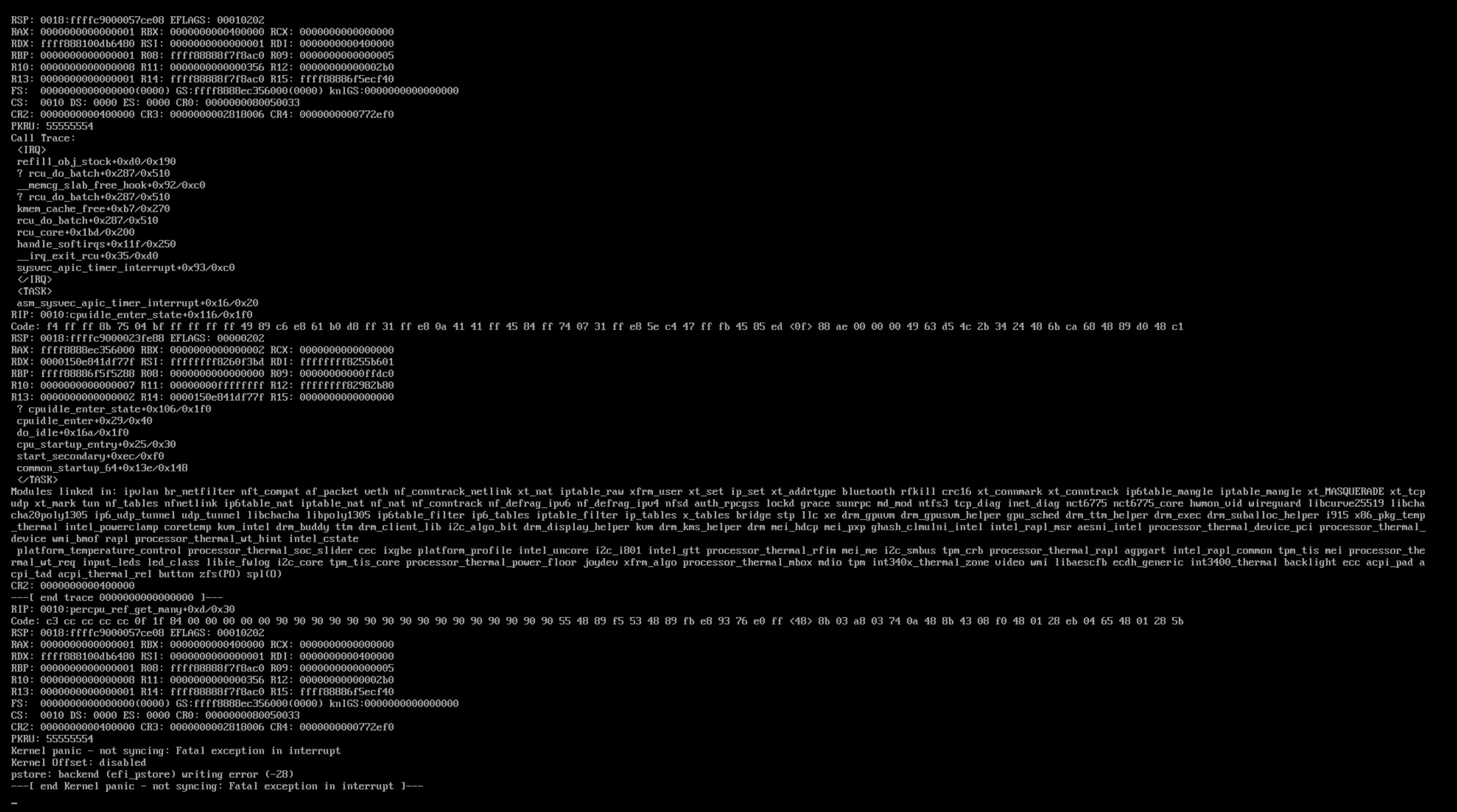

  3. Two days later and still no issue despite some heavy load from a jellyfin stack I forgot to shut down. syslog/dmesg look clean. The parity check has finished with 3048 errors which is kind of expected considering all the kernel panic I had in the past week. Overall I think the culprit was the CPU cooler that was not correctly mounted which reduced its efficiency. The kernel panics were mostly during the night when the plex/jellyfin workload was happening (opening detection, ...) so precisely when the load was high on the p-cores. I'll have to find a way to send notifications in case of high temperature.

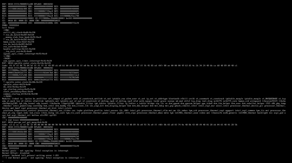

  4. Small update : I have been running for two weeks without any issue, then I had more and more kernel panic, the server could not even make it to 24h of uptime, sometime a couple of hours. Of course it happened when I was not at home, I could barely reboot the server with my nanokvm with tailscale help. Anyway, I unracked the 4U server and made some cleanup : Change of the thermal paste of the CPU and I moved from the default intel cpu cooler to a Thermalright Phantom Spirit 120 SE. Changing the faulty sata cable. I have some doubt on the intel provided cpu cooler I was using : While unscrewing it I noticed that one of its mounting pins wasn’t properly inserted into the motherboard, the pressure wasn’t evenly distributed across the CPU die. When I had those kernel panics, once I kept a nanokvm session opened on the unraid GUI and I'm pretty sure it shown a temp at 95°C at the bottom of the ui. I also have some doubt on the CPU itself, as the 14700 has some thermal issue, but I couldn't find anything conclusive with stress-ng. The memory has also been tested with memtest86 (the version embedded with unraid) but I couldn't make it crash. The server has been restarted and I'm now waiting for to see if it is crashing again.

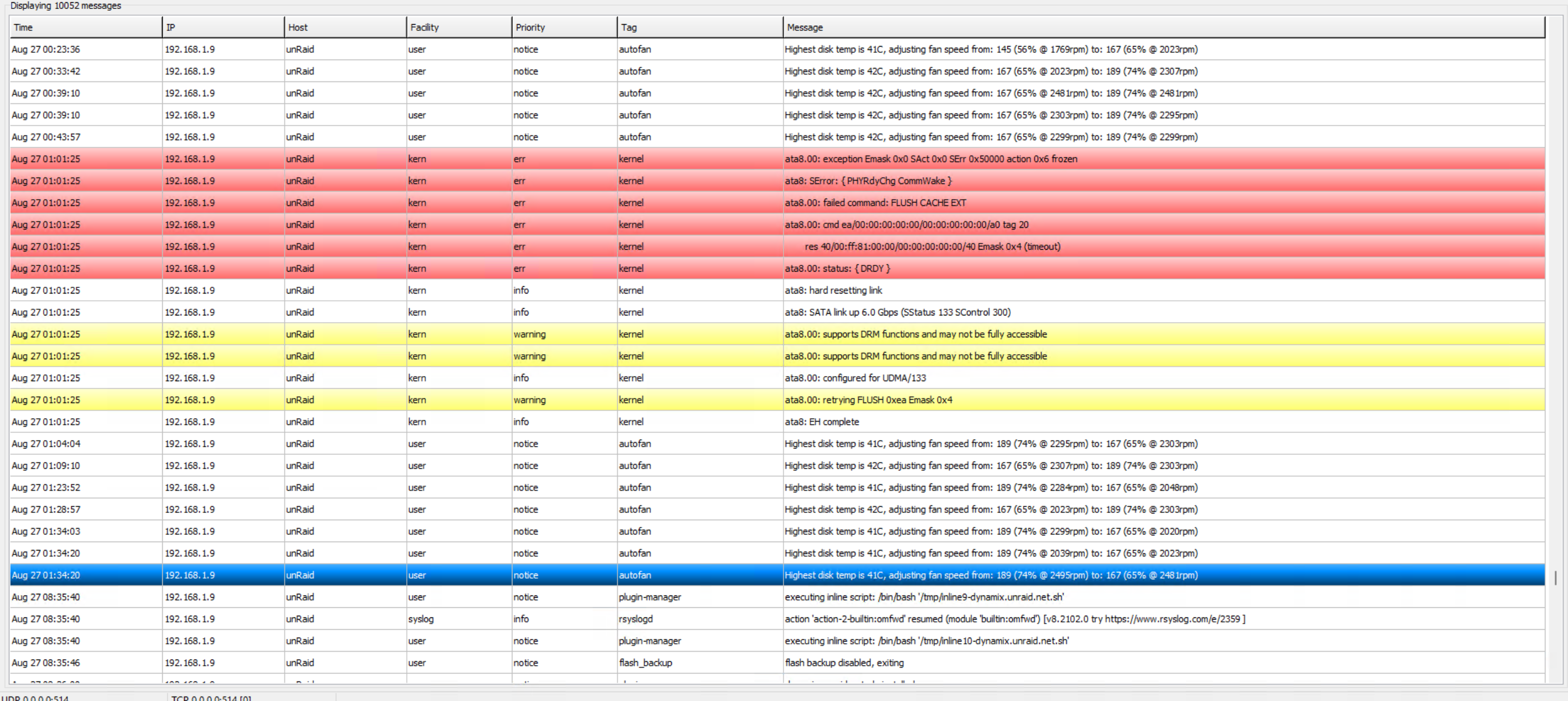

  7. Here's the unfiltered syslog from the external host. And the kernel panic time I remember : 27/08/2026 around 01h34 26/08/2026 at 04h05 syslog.zip
  8. I have an external syslog on another host. Nothing in the logs, the server just stop logging, here it is : I suspect the kernel panic happened after 01h34. There are some issues before that (a faulty disk connectivity with ata8) but it was 30 minutes before.
  9. Hello, Since a week I have frequent kernel panics, the uptime is < 24h. No hardware or software changes. Motherboard BIOS is up to date. My server is headless so I do not have a trace of the kernel messages. I do have a partial feedback from my kvm over ip : For now I tried : memtest86, OK. Disabling uneeded containers, no effect Following the latest kernel panic I disabled c-states and energy related features in the bios as the kernel messages seems to be energy efficiency related. unraid-diagnostics-20260826-1700.zip
