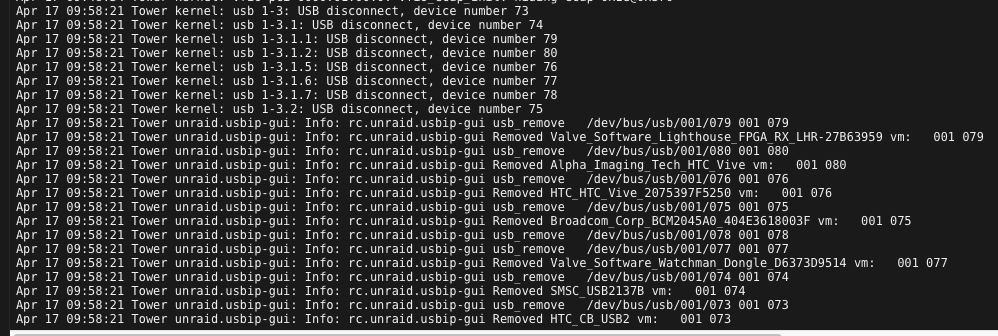

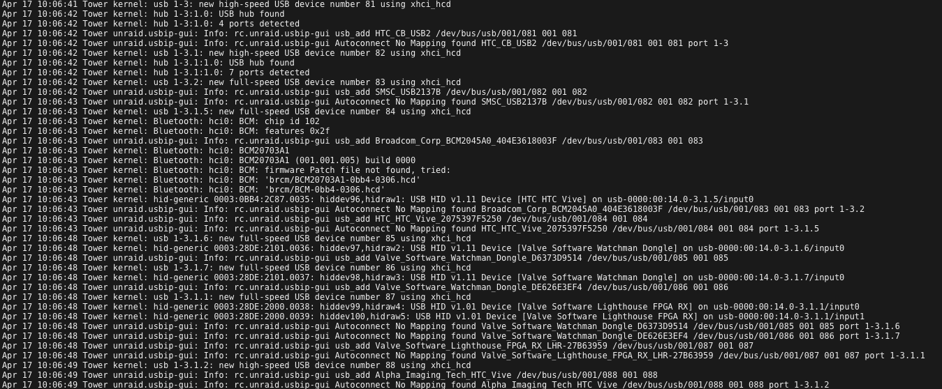

  5. I should have bookmarked... I can only find this now. is this relevant? https://ybalrid.info/2018/03/install-and-run-steamvr-on-archlinux-for-using-an-htc-vive-and-do-opengl-openvr-developement/

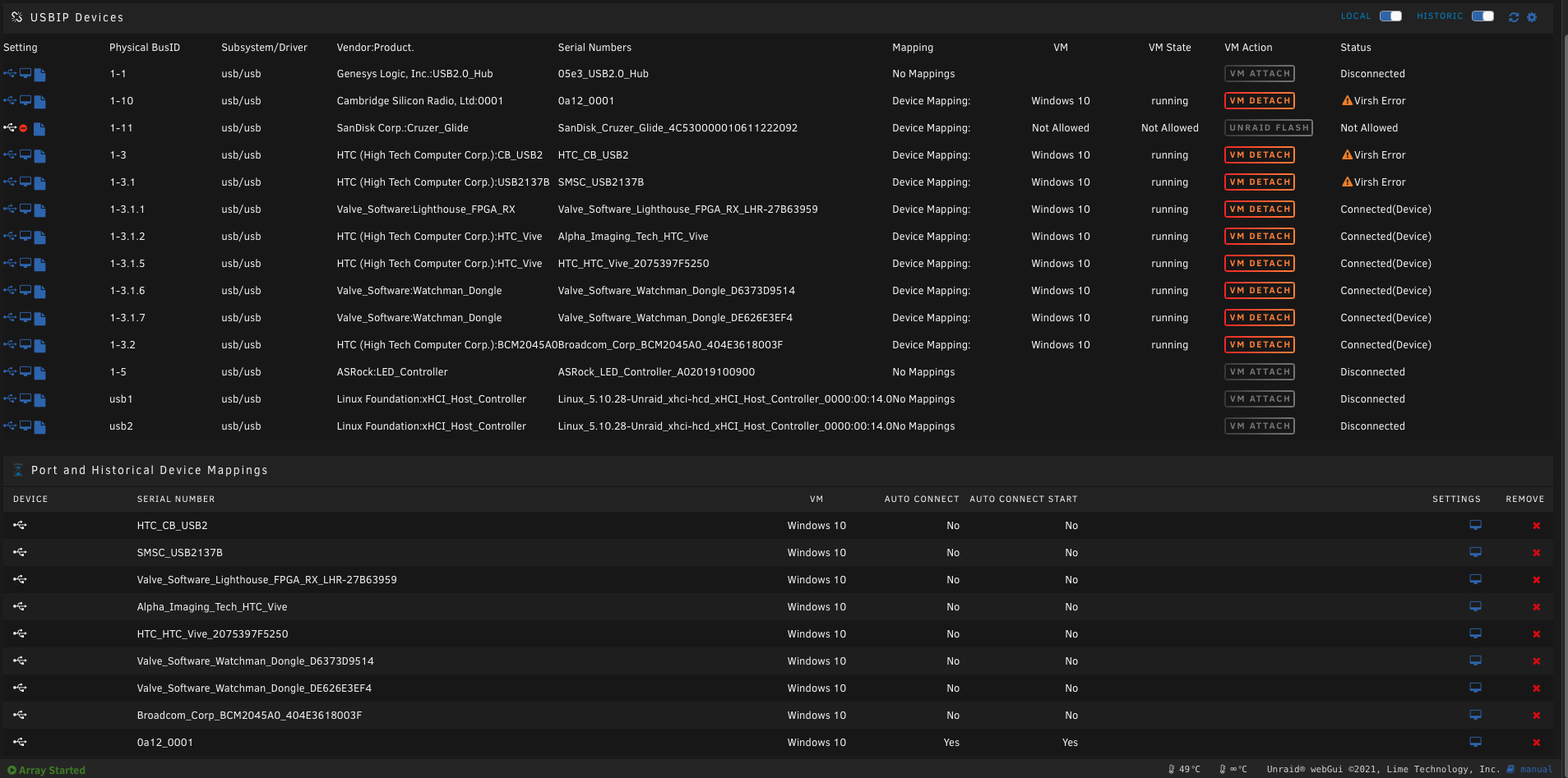

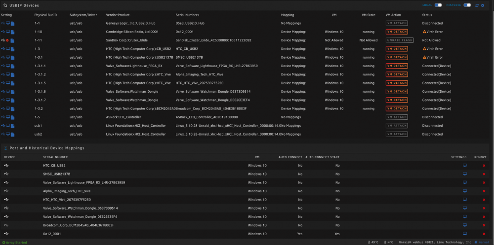

  6. Here is the output. I had tried both port mapping and device mapping and same result. also tried qemu 3.0 usb controller. currently have all mapping rules removed. I have seen some post about creating a dev rule to lump all these devices into one "group" or device but that was for running htc vive natively on Arch linux. seems interesting since the htc vive usb hub brings in 8 devices but it should be all considered one logic device. here is the usb insert event log from Unraid as well as usb.ini. remove event root@Tower:~# cat /usr/local/emhttp/state/usb.ini [HTC_CB_USB2] ishub = 1 connected = "" bus = 001 dev = 073 ID_VENDOR_FROM_DATABASE = "HTC (High Tech Computer Corp.)" ID_VENDOR_ID = "0bb4" ID_MODEL = "CB_USB2" ID_MODEL_ID = 2210 [SMSC_USB2137B] ishub = 1 connected = "" bus = 001 dev = 074 ID_VENDOR_FROM_DATABASE = "HTC (High Tech Computer Corp.)" ID_VENDOR_ID = "0bb4" ID_MODEL = "USB2137B" ID_MODEL_ID = 2134 [Broadcom_Corp_BCM2045A0_404E3618003F] ishub = "" connected = "" bus = 001 dev = 075 ID_VENDOR_FROM_DATABASE = "HTC (High Tech Computer Corp.)" ID_VENDOR_ID = "0bb4" ID_MODEL = "BCM2045A0" ID_MODEL_ID = 0306 [HTC_HTC_Vive_2075397F5250] ishub = "" connected = "" bus = 001 dev = 076 ID_VENDOR_FROM_DATABASE = "HTC (High Tech Computer Corp.)" ID_VENDOR_ID = "0bb4" ID_MODEL = "HTC_Vive" ID_MODEL_ID = "2c87" [Valve_Software_Watchman_Dongle_D6373D9514] ishub = "" connected = "" bus = 001 dev = 077 ID_VENDOR_FROM_DATABASE = "" ID_VENDOR_ID = "28de" ID_MODEL = "Watchman_Dongle" ID_MODEL_ID = 2101 [Valve_Software_Lighthouse_FPGA_RX_LHR-27B63959] ishub = "" connected = "" bus = 001 dev = 079 ID_VENDOR_FROM_DATABASE = "" ID_VENDOR_ID = "28de" ID_MODEL = "Lighthouse_FPGA_RX" ID_MODEL_ID = 2000 [Alpha_Imaging_Tech_HTC_Vive] ishub = "" connected = "" bus = 001 dev = 080 ID_VENDOR_FROM_DATABASE = "HTC (High Tech Computer Corp.)" ID_VENDOR_ID = "0bb4" ID_MODEL = "HTC_Vive" ID_MODEL_ID = "2c87"root@Tower:~#
  7. Hello, first off this plugin is amazing. thank you. I was finally able to passthru my USB devices that came with the htc vive vr headset to my win10 vm however I seem to be missing 2 USB device in the list to map. Unraid sees 8 devices (057 - 064) and plugin only sees 6. probably because of the 2 duplicate devices (061 and 062 have duplicate ID as well as 060 and 064). it's also why steam vr still cannot see the headset. unfortunately I cannot isolate the usb controller into a separate IOMMU group even when adding a 2nd usb pci controller. any suggestion is welcome. thanks again.
