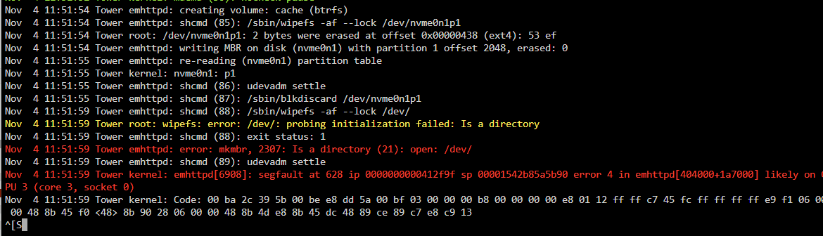

  5. Hi JorgeB Here are the diagnostics, right after the format attempt. Log entrys are the same again. Thank you for your help! tower-diagnostics-20241104-1349.zip

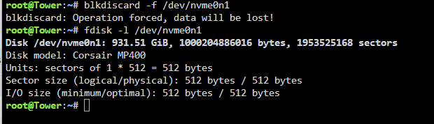

  6. Dear all I have an issue with formating my cache drive. I tried it with 2 differant NVME drives, but the error is with both the same: I use the 7.0.0 Beta4. After I started the formating process, unraid crahses somehow. The core load on the overview page freeze. Only a reboot helps to have the core load back. Any ideas what could help? Thanks a lot for the support! YB1898
