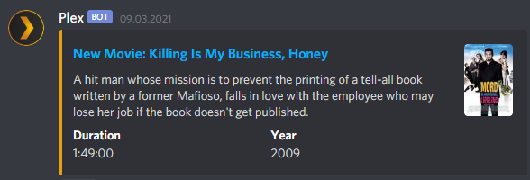

  5. Should be fixed now, update your container to the latest version. Is there anything displayed in your logs, if you add a new movie? Be aware that it takes a couple of seconds before plex sends a library.new event to the webhook. If plex does so, you should see something like "Inbound requests... Handling new movie announcement..." in your logs.

  10. @roadkill Plex sends constantly updates via the webhook, for example if you play/pause a movie. Make sure you add a new movie to plex. It must not be scanned by plex before, so removing one and adding it again does not work. If the movie appears in plex under "Recently Added" then plex will send a "library.new" event to PlexAnnouncer which then sends a Discord message (this may take a couple of seconds). Also note that currently only movies are supported (not tv shows or music tracks).

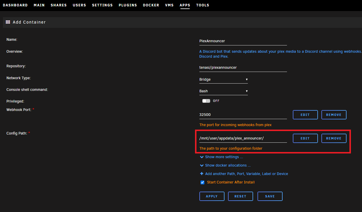

  11. @Goldoni: Your config looks alright so far. The problem seems that the container is not able to find the config file. Make sure to change the "Config Path" to something like "/mnt/user/appdata/plex_announcer/" and then, after creating the container edit the file generated e.g. with "nano /mnt/user/appdata/plex_announcer/config.json"
  12. Yes, it is supposed to stay running, after you modified the config file accordingly. The first time you run it, it will create a basic config file and then error out since of the missing discord webhook credentials. Is there anything being displayed in the logs? (Right click container / Logs) Also make sure that your DISCORD_WEBHOOK_ID looks like 819835938443493436 and your DISCORD_WEBHOOK_TOKEN should look like pMCEZmx8HG9qeLzpDukzHOCnbLjtXf4YSCpIMGaEt4M2YOu7LrcdMhNnFF9CWsaXF7kf.

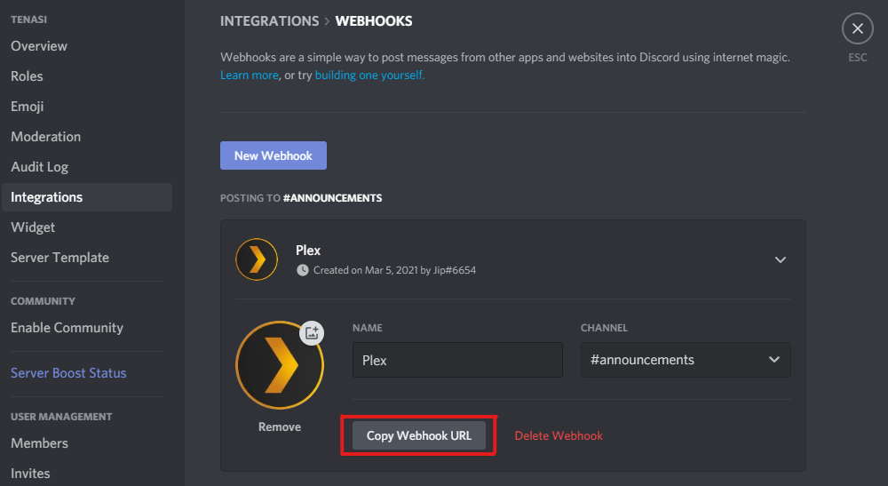

  13. Summary: Support Thread for Tenasi - PlexAnnouncer DockerHub: https://hub.docker.com/r/tenasi/plexannouncer Project: https://github.com/tenasi/plexannouncer Note: A Plex Pass is required to configure webhooks! What is PlexAnnouncer? PlexAnnouncer is a Discord bot that sends updates about newly added Plex media to a Discord channel of your choice using webhooks. Basically it proxies plex webhooks to discord. The bot itself is written in Python 3 and is using discord.py and aiohttp. Getting Started / Configuration 1. Create a Discord webhook and copy the webhook url. Goto Server Settings / Integration / Webhooks / Add Webhook. Setup a profile picture (e.g. this) and name and copy the Discord Webhook URL. 2. Install PlexAnnouncer from the Unraid CA store. Make sure that PlexAnnouncer is in the same Network as your Plex container. Paste the Discord Webhook URL and enter some random token for your Plex Webhook (can be any alphanumeric value). Last but not least you have to tell PlexAnnouncer your Plex server URL (so it can link to it). Your server URL should look like this: https://app.plex.tv/desktop#!/server/SERVERID You can copy it from your browsers address bar, if you click on any movie within your library. 3. Add a new webhook in Plex. Goto Plex / Settings / Webhooks / Add Webhook and enter the following url: http://IP:PORT/PLEX_WEBHOOK_TOKEN Replace IP with the address of your container or localhost in case you are running Plex and PlexAnnouncer on the same host. Replace PORT with your external port you mapped (default: 32500) and finally append your Plex Webhook token you specified earlier. Also make sure you have both Webhooks and Push Notifications enabled: Plex Server Settings / Network / Webhooks (Advanced View) Plex Server Settings / General / Push Notifications (Advanced View) 4. Whitelist libraries (Optional) If you wish to get updates only of specific libraries, add a new environment variable called UPDATED_LIBRARIES and specify the libraries (comma separated) you want to receive updates from. Note: If you configured PA based on the old guide, the config file is now deprecated, but still functional. However if you encounter any issues, try using env vars instead. About Us GitHub Profile: https://github.com/tenasi DockerHub Profile: https://hub.docker.com/u/tenasi If you like our work, please consider supporting it: https://paypal.me/tenasi
