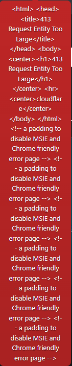

  2. Is there anything special to do to increase the file size allowed? I've tweaked the template adding in the following to my liking. GOKAPI_MAX_FILESIZE set to 51200 (removed yours and added my own) GOKAPI_MAX_MEMORY_UPLOAD set to 64 (thinking larger files may require more memory but doesn't seem to do anything) GOKAPI_LENGTH_ID set to 15 (removed yours and added my own, default per the documentation is 15) I've confirmed my settings were carried over to the config but upon adding a 780mb file it sits there for a few minutes then appears to be uploading due to a progress bar finally moving then shows an X over the file. When you hover over the file it shows the below error. The logs aren't very informative unfortunately so here I am. 😃 Any assistance would be greatly appreciated.
  3. During the initial configuration there's a setting for public URL and redirect URL. For the public put in https://yoursubdomain.domain.whatever and for the redirect put in https://yoursubdomain.domain.whatever/login. (Obviously replacing that with your correct info) That also corrects the issue with the WebUI link for the container. For Nginx there's no need for additional config, just make a simple proxy host with the domain, IP and port and you'll be set with the above corrected. I had the same issues until looking over the config and realized the redirect was there, even though it says it right in the initial config wizard. Hopefully that makes sense.
